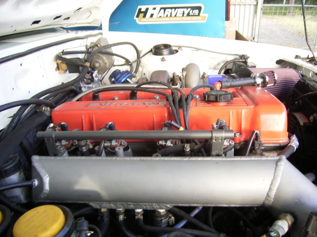

Gareth87 Posted December 20, 2009 Share Posted December 20, 2009 Hi everyone, Ive got a strange set of problems that i would like some opinions on so i will explain in as much detail as possible. My FJ20 was tuned over 2 years ago after it was built and it made 395HP at 17psi. A few weeks ago i took it back to the dyno to give it another power pull just to be sure everything was sweet. As i rocked up to the dyno, i put a new set of plugs in it just because it hadn't had plugs for 2 years. Anyway it made 394HP so everything was fine and i was satisfied. I took it to the drags 2 weeks ago and on the first pass it felt like what was a fuel surge just before the line so i shut off and rolled over. I was concerned that i had hurt the engine so i did 1 more pass short shifting a little earlier and still did the same MPH, this time without the fuel surge so i figured everything was ok. Paranoid, i took it back to the dyno to do another pull to make sure everything was all alright. The first run it only made 375HP followed by 370HP on the second pull. Boost was also coming on later by about 500rpm but holding 17psi when it came on. We figured something was wrong so did a comp test straight away on the dyno which came out with all cylinders between 185-190. Satisfied with that, Next we put a pressure tester on the front of the turbo and pressurised the system, the only thing that we could hear leaking was what was sounding like the inside of the external gate. Strange.. While the plugs were out, we inspected them which showed that 1,2,3 were fairly even, but 4 was very rich. (possible plenum design, see photo below) Anyway, so we cleaned them and got straight into the power pull. The first run, boost came on super late, by over 1000rpm and then went on to pull 395HP again, followed by a backup run at 391HP. I pulled the plugs again and number 4 was definately rich still, but the power was back. I have no idea why this has all happened and i know its a hell of a story, but if anyone has any ideas i would like to know. The only additional thing i can think of is that it was stalled backing onto the dyno and flooded, and took a while to get it started. Perhaps fouling a plug? but i dont know. So to recap. Boost on late - hissing noise in external gate. (turbosmart pro gate 48mm) Power down but picked up with clean plugs. 1 rich plug - wondering if plenum design isn't very good. Flooded before initial runs, could the plug have fouled causing lack of power? Best pics i have of plenum Thanks for the input, G Link to comment https://www.sau.com.au/forums/topic/300854-fj20-multiple-dyno-problems-wastegate-issues-to-down-on-power/ Share on other sites More sharing options...
R31Nismoid Posted December 20, 2009 Share Posted December 20, 2009 Having seen many many custom plenums - most of them (well, all) taper. Start large, end up smaller. Yours is just like a long tube. There will be a reason for it to taper im sure, big companies don't spend big bucks for nothing... what that is though, no idea! Link to comment https://www.sau.com.au/forums/topic/300854-fj20-multiple-dyno-problems-wastegate-issues-to-down-on-power/#findComment-4996371 Share on other sites More sharing options...
Guilt-Toy Posted December 20, 2009 Share Posted December 20, 2009 yes that plenum design is rubbish. its obvious cyl 4 is not getting as much air flow as the rest of the cyl. what ecu are you running? you are describing microtech to me =) btw, how do you keep the ass end together with all that power in a blue bird? Link to comment https://www.sau.com.au/forums/topic/300854-fj20-multiple-dyno-problems-wastegate-issues-to-down-on-power/#findComment-4996440 Share on other sites More sharing options...
Gareth87 Posted December 20, 2009 Author Share Posted December 20, 2009 The plenum design i felt worked a lot better when i was making a lot less power, i used to get fairly even plugs then, however, I'm 22 now and built that plenum myself when i was 16, I was learning just how a turbo system works then, so i couldnt even have guessed it would be making 400HP a few years later. The rear end is a 10 bolt series 3 TRX disc rear with a detroit locker centre and 4:11s. The trailing arms are welded and plated so touch wood, its not too bad so far. I run a Wolf ECU V4. So definately not the best thing in the world. Will running that cylinder so rich become a problem? i have been told a resistance check of the leads may show something up as well. G yes that plenum design is rubbish. its obvious cyl 4 is not getting as much air flow as the rest of the cyl.what ecu are you running? you are describing microtech to me =) btw, how do you keep the ass end together with all that power in a blue bird? Link to comment https://www.sau.com.au/forums/topic/300854-fj20-multiple-dyno-problems-wastegate-issues-to-down-on-power/#findComment-4996743 Share on other sites More sharing options...

Adriano Posted December 20, 2009 Share Posted December 20, 2009 (edited) I would have a look at the dizzy capa nd leads , maybe #4 is missing. I would have thought #4 cylinder would run lean with that plenum, with the pressure banking up at the back. Edited December 20, 2009 by Adriano Link to comment https://www.sau.com.au/forums/topic/300854-fj20-multiple-dyno-problems-wastegate-issues-to-down-on-power/#findComment-4996825 Share on other sites More sharing options...

Gareth87 Posted December 21, 2009 Author Share Posted December 21, 2009 (edited) hey guys, Thats not a bad idea with measureing the heat of the runners, have to go back to the dyno though. I might get the injectors checked as if #4 is a bit dodgy, then it may be leaking at idle or something. I thought the plenum would favour cyl 4 however, its curved around feeding the air in there. Also, with a turb like a 3040, it should have enough CFM of air flowing through that plenum to keep up with the cylinder. But im very open to the opinions here because it was only my guess. I also built myself a pressure tester today to pressurise the inlet system and i've definately got a leak in the gate somewhere. Air is pissing out from between where the valve shaft goes up into the head of the gate. That was only with about 12psi showing on the boost gauge. I'm guessing thats not normal hey?? would that cause a slow spool up? Im still stumped why it would run 25HP down for 3 runs until i cleaned the plugs and the HP came back... (thanks guilt-toy, ill flick some pics over!) G Edited December 21, 2009 by Gareth87 Link to comment https://www.sau.com.au/forums/topic/300854-fj20-multiple-dyno-problems-wastegate-issues-to-down-on-power/#findComment-4998077 Share on other sites More sharing options...
