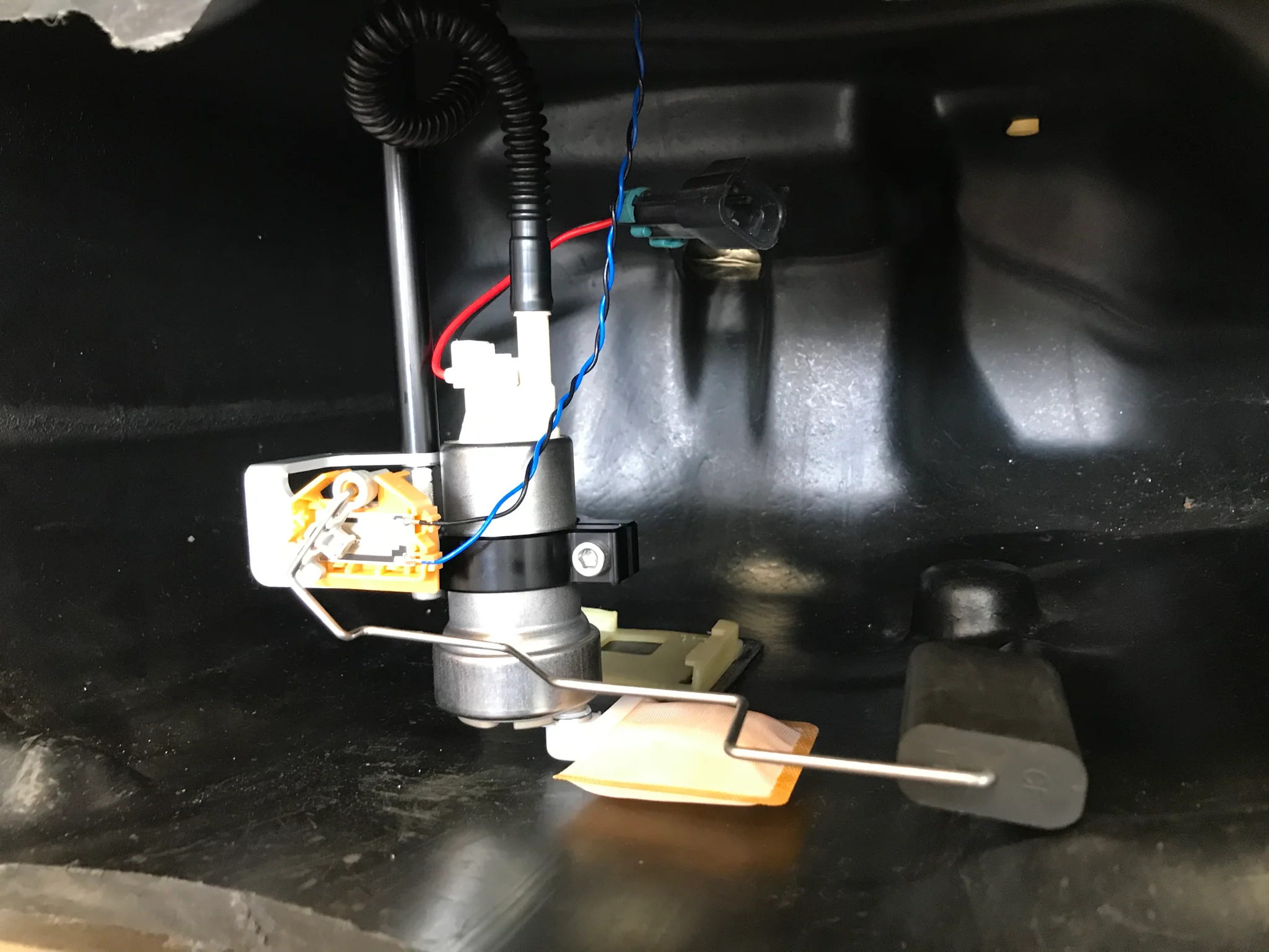

And yes, I meant the factory mount is a kind of baffle...it slides into (and sometimes easily out of) a plastic mount glued to the tank floor

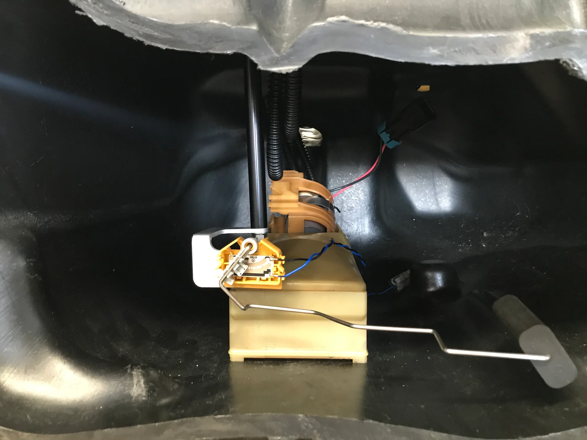

Right, I see what you mean now. Mounting the fuel pump bare in the bottom of the tank without its box does look quite questionable:
Compared to using the OEM box for the pump:
