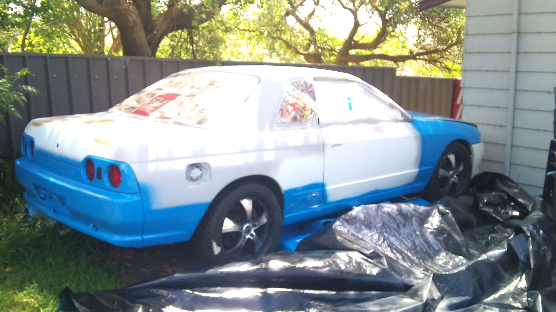

1992 R32 Gtst Skyline Drift Or Track Project
That looks good, but I think you're going to need much beefier side skirts now.
