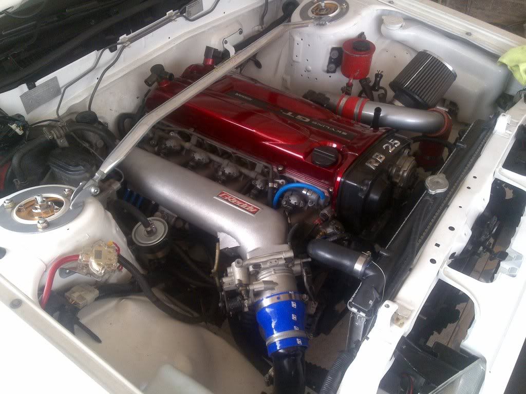

Hey guys. Got 2 R31's this is my track car build. Long story short

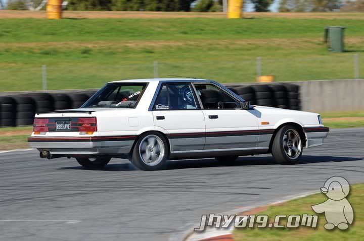

Built a R31 which the family has had since it was 6 months old with a 25DET in it, people said i was nuts to trash it on the track cos its neat, so i got it engineered instead also has JIC coilovers all round. Now runs with 18" work meshies on

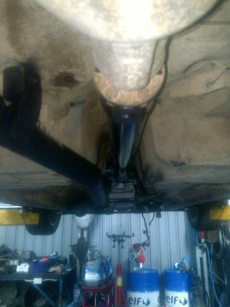

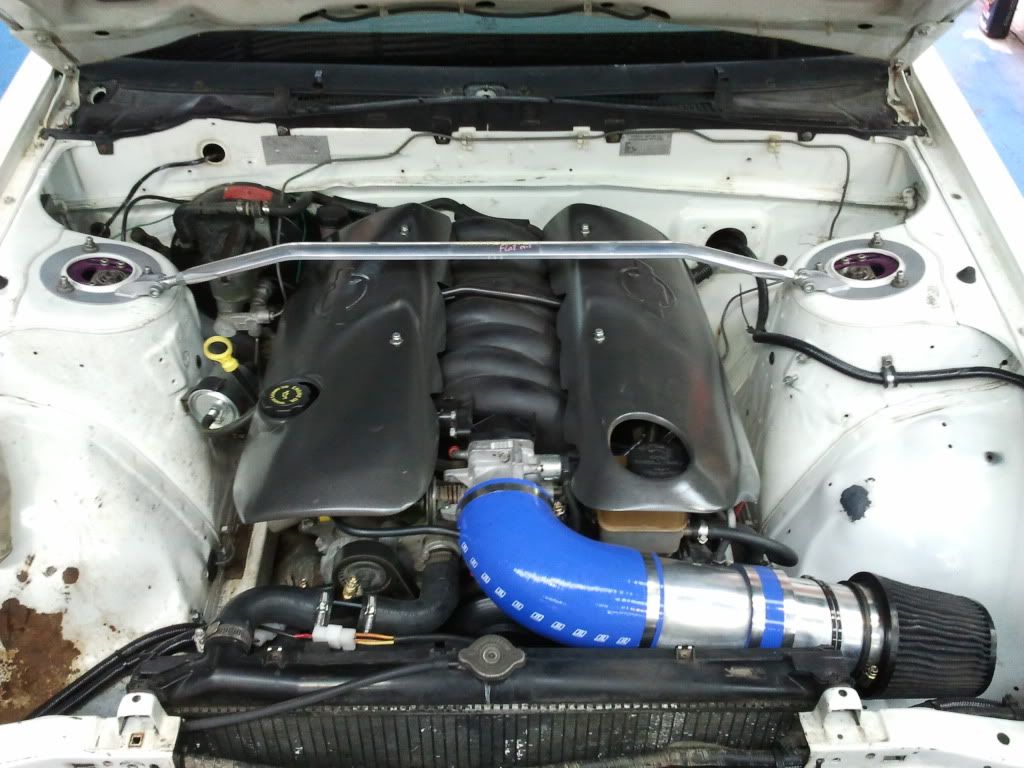

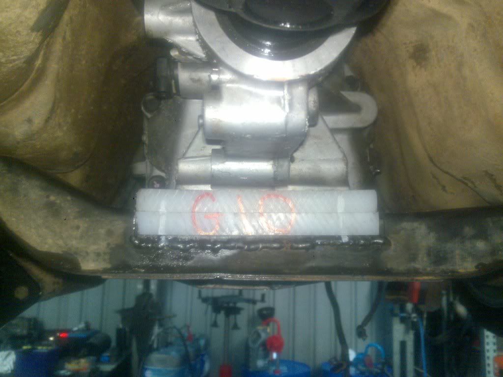

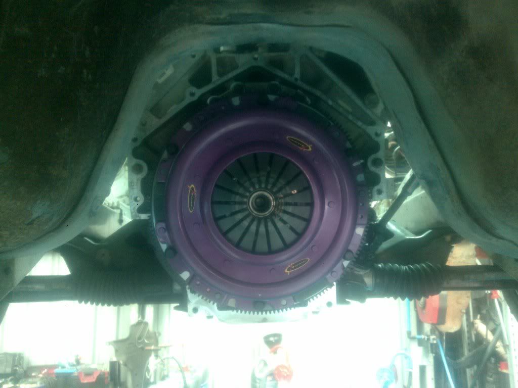

So then i wanted something different instead of a 25 or 26 so went LS1. Nothing to hard, got the car in October finished it in december lol. Did the engine mounts n gearbox xmember myself fitted all the gear to basically get it there, suspension n brakes. Wanted to get it done for a jaustech private day on december 23rd. unfortunately it didnt make it due to a faulkty relay but we didnt pick it up. Anthony from jaustech had it wired n running in a day lol. So yeh, this is my 2 month build

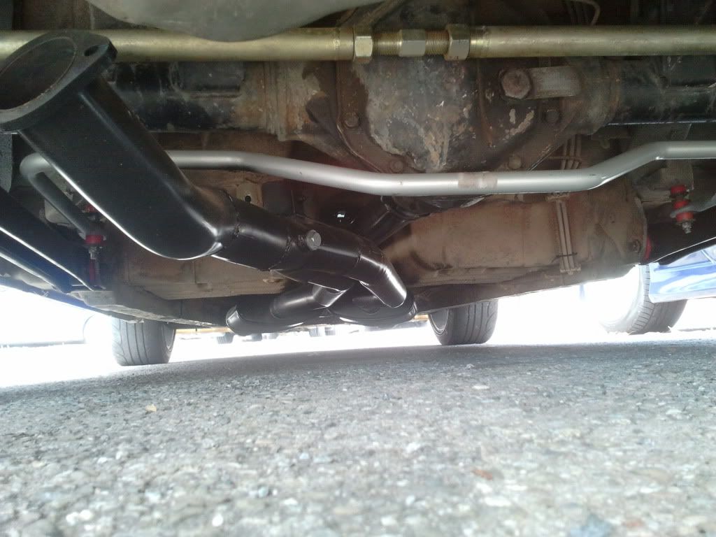

Made 245atw on a mainline. Mafless tune n edit, full with 2 3/4 exhaust with a canon on the back lol
