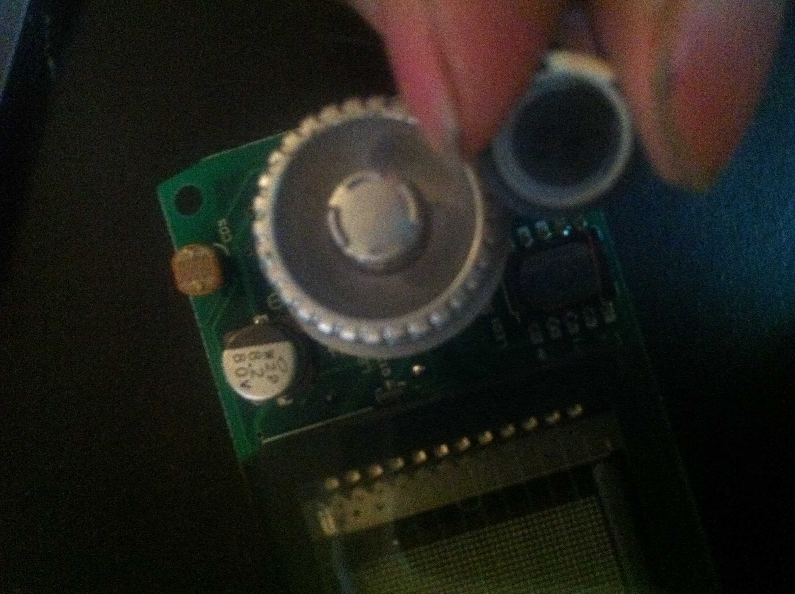

yeh just tried to turn it on but the safc doesnt even start , pulled the thing (safc) apart and found out one of the soleniods or the small circle thing is sorta snapped off inside so the safc is pretty much useless , and so is the thread lol , freakin pissed but
https://www.sau.com.au/forums/topic/385797-safc-2-problem/#findComment-6153885
i dont know but i unplugged the safc 2 from the extended harness and drove down the road and went on limpo mode, found out the airflow wire was doing it so i connected the safc 2 again to avoid the car on limp mode but the safc itself isnt even turned on, the photo i attached shows the circle thing im holding has come off the circuit card , what should i do? i was thinking of getting another safc 2 or can an safc 1 with a harness clip fit to an safc 2 extended harness clip which is already wired in?
