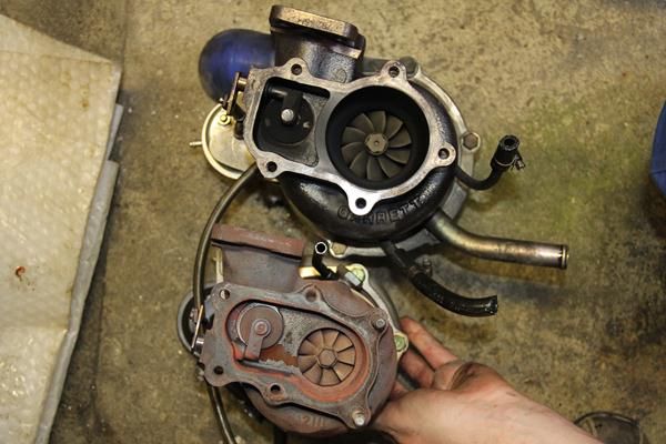

hey guys i was really interested to know if anyone can double check for me if turbos from auto r33 gtst's are/look different to manua r33l gtst's?
i bought one and it looks like this.
now can someone tell me if this is an r32 gtst turbo or possibly an "auto r33 gtst" turbo.
i have heard this in a couple of cases where the auto r33 turbos look different to manuals but looks similar to r32 turbos but with bigger compressors or something along those lines? do series 1 or 2 matter also?
can anyone confirm?

the turbocharger on the auto and manual GTST (of the same model) is identical
ie nissan did not make different turbocharger models for auto and manual
they did, however, use a different actuator spring on the auto turbocharger
this is because the AUTO gtst runs less boost than manual from factory
from paulr33.com
ECR33 manual is 385mmhg which is 7.4446 psi
ECR33 auto is 270mmhg which is 5.220 psi
ah fair enough thanks for that paul. so this is no doubt a r32 gtst turbo?

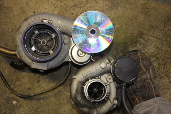

here are some pics of the rear housing. bigger compressor then normal?
sorry about the crappy pics lol.
