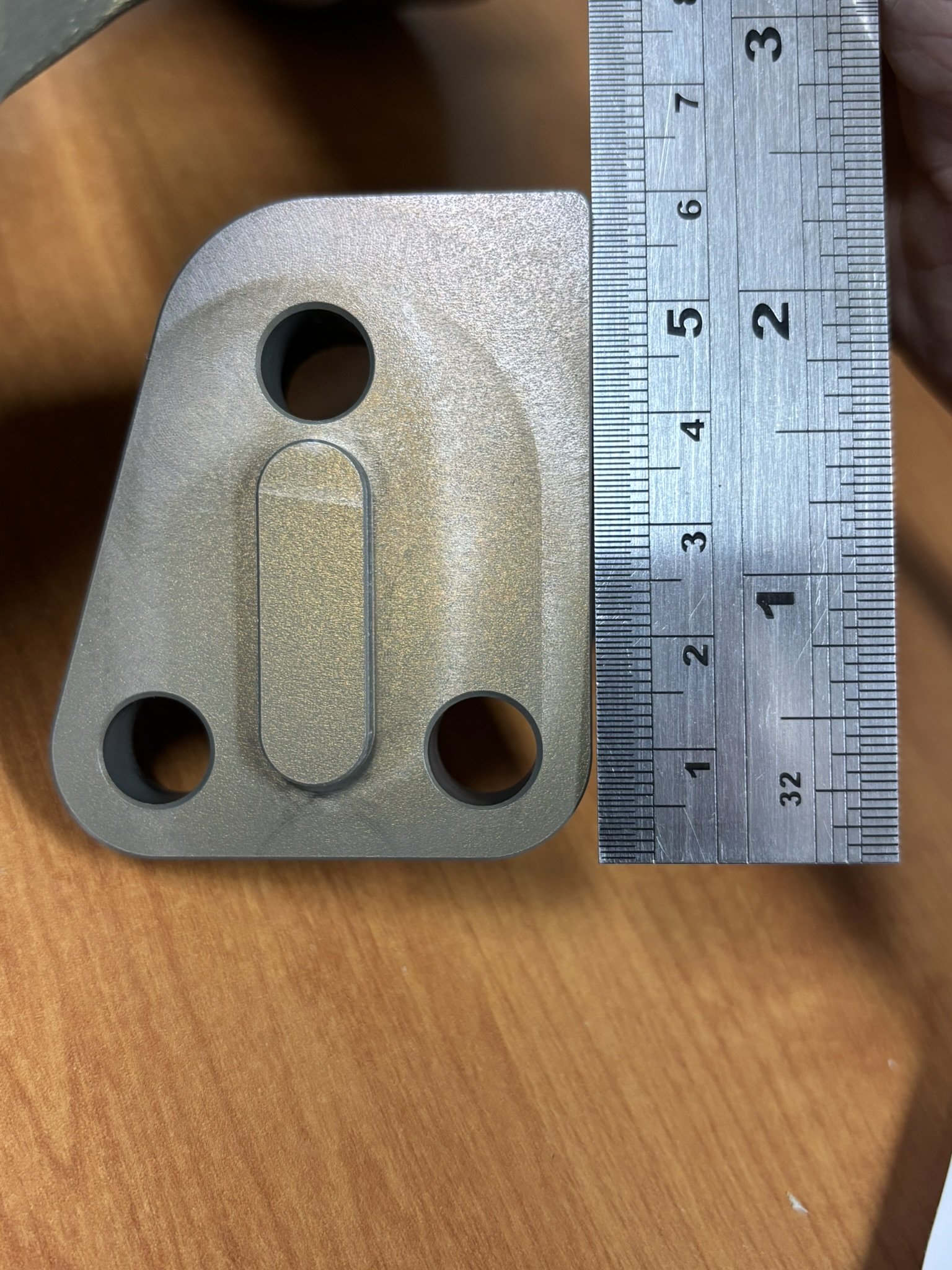

There's plenty of OEM steering arms that are bolted on. Not in the same fashion/orientation as that one, to be sure, but still. Examples of what I'm thinking of would use holes like the ones that have the downward facing studs on the GTR uprights (down the bottom end, under the driveshaft opening, near the lower balljoint) and bolt a steering arm on using only 2 bolts that would be somewhat similarly in shear as these you're complainig about. I reckon old Holdens did that, and I've never seen a broken one of those.
Let's be honest, most of the people designing parts like the above, aren't engineers. Sometimes they come from disciplines that gives them more qualitative feel for design than quantitive, however, plenty of them have just picked up a license to Fusion and started making things. And that's the honest part about the majority of these guys making parts like that, they don't have huge R&D teams and heaps of time or experience working out the numbers on it. Shit, most smaller teams that do have real engineers still roll with "yeah, it should be okay, and does the job, let's make them and just see"... The smaller guys like KiwiCNC, aren't the likes of Bosch etc with proper engineering procedures, and oversights, and sign off. As such, it's why they can produce a product to market a lot quicker, but it always comes back to, question it all. I'm still not a fan of that bolt on piece. Why not just machine it all in one go? With the right design it's possible. The only reason I can see is if they want different heights/length for the tie rod to bolt to. And if they have the cncs themselves,they can easily offer that exact feature, and just machine it all in one go.

Hmm. Perhaps not the same engineers. The OE Nissan engineers did not forsee a future with spacers pushing the tie rod force application further away from the steering arm and creating that torque. The failures are happening since the advent of those things, and some 30 years after they designed the uprights. So latent casting deficiencies, 30+ yrs of wear and tear, + unexpected usage could quite easily = unforeseen failure. Meanwhile, the engineers who are designing the billet CNC or fabricated uprights are also designing, for the same parts makers, the correction tie rod ends. And they are designing and building these with motorsport (or, at the very least, the meth addled antics of drifters) in mind. So I would hope (in fact, I would expect) that their design work included the offset of that steering force. Doesn't mean that it is not totally valid to ask the question of them, before committing $$.
