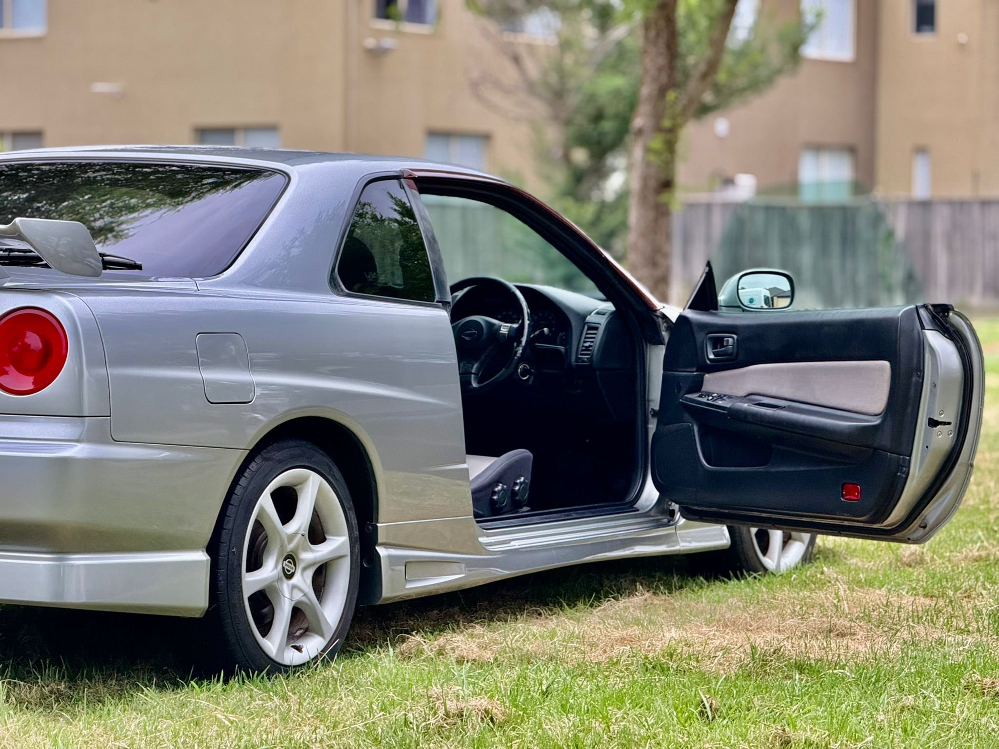

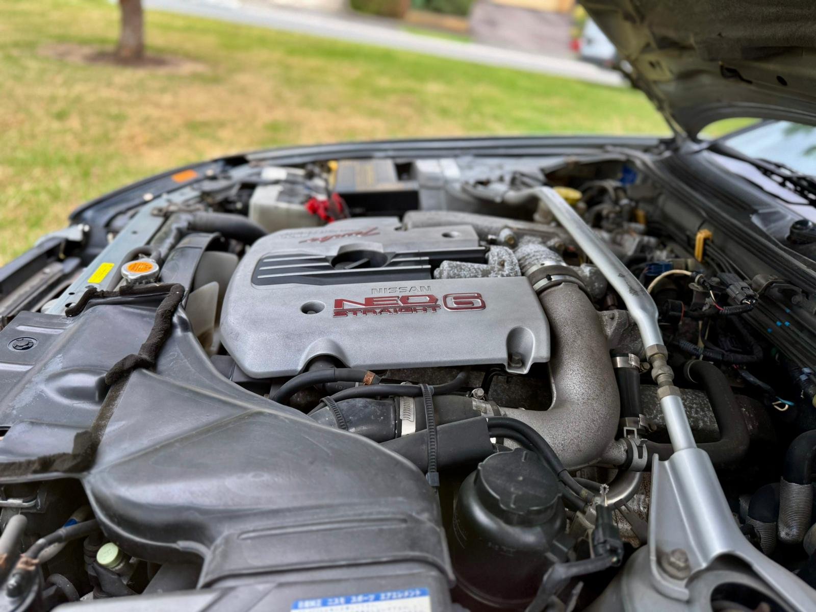

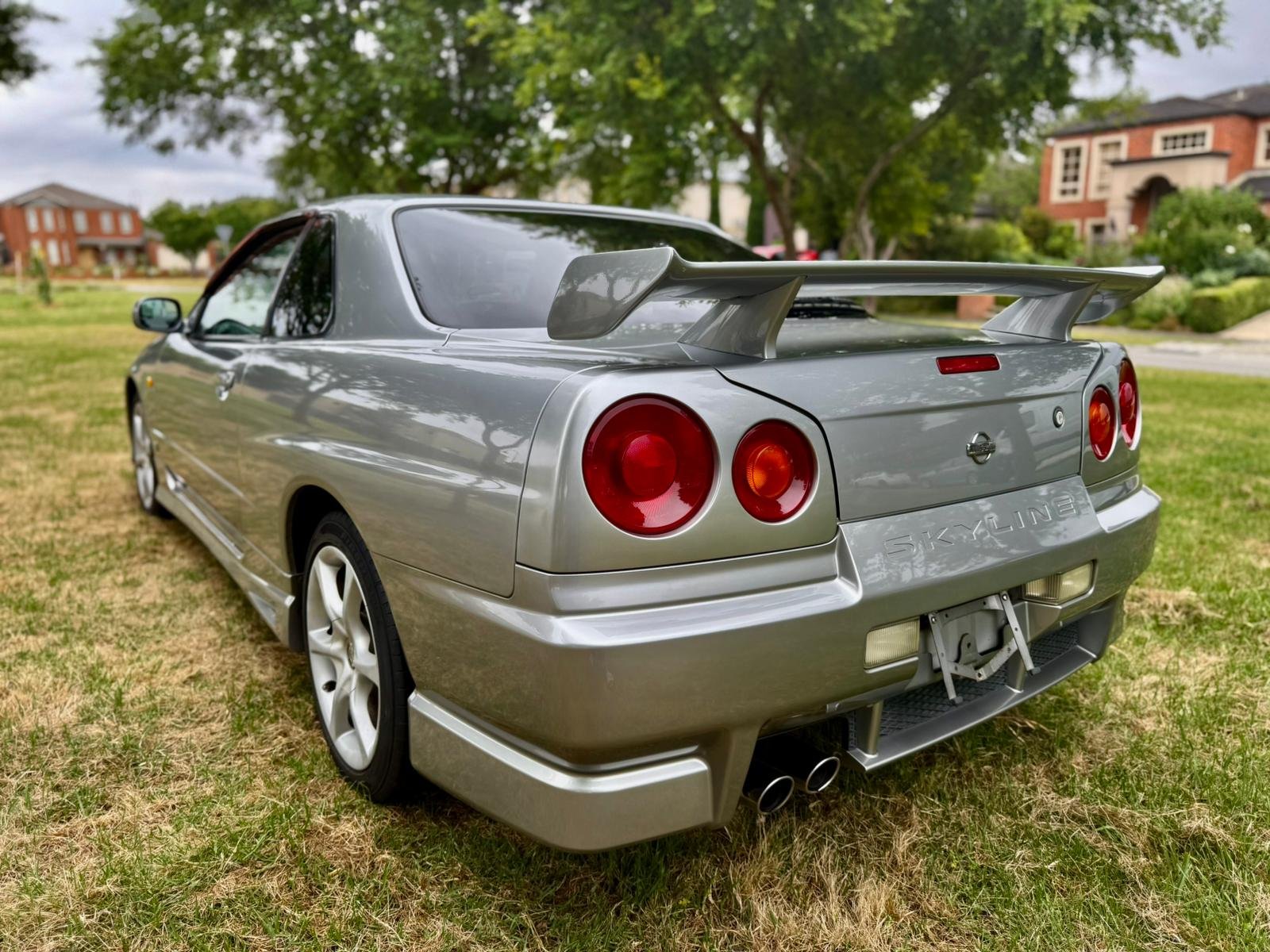

Picked up my 1999 Skyline R34 GTT as a semi- fresh import. Compliance but not yet registered early May. The previous owner bought it for his son, but as he was on his P's he wasn't able to drive and I was able to pick it up in mint condition.
The owner in Japan maintained this really well and books show full detailed service history and receipts attached.

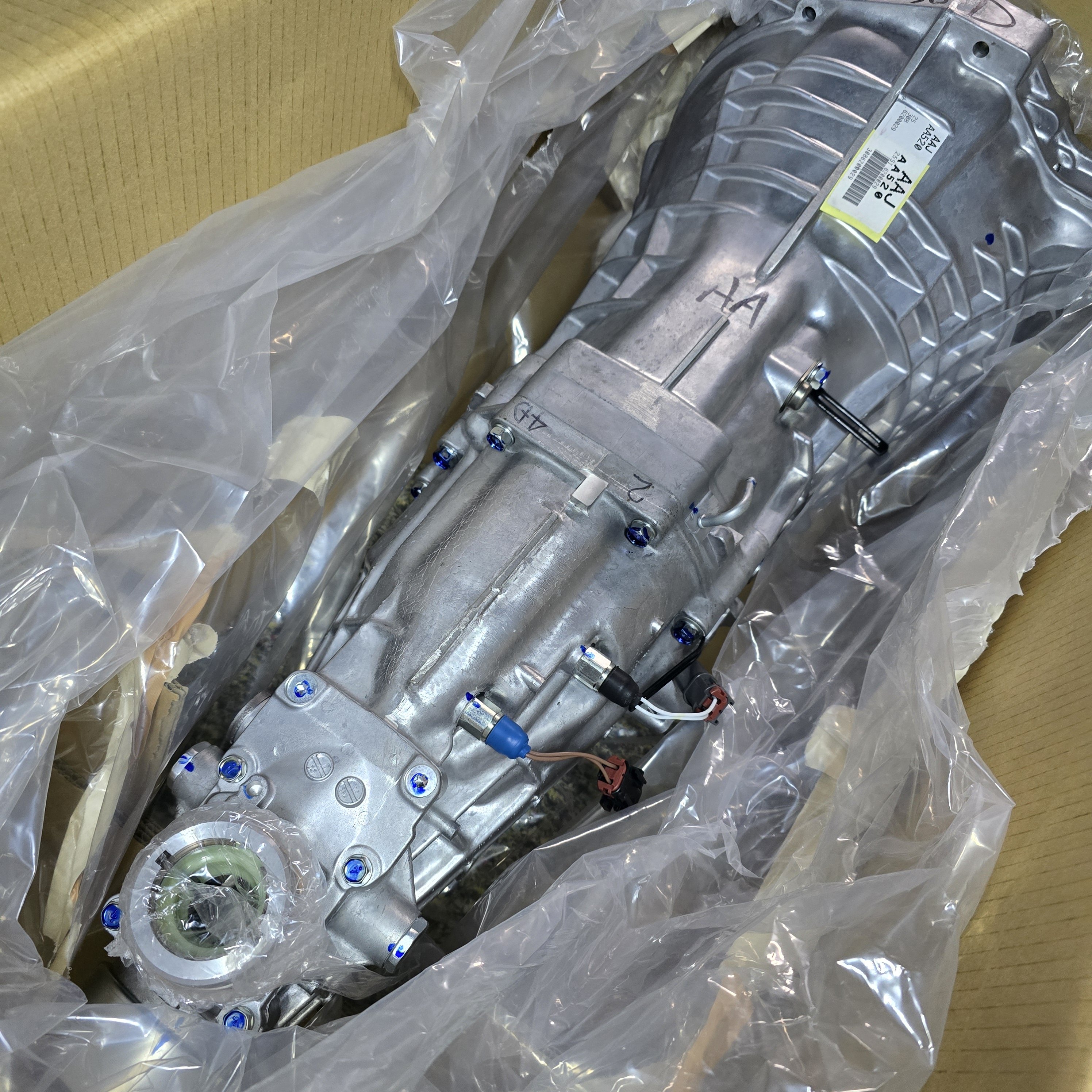

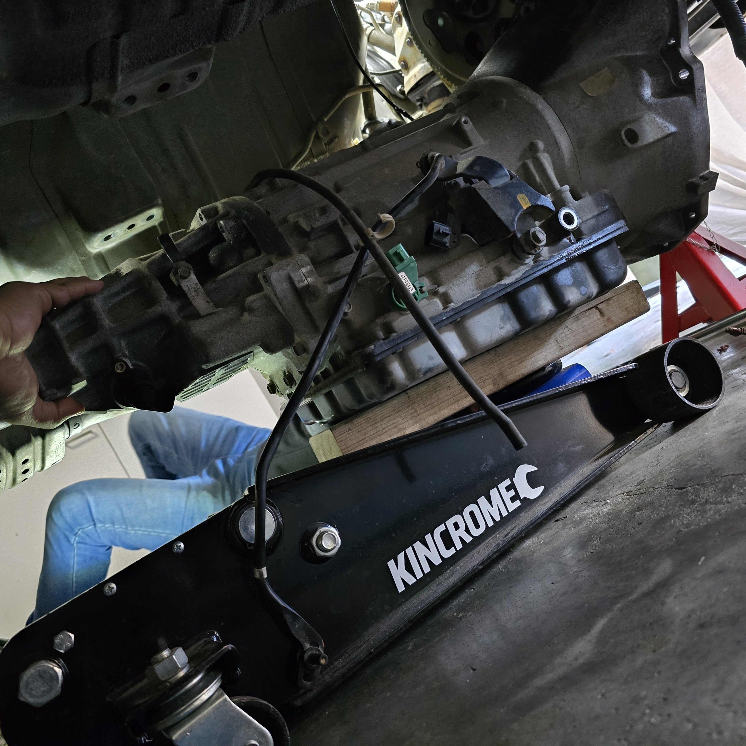

Being a manual, we very quickly ordered new R34 gearbox (From Nissan) and remaining parts from Kudos motorsports. Would highly recommend the team there. Ultra helpful and quick to share advice and upgrades.

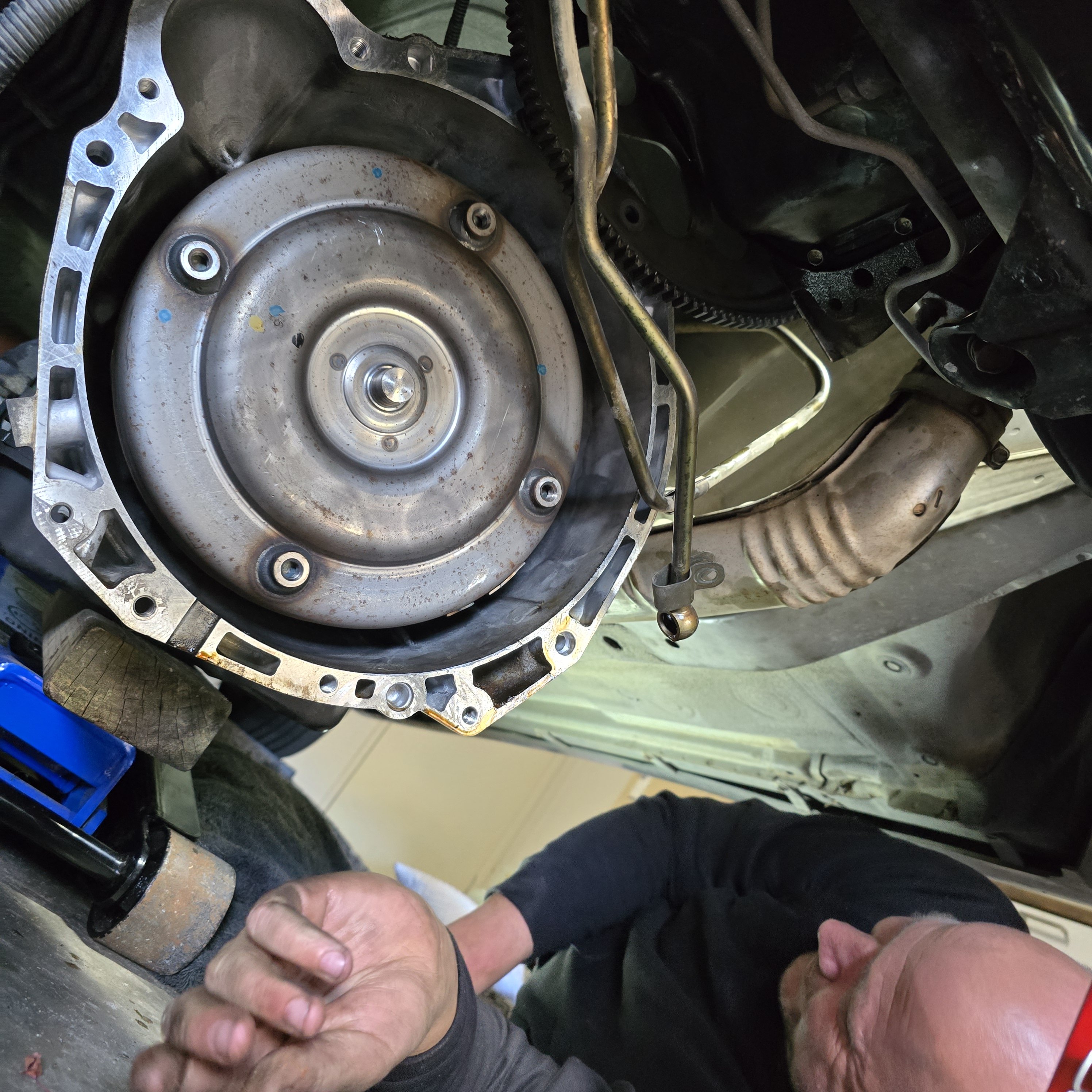

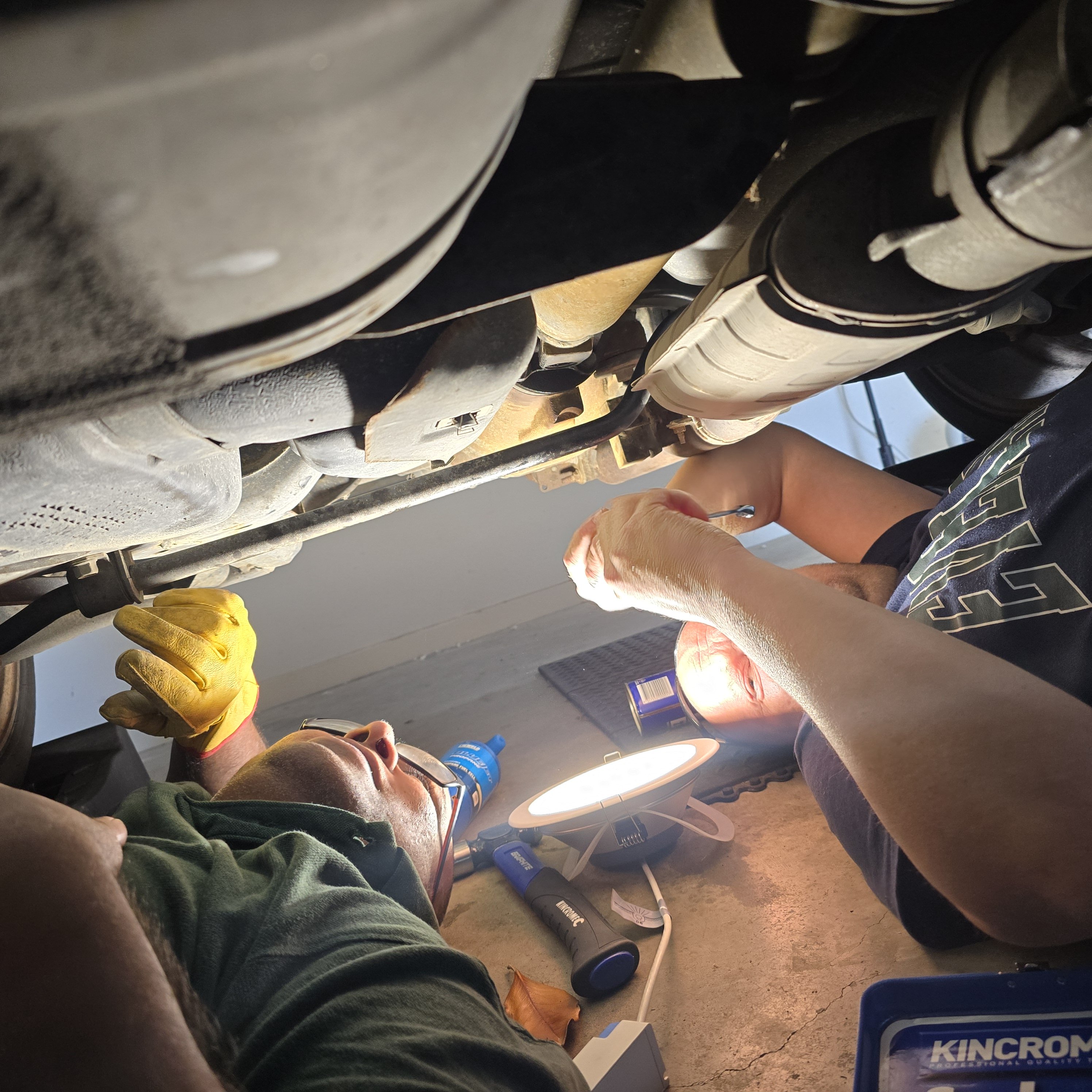

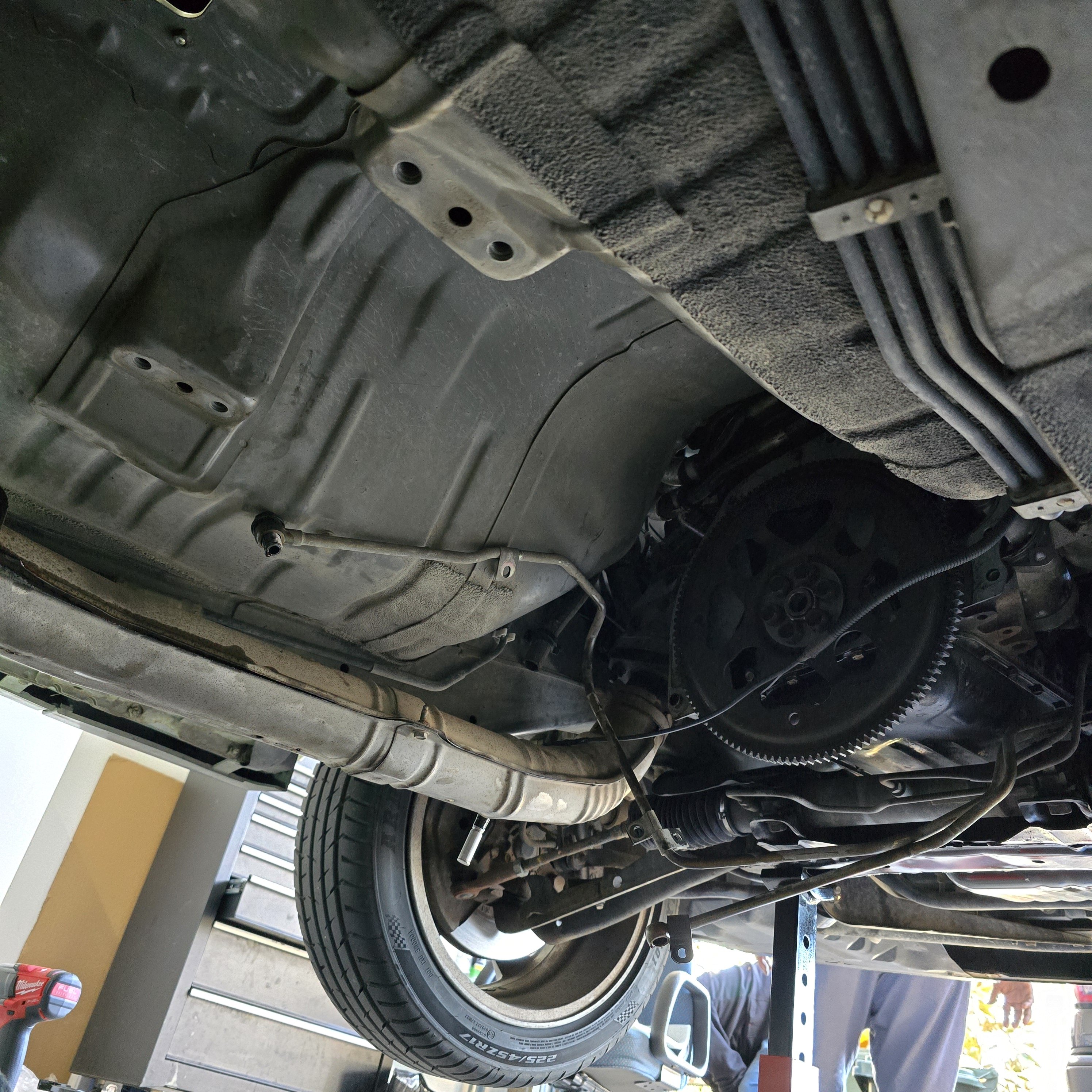

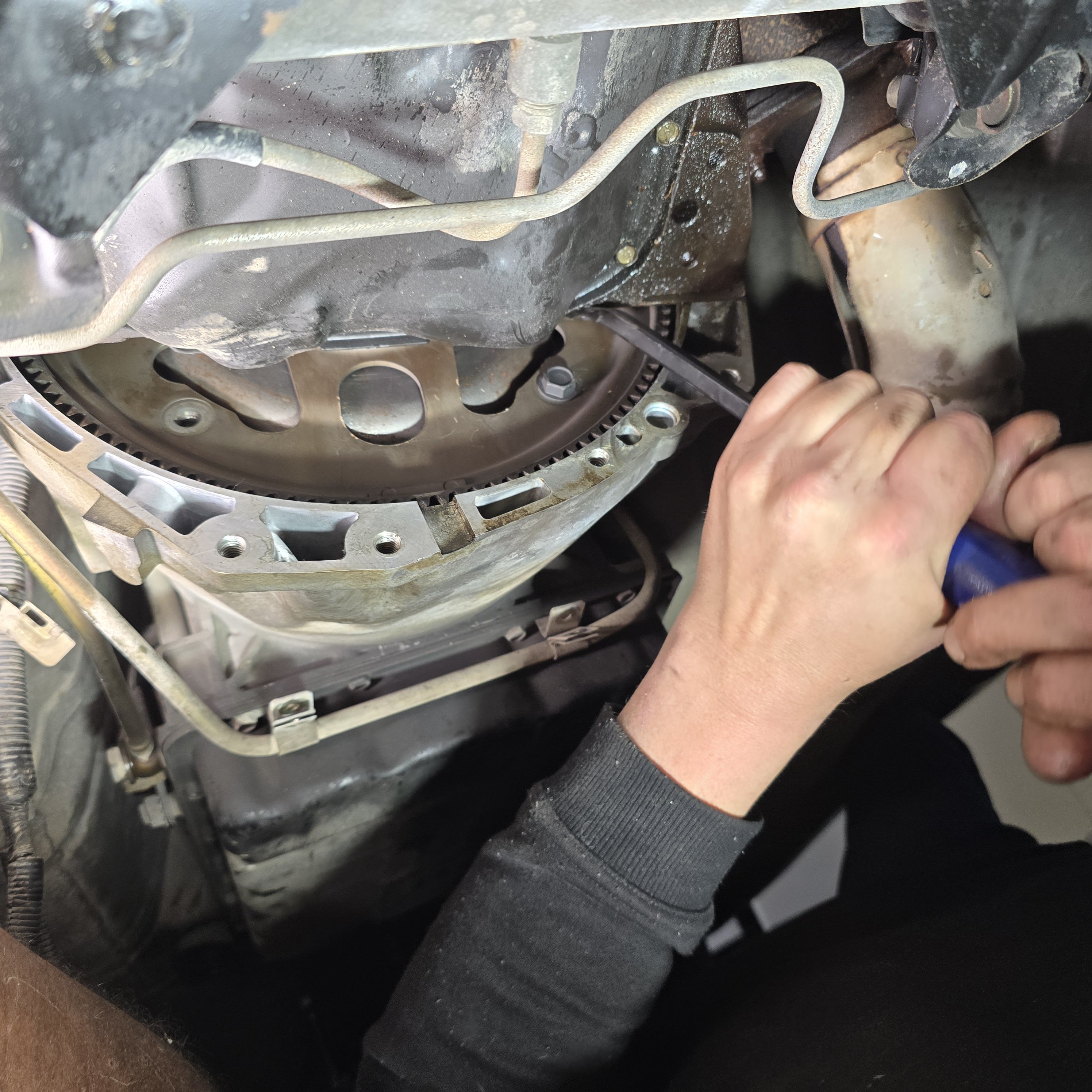

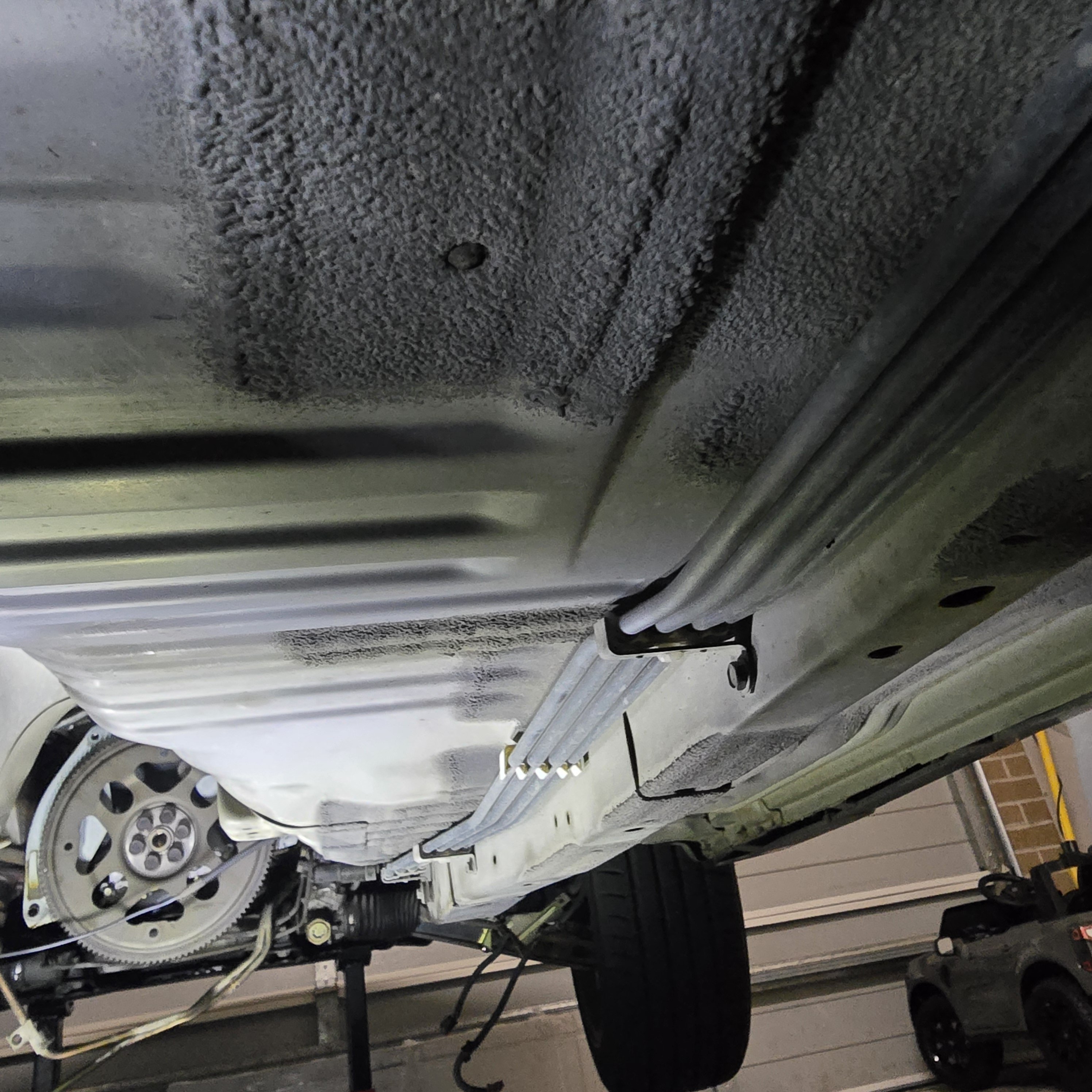

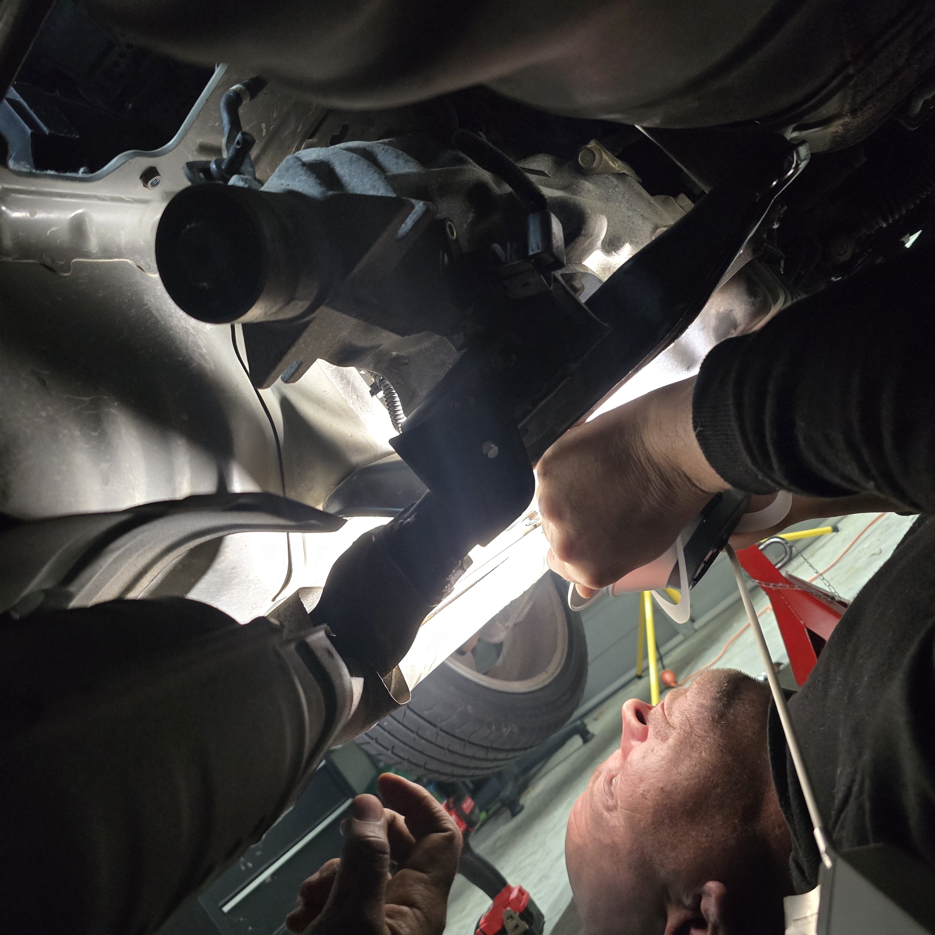

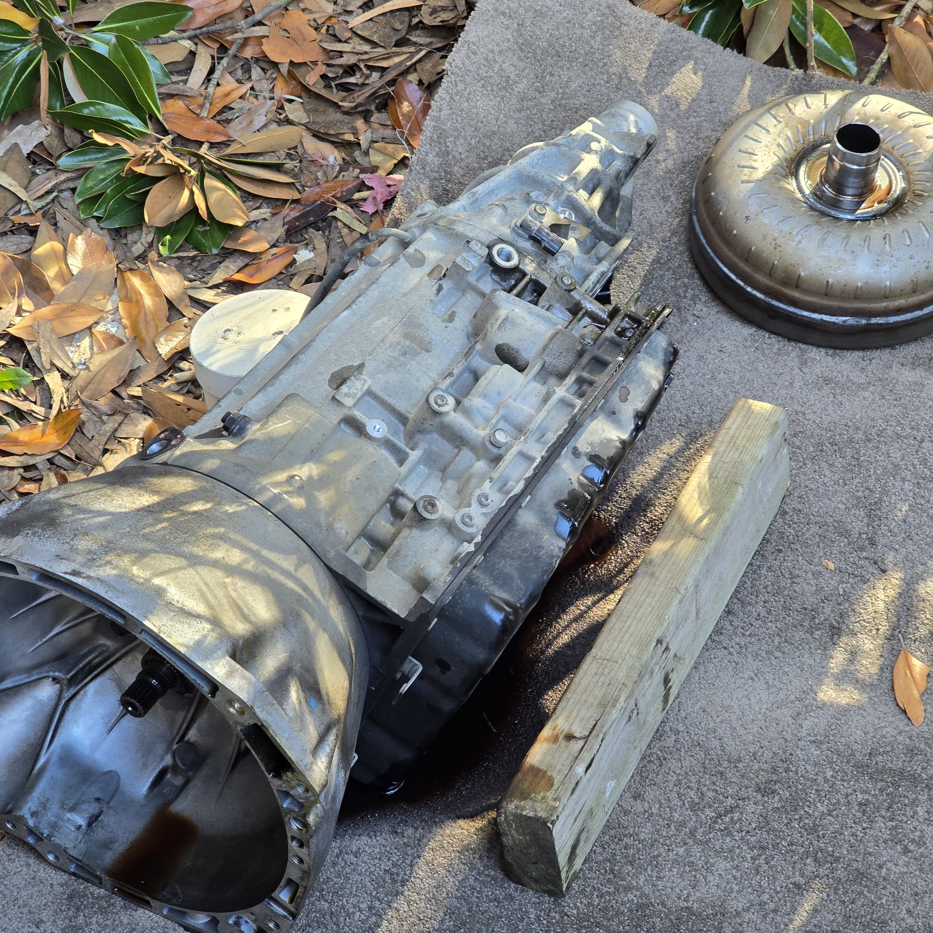

We are in the middle of taking the Auto out (Genuine 94,000/kms) and putting the Manual in this weekend.

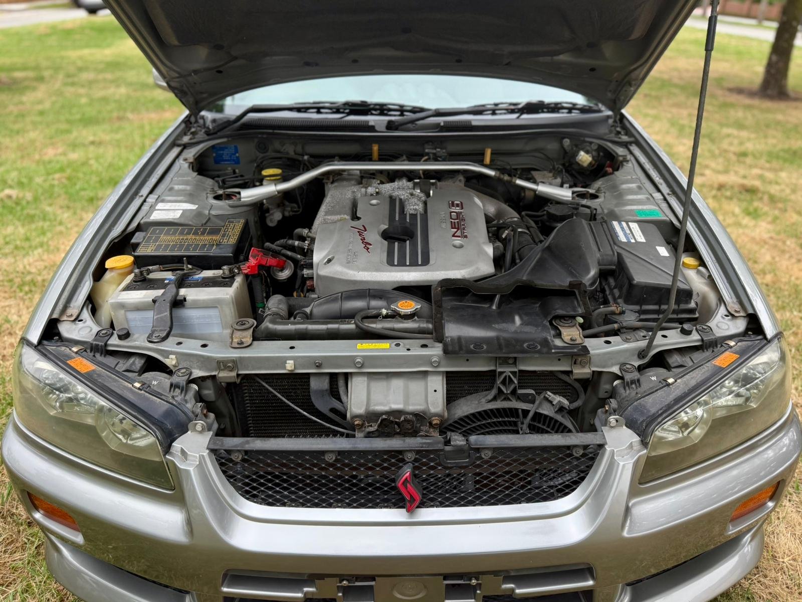

Part 2 of the build will include likely a Plazaman Intercooler and Plenium, Hks Exhaust with Tomei Dump (ordered).

    • The smart approach is to use the gearbox loom from the manual car. Makes it a lot easier - just plugs into the switches on the box and plugs into the main loom up near the fusebox. Then you only need to deal with bypassing the inhibit switch. The other approach requires you to use the wiring diagram to identify those wires by colour and location, perhaps even indulging in a little multimeter action to trace them end to end to make sure, and then.... you will have the answers you need. The R34 wiring diagram is available on-line (no, I do not have a link to it myself - I would have to do a search if I wasn't able to go to the copy I have at home).
    • Hi, i’m converted my r34 4dr auto to manual but need help with gearbox wiring. There are bunch of wires no idea which one for speedo drive, neutral, reverse can anyone help me. IMG_6860.mov
