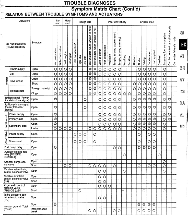

I attached the image of the only thing I found, nothing to do with ohms in the manual only torque values etc. However, being they are so close to each other I am almost certain they are good. Tomorrow I will test the spark plugs while I am there. and look at the ECU connections.
