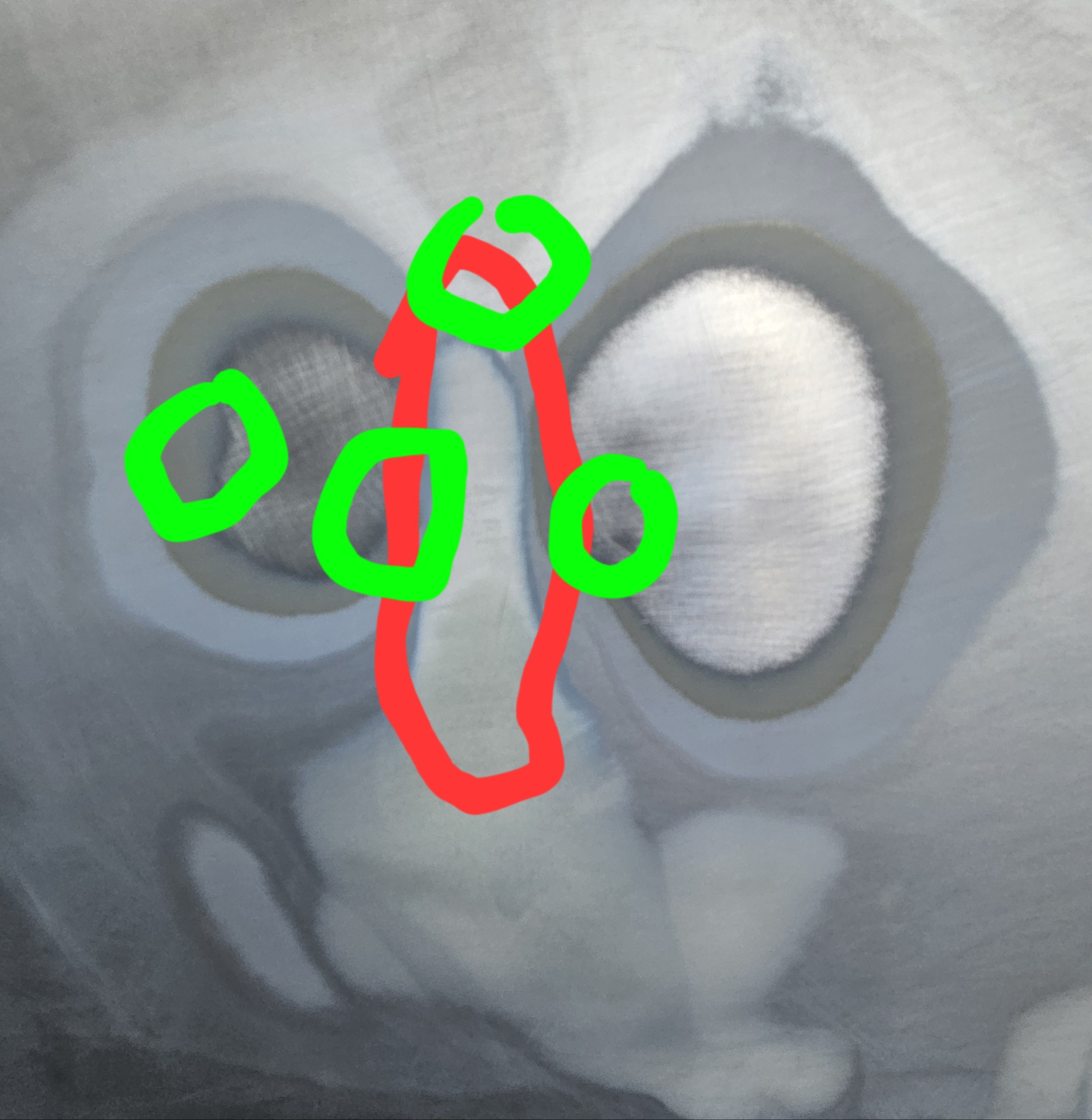

Posted (edited)
I'm having a problem. I think it was mentioned above somewhere but can't see it.
I'm stuck in the cycle of, sand, filler, low spot again, put filler, sand, low spot again, now i put filler again and a thicker portion which seems to have helped but I got low spots in other areas.
In the image. Circled in red thats where the original low spot was and the shape is the same as the red out line. I've more or less fixed that (still low spot up the top but now I have low spots where the green circled part is.
Is likely the issue that I didn't start with a course sand paper? I sanded the filler with 240 to reduce the risk of not going to far but maybe the issue is that I'm only taking off enough material to remove some of the filler but not the high spots.
I now started sanding with 120 and I think I'm seeing a difference. I did fix one dent the other 2 are f**ked and seems like I made another low spot which is indicated by the furthest green circle on the left handside.
Any thoughts and solutions?

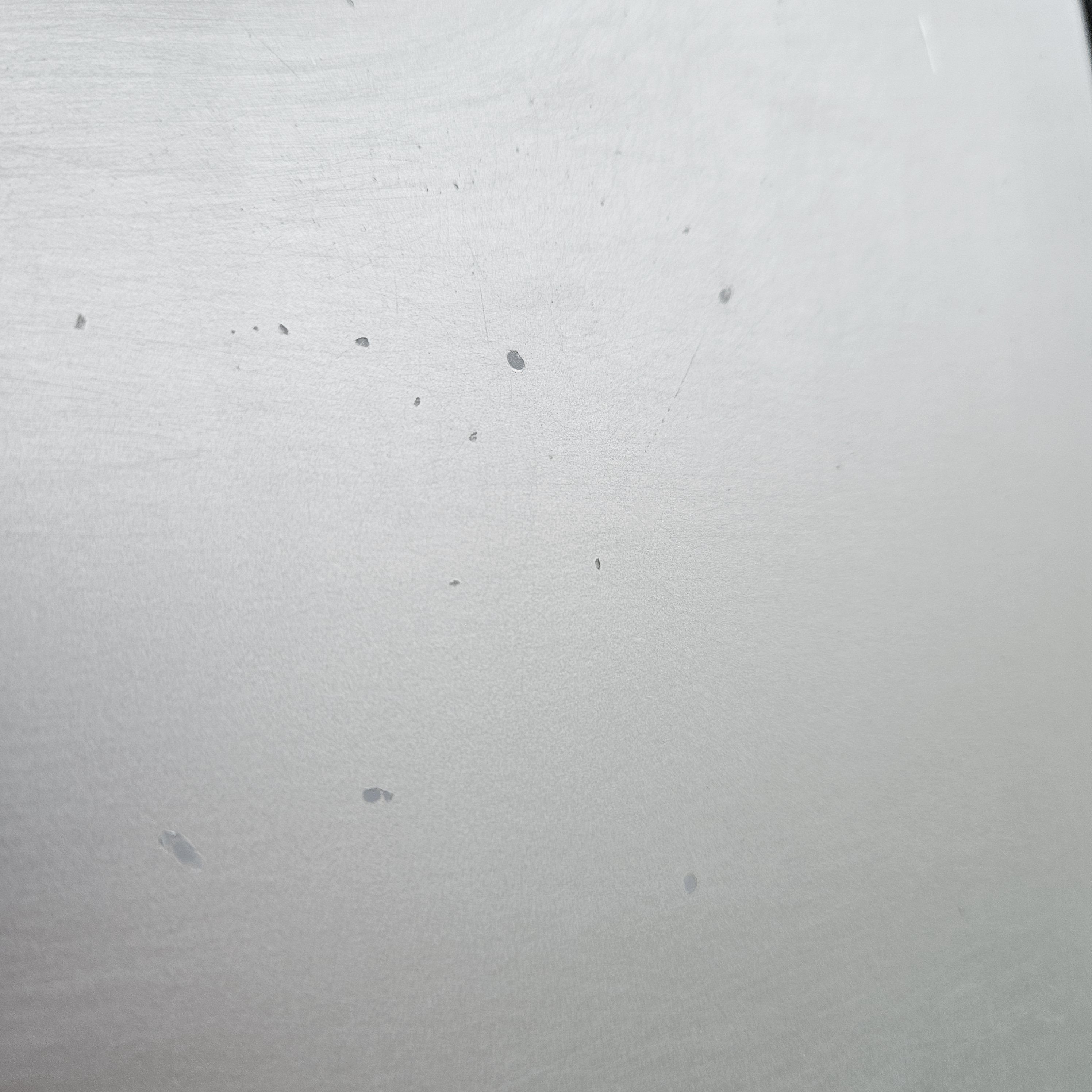

Also second image. All of these rock chips, can they be filled in with primer or do i need to fill them all with filler/putty? So many rock chips on mine lol.
Say you've just laid all your filler and your about to start sanding, how large is the sanding block your using?
Like a high fill primer? Technically possible but would be a nightmare. Just guessing from the photo, but they look small enough that you might get away with using a 1k spot putty. Normally you'd use something like this on pinholes but with the type of project you're working on I'd give it a go.
Just a standard sanding block size. With the rock chipa they are quite small. I sanded them as you could feel the edges.
Are they sanded completely flat?

11 hours ago, Murray_Calavera said:
Mine's a bit bigger at 70x150mm roughly.
The spots are flat, just can feel the edges if I dig my nail into it. I did fix some other other ones by both using my finger to sand that small spot (I'm a bit wary of doing this and creating hot spots and a bigger mess) and I also did sand over it flat and others, but this also worried me a bit because if I create an overall low spot on the panel on paint that is good.
Correct me if I'm wrong but as long as it's flat even if I can feel the edges, I can put filler because it will all be level once I sand it?
I can see myself going in a circle after sanding guidecoat with 320 grit if for example the panel is flat with my hand but because I sanded the guidecoat I could have created a low spot again somewhere. Unless where I'm going wrong is what I mentioned previously where I didn't go low enough on the grits.
It's 1 step forward and 2 step backwards here haha. I'll probably need to experiment with it more. Last time I go back to bare metal lol.
Yep I guessed as much. You'll find life much easier with a large block something like this -
https://wholesalepaint.com.au/products/dura-block-long-hook-loop-sanding-block-100-eva-rubber-af4437
This is a good demo video of something like this in use -
You have turned your small rock chip holes into large low spots. You'll need to fill and block these low spots.
It's always a little hard not seeing it in person, but yes I would go ahead and lay filler over the whole area.
Have a good look at the video I linked, it's a very good example of all the things you're doing. They went to bare metal, they are using guide coat, they are doing a skim coat with the filler and blocking it back. If what you're doing doesn't look like what they are doing, that's a big hint for you :)

Oh I probably didn't speak enough about the small sanding block for blocking large areas.
In the video about 3 minutes in, he talks about creating valleys in the panel. This is the issue with using a small sanding block for a large area, it's way too easy to create the valleys he is talking about. With a large block its much easier to create a nice flat surface.
Hard to explain but in practice you'll notice the difference straight away using the large block.
  • Like 1
To expand on this to help understanding...
The bigger/longer the block is, the more it's going to work to sit on your far away high areas, and not touch the low stuff in the middle.
When you throw the guide coat, and give it a quick go with a big block, guide coat will disappear in the high spots. If those high spots are in the correct position where the panel should be, stop sanding, and fill the low spots.
However, using a small block, you "fall off" one of the high spots, and now your sanding the "side of the hill".
Your little block would have been great for the stone chips, where you only use a very small amount of filler, so you're sanding and area let's say the size of a 5/10cent piece, with something that is 75*150.
For the big panel, go bigger!

PS, I thought your picture with coloured circles was an ultra sound... That's after my brain thought you were trying to make a dick and balls drawing...

With stone chips, you really can't just try to fill them. You really have to sand that spot to lower the edges of the chip, so that the filler will end up covering a wider patch than just the chip. Otherwise, you're trying to have a sharp edged paint surface match up to some filler, and they just do not sand the same and you always end up with a noticable transition.
A bunch of adjacent chips should be well sanded back, to round off all those edges, and use a lot (in a relative sense) of filler to raise the whole area back.

Thanks for all that info.
I thought I heard that the size of the block should be the same size as the repair or is that wrong? Though I do have some long blocks which I can use for the dents in the middle of the panel. The issue is with the ones at the edge of the door and near the grooves.

This is probably what's happened to me. I'll put filler again on my repairs and use the long block and let you know how I go. Fingers crossed it's my last batch of filler lol. I can see that happening where my block dipped at certain points because it didn't cover all the high spots at the same time if that makes sense.
I'm just trying to visualise the fact that with the large sanding block I will be sanding far away from the central dent area and whether that will cause issues or whether that's going to fether out my repairs better.

This makes a lot of sense! I just had that realisation a few minutes ago and wrote it above haha. This is a good new discovery. "Sanding the side of the hill" perfect way to put it.
