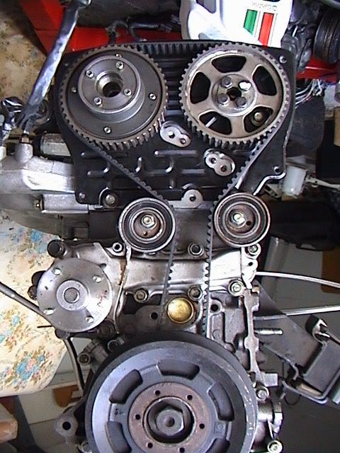

The most important part of the rb30 block for our twin cam conversions I think is the lack of a machined surface to mount the tensioner on.
Looking at the front of the block you will see two drilled and tapped holes where the tenioner studs screw in to.
Both must have a flat machined surface. I believe its the series 1 blocks that don't have the right tensioner location machined flat.

This is a genuine turbo block that was removed from an 1988 Holden Commodore BT-1. If it isn't the original engine from the vehicle I would be very suprised. Pictures are worth a thousand words so here's my essay :P
As you can see one stud needs to be drilled out in the second image.
Bigsully84,
That block is perfect.. As you can see the right stud hole has a flat machined area.
The blokes that don't have this simply have a hole with no flat machined area.

if you don't have the flat machined surface there you will have to do this:
which is really not a big deal at all, considering you've either bought the drill bit and tap yourself already, or you're getting a machine shop to do it. the main things to get on the block are the provisions for the oil and water lines, which are a bastard to tap yourself.

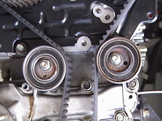

The origional right tensioner has just a hole with no flat surface around it. The origional tensioner locations are to the left/right of the welsh plug.
everyone with an RB25 or 26..... have you seen how close the standard tensioner and idler pulley come on the twin cam RB's? it's pretty much exactly what you'd get if you used the two pre-drilled tensioner locations on the RB30 block, on either side of the welsh plug there.
as far as being worried about the belt touching because it's too close together, that is pretty much a non-existent danger. if it's not enough that the OEM engine uses a timing belt setup which comes that close together without problems, consider how much the slack side of the belt (inlet cam side of the belt) would have to flop to touch the reciprocal side of the belt moving the opposite direction. a properly tensioned cam belt simply cannot move that much, even under extreme loads (giant cams on rapid RPM changes).
if i had a series 2 block to start with, i would have used the two lower tensioner locations for simplicity and cost reasons. as it was i had to do what the pictures show above, which is quite a good setup as far as i can determine.
