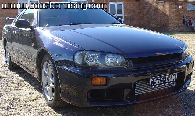

Nah the pics were from when it was sitting at AAMI...they wanted $15K buyback for the wreck....so just took the full payout and bought my GTT <====
