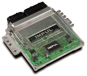

At the moment I am getting around 170KW at the rear wheels with a couple of mods, I was thinking about getting a IMPUL HIGH POWER CONTROL UNIT which is available for For Coupe VQ35DE or Sedan VQ30DD, VQ25DD but not GT8, as mine is a manual sedan I can use a lot of the PCV35 bits.
They say it gives you a "Max power increase, upgrading engine response and fuel consumption, torque up medium speed range, cut off speed limiter and spread rev limit, changing timing of ignition, fuel injection adjustment".

It is a bolt in job or exchange with the OEM unit, I have Japan Parts listing different bits for the V35 that I think Aussie buyiers are looking for that are not already listed, a couple of links below of what I am looking at stocking and a couple of the Impul cars.
Like a Ralliart computer for the EVO, frees it up and changes the tuning a little.
I just like to try something different from what everyone in OZ is doing and why re-invent the wheel if the Japanese are making it.
But isn't it soing to be tuned for Japanese high octane fuel?
Is it like the Mines ROMs that can't be retuned afterwards?
