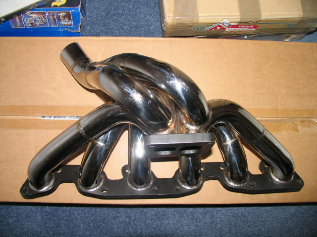

This is a GCG manifold with at GT35 on an RB26.

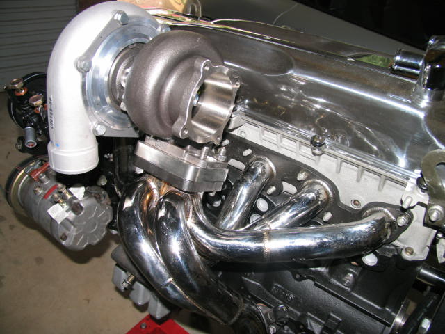

I am looking at getting the gcg high mount manifold too, these are the pics i was sent.
In these pics it seems to me the pipe the gate mounts off goes towards the front of the car and not the rear, and im not 100% sure that is right.
Do you have and pics of your manfold BOOSTED? Also any reason you went the turbosmart gate and not the tial??

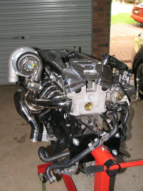

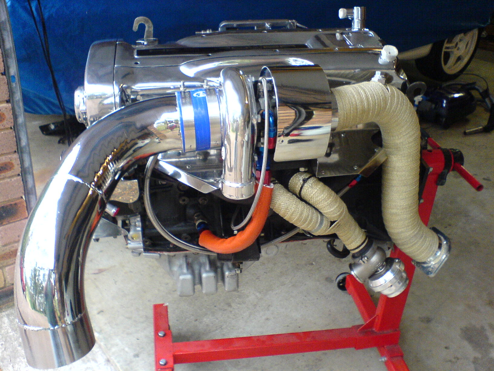

that looks pretty nice, id just be worried bout the cable ties on the wastegate heat rapp near the top :S
It does look very tidy overall. Good effort, and I'm especially interested in the work done to control/contain heat. I'd think the cable ties are very temporary, and we'd see either tie wire or a clamp of some description take its place before installation.
Looks like you're going to be aiming for some fairly serious output there Dave; no longer a daily drive proposition? What are you doing with management systems?
