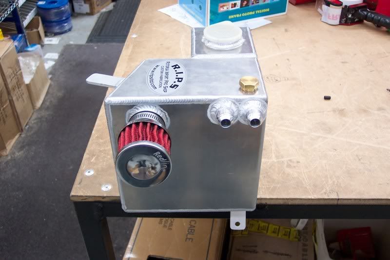

Catch can i fabbed today.
3 inch tube split in 2 halves, then adding 80mm flat section to expand the volume and allow for weld on fittings for the hoses.
Has a hole in the base to allow for drain back into the sump.
Has internal baffle to for oil mist to collect on inner baffle, didnt use the metal scourer stuff in the stocking as the oil drains back into the sump so if anything would happen to the stocking or scourer it would end up in the sump..
here are a few pics of it so far, its blasted ready for the powdercoating
yet to do :
Weld on fittings for breather lines and drain back
Powder coat it

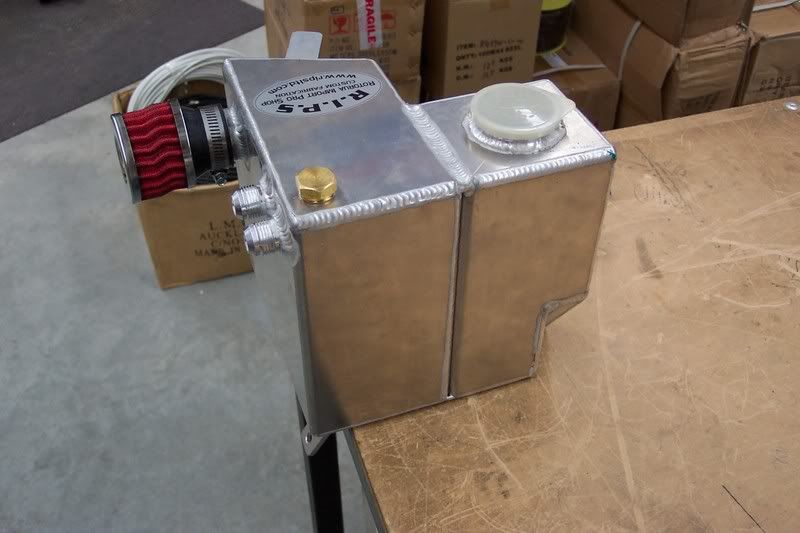

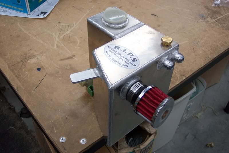

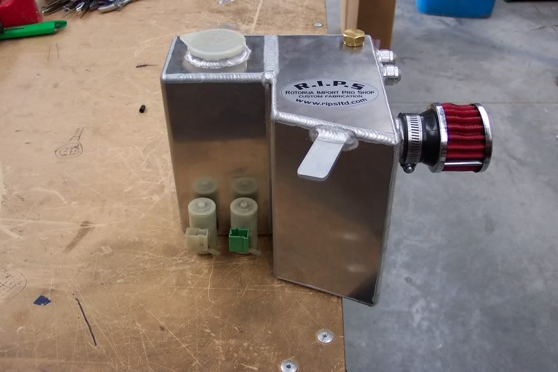

here's some pics of 1 if you need any ideas
I'd definitely be interested in one of those if you got around to making 1 :devil:

the hardest part of it was seperating the 2 parts, now on theirs they make 2 cans and then weld them together ..
that should make it easier, just uses more material.

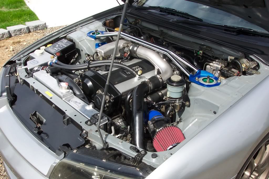

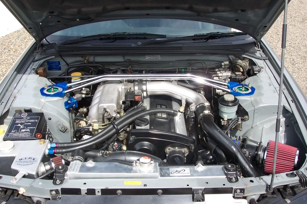

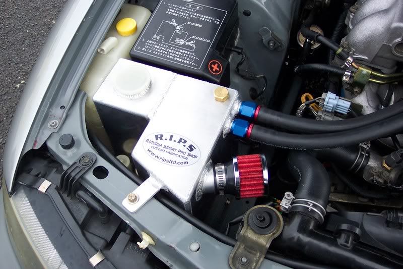

Dont forget that in a road car the catch can cannot vent into atmosphere, hence no filter at the top.
yep thats right Charlie.
1 in - 1 out and the drain.
The Rips style would be a little messy to plumb back, but not impossible

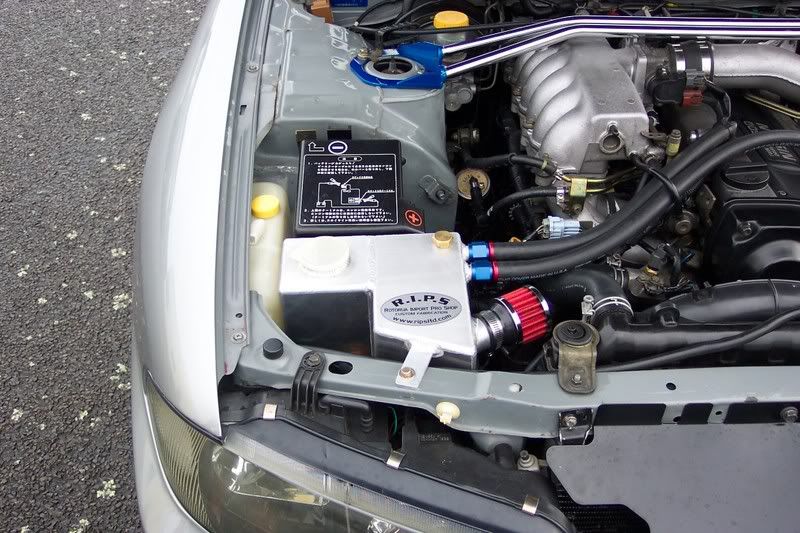

Edit : that R33 pictured is setup wrong all together :D - kinda defeating the purpose
last pic, rocker cover still connected to the intake pipe.
lets it draw air from the filter on the catch can, plus would let oil mist go that way as that would be the easiest path for it - rather than going through the catch can first
yeh i noticed that too, if that pipe to the intake is blocked it would be okay yeh?
yep, that little one that loops over
still lets some air into the plenum if you leave the pcv open though- only on idle though
Edit : that R33 pictured is setup wrong all together :blink: - kinda defeating the purpose

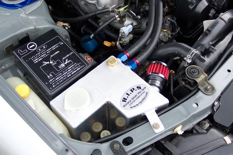

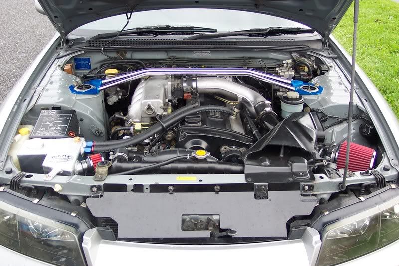

Actually that pipe is a bit of a trick lol, i had nothing to block up that breather with so left the standard pipe that normally goes to the intake pipe on but blocked up the end of it (the hole in the intake pipe was blocked up aswell ofcourse), i have since got a rubber cap to block off that breather.
Thats my car by the way :), basically my setup is just the two breather pipes coming off the cam covers going into the RIPS catchcan, everything else was blocked off, my setup is illegal in aussie from what ive read but you could always just weld another fitting onto the catchcan and run a hose with a pcv/one way valve back to the intake manifold to make it legal over there, would be easy enough.
You can see in these pics how that breather was blocked off
Edited by nizmo_freek
ahh yes
tricky tricky :blink:
few little extra additions in there now too - nice
