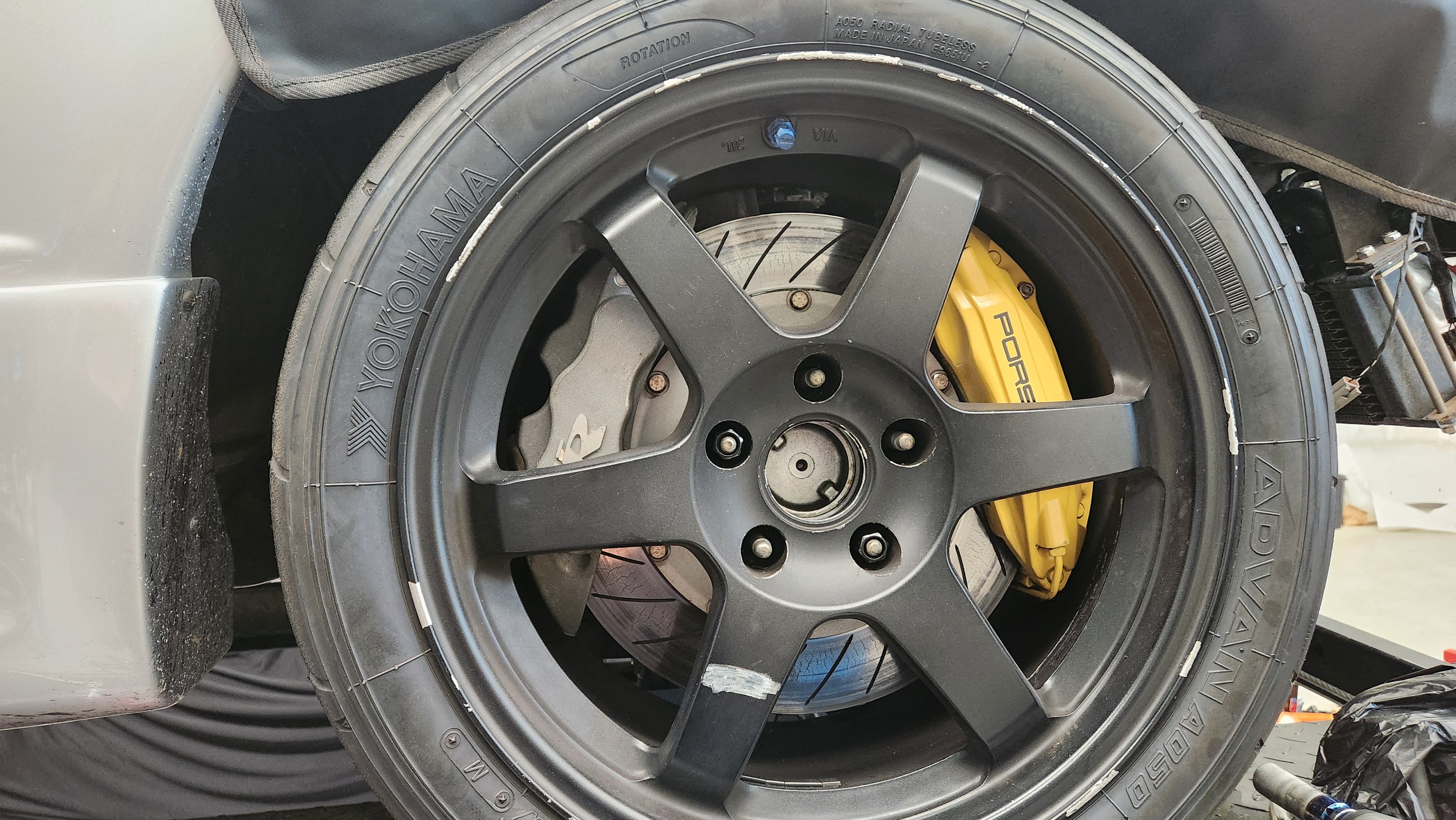

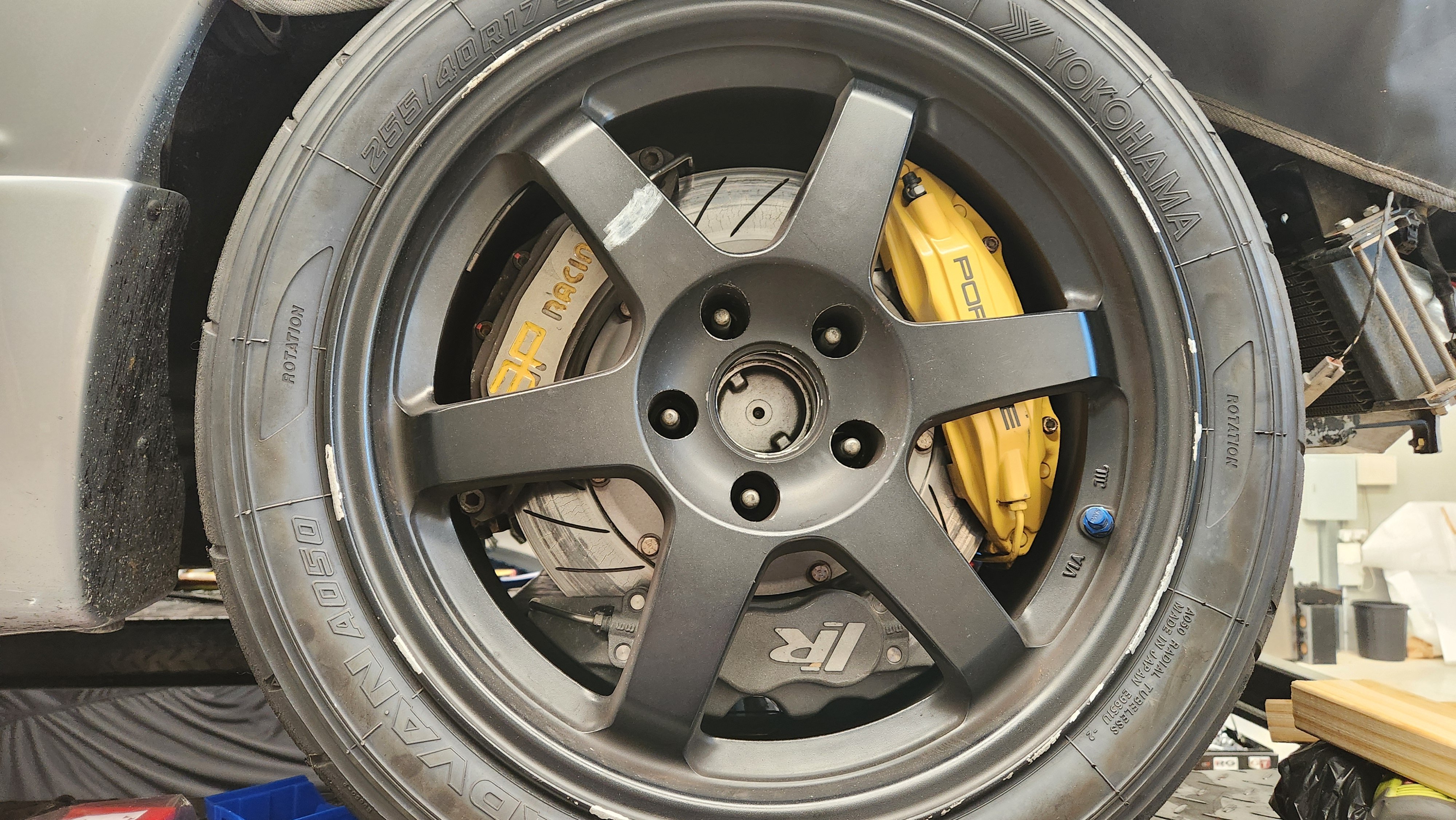

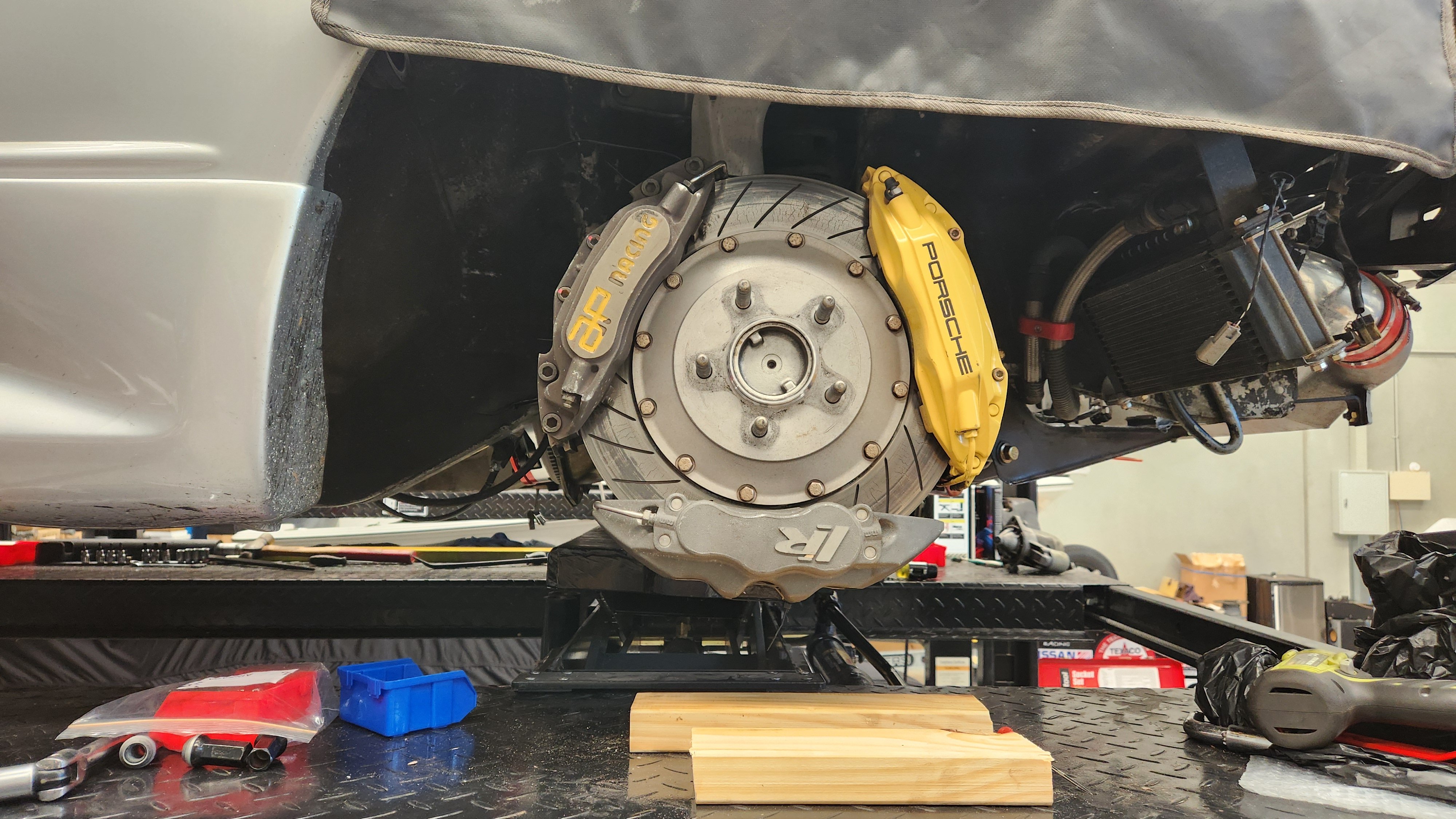

Started sifting thru my brakes to decide which ones I will run on Clem
Made me think I should just put them all on Silver...for when brake fade just isn't an option
Should be able to bump rotor up from 343x32 to 348x36 off Supra. Not sure if the Supra annulus is right for the Alcons or APs but trying g to find a used Supra\M4 rotor to test fit
The Alcons seem to gain 1-2mm clearance which all helps
