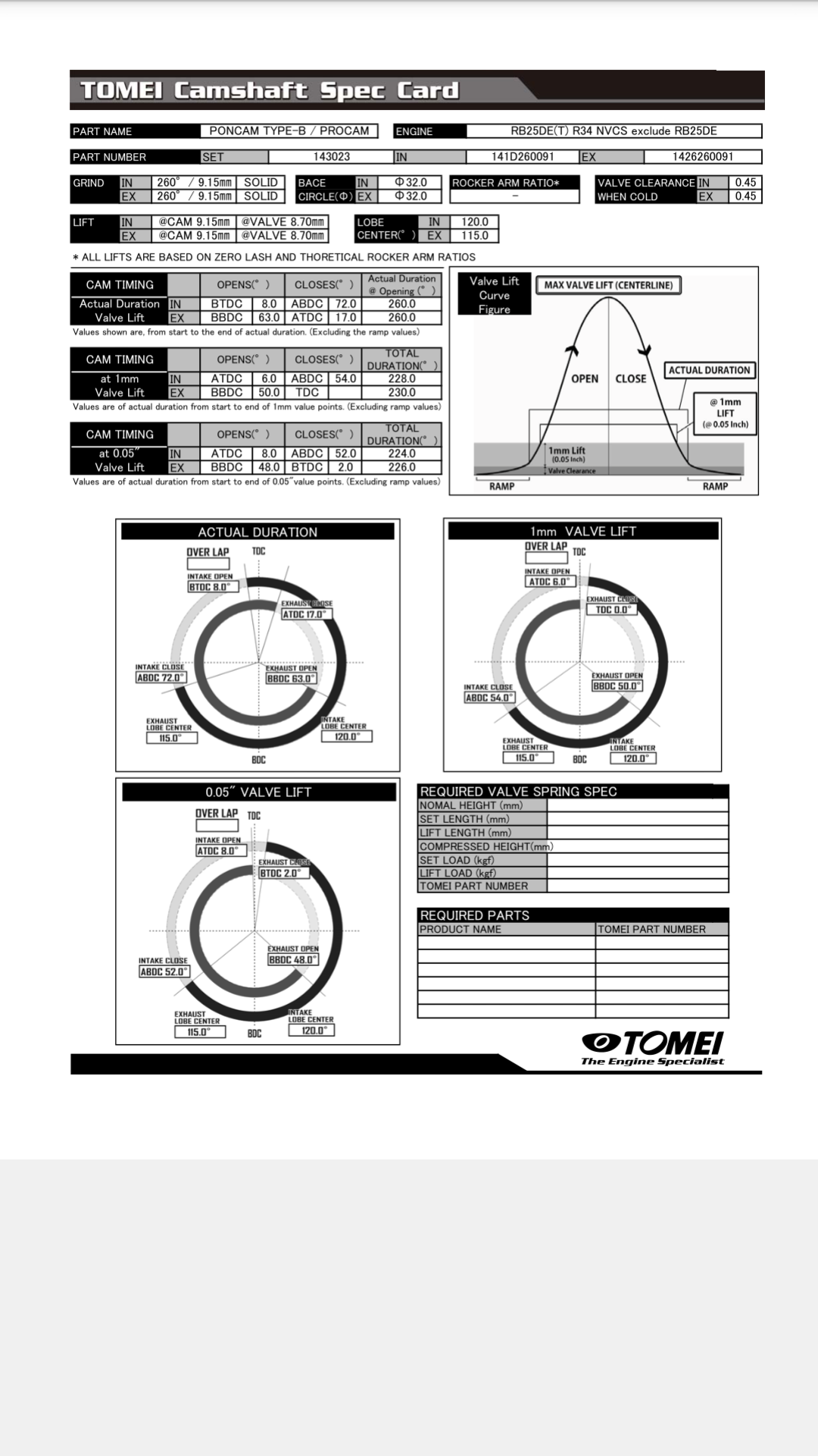

Search Tomei USA Cam Cards . On this computer Internet Explorer fails so try Firefox instead .
R34 GTt Type A 252/9.15 lift cams . 4-68 59-13 on 120 and 115 deg (in/ex) lobe centers . Overlap 4+13=17 degrees .
R34 GTt Type B 260/9.15 lift cams . 8-72 63-13 on 120 and 115 deg (in/ex) lobe centres . Overlap 8+13=21 degrees .

By setting up the cam at the correct degrees to the cam card specs you get the full effects of the cam and power from the up grade.
I know people normal just play with it on the dyno but if you set it up correctly before you put the car on the dyno there is no reason to adjust the cams on the dyno other than to bring on boost earlier or move the peak hp in the rev range.

I'm trying to work the 25T Neo valve timing from Tomeis duration and lobe centre numbers . Works out
236/232 durations and 119/115 lobe centers . In theory the inlet duration halved minus the lobe centre angle should equal the inlet opening time ie 236 halved is 118 - 119 = -1 . Duration is 236 so 236 - 180 = 56 . 56 - 1 = 55 so inlet timing must be 1-55 .
Exhaust 232 x 0.5 = 116 . 116 - 115(lobe centre angle) = 1 degree before top dead centre so exhaust valve timing looks like 52-1
overall 1-55 52-1 .
Overlap 2 degrees ?
