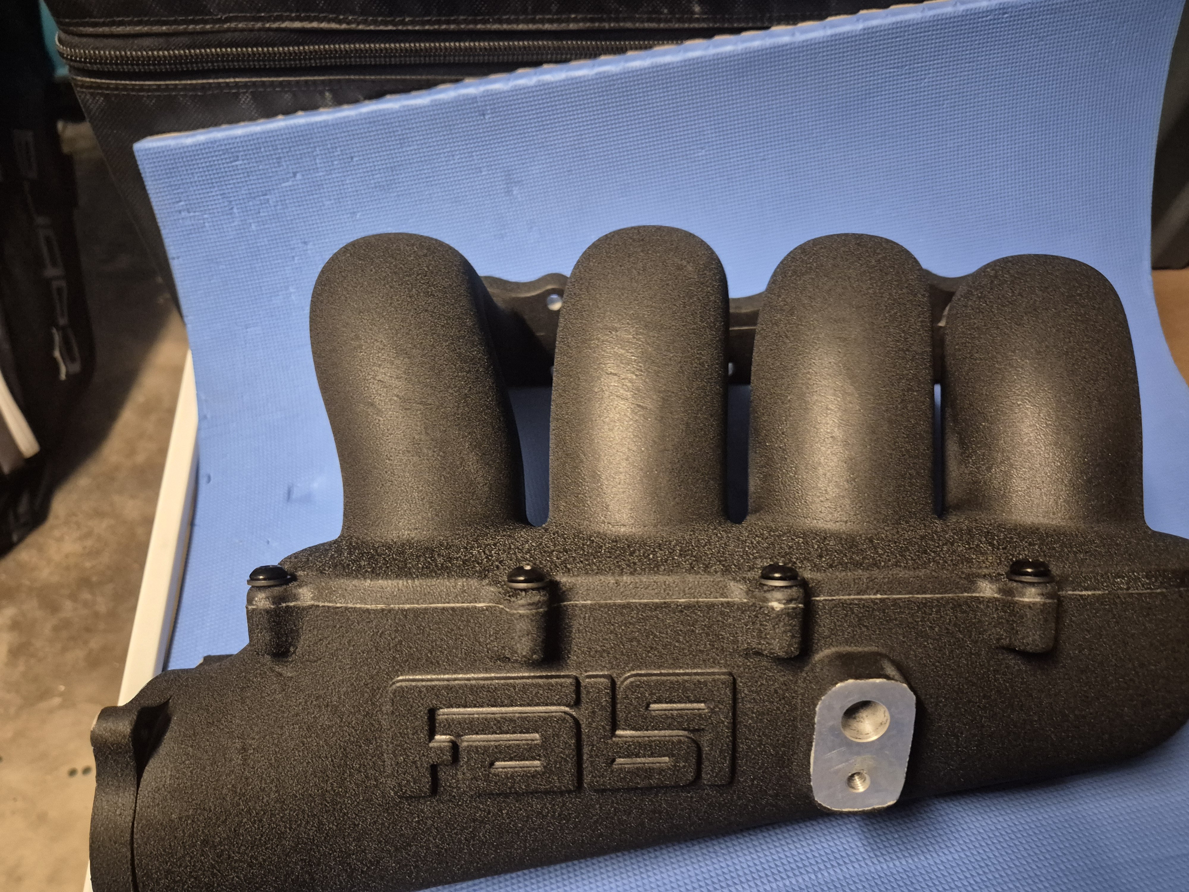

Tried some stainless allen head bolts I had laying around, they stuck out like dog balls, so I went to Bunnings and got some black coated jobbies, which I like alot more.....basically OEM....LOL
I'll RTV it up this week sometime ready for MX5 Mania to do their thing

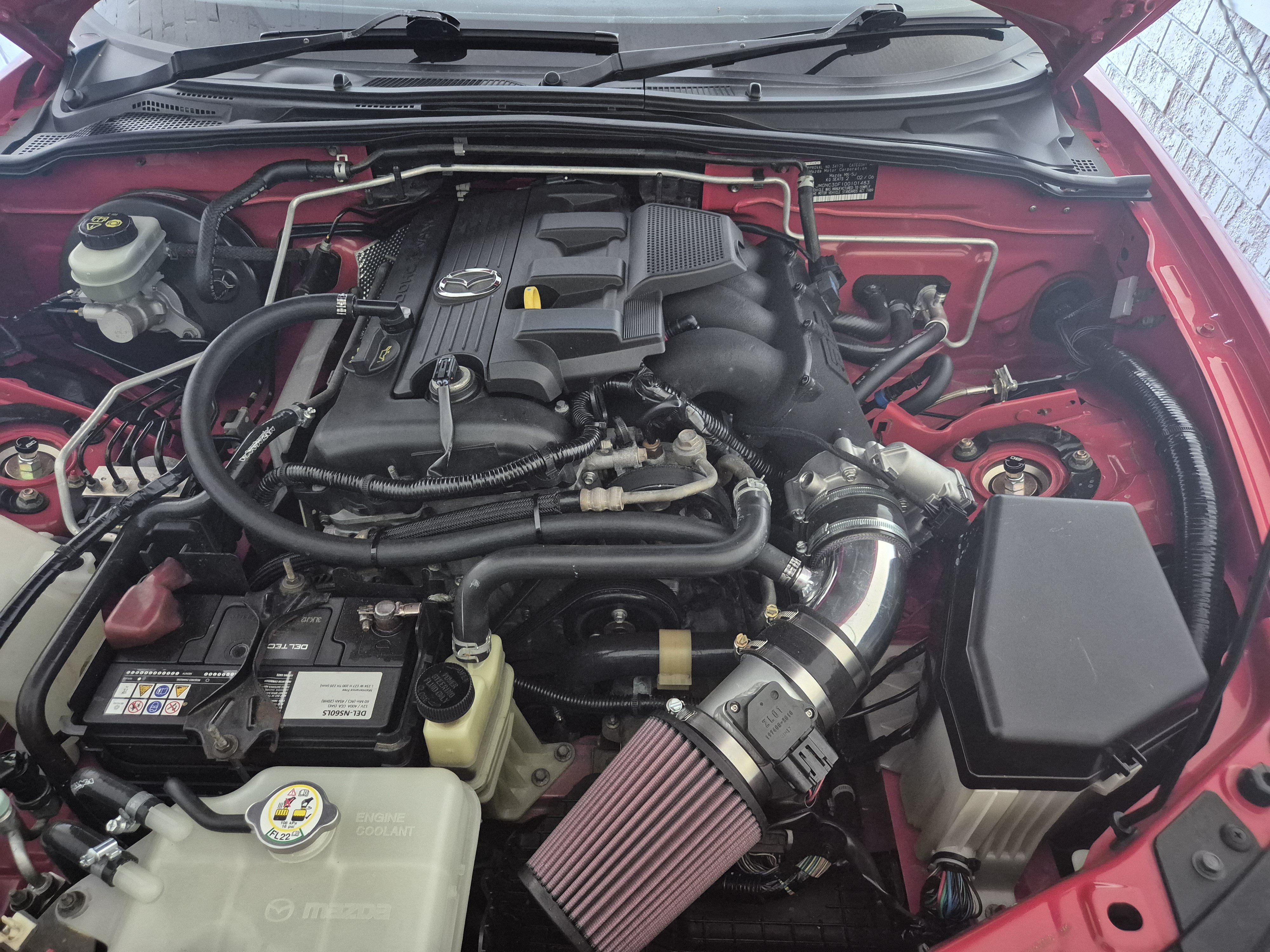

Just got the car back and gave it a good run back home
Power wise, whilst it only made a extra 5 killerwasps up top at 7200 rpm, it made more power everywhere from 2500 rpm and kept pulling much harder all the way, to the point of me relearning when to shift so I don't hit the 7200 limiter, with the old intake it seemed to take alot more time to rev out, and, throttle response is also much improved
As I didn't want to remove the bumper every time I serviced the air filter (basically every aftermarket and fabricated CAI has the filter behind the bumper) it currently has a hektic exposed pod in the engine bay sucking in hot air, this will be rectified shortly after some some of my CAD (cardboard assisted design) for a alloy heat shield feed by the OEM intake tube behind the bumper, this will cop some wrinkle black paint, as well as the intake pipe for that totally OEM look...

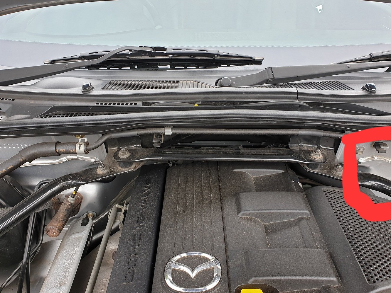

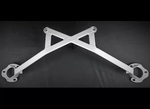

The only fly in the ointment was that the OEM "strut" brace doesn't fit over the rear runner of the new intake with the 2.5 engine is in the engine bay, as the 2.5 raises the engine up by 20mm, it's not a war stopper, and I didn't notice any difference without it in some twisties, but....... MX5 Mania is bringing in some GWR "fancy pants" braces that apparently do fit, if it bolts up I'll grab it, it is also stiffer than the OEM one, which is a bonus
All in all I'm happy with the outcome
Fancy pants "strut" brace that gives the required clearance
This is where the clearance issue was, the GWR extends out past this
