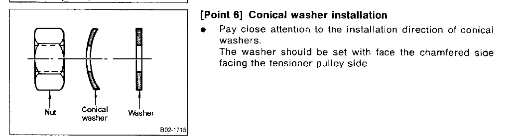

2. EN-62 point 6 shows the conical washer the other way around (BTW I know we discussed above, I hope you are changing the idler as well, while it is no guarantee the bearing is a actually bad, it looks terrible)

re en-62 point 6 what do you mean? I am changing both tensioner and idler but looking to find torque setting as well

I think I follow re en-62 , I looked at rb26 and conical washer is after pressure washer.
so order is nut then conical washer then pressure washer but I don’t know which side should recessed bit should face( conical washer )

Yeah sorry I meant page EN-62 from the R32 GTR workshop manual, Point 6, which says this about the 2 washers on the tensioner

I've done a lot of research and feel like I'm becoming a nut and washer expert. The washer in question doesn’t look very conical—it’s almost flat, but one side has a chamfer.
The guide's picture shows the convex side (chamfered side) facing the nut, but the text says the chamfer should face the pulley, which is confusing. If I follow the picture, the chamfer faces the nut, but the instructions say the opposite.
When I place the washer on a flat surface, one side looks flatter—maybe that's the concave side—so I would expect the chamfer to be on that side. But it isn’t, which adds to the confusion.
The term chamfer is also throwing me off. I always thought the concave side should face the pulley, and the convex side (with the chamfer) should face the nut or bolt head. But Nissan’s instructions say the chamfer should face the pulley, which seems backward.
I know I’m probably overthinking it, but I want to be sure I’m doing it right.
Also, I’ve seen some people replace the nut and stud with a bolt, but I assume that’s not a good idea, since it might not keep proper tension on the tensioner.
Lastly, just to be 100% sure: the pressure washer should face the pulley, then the conical washer? That feels strange, since usually the pressure washer goes first, facing the bolt or nut.
