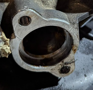

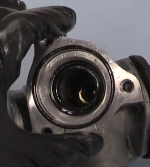

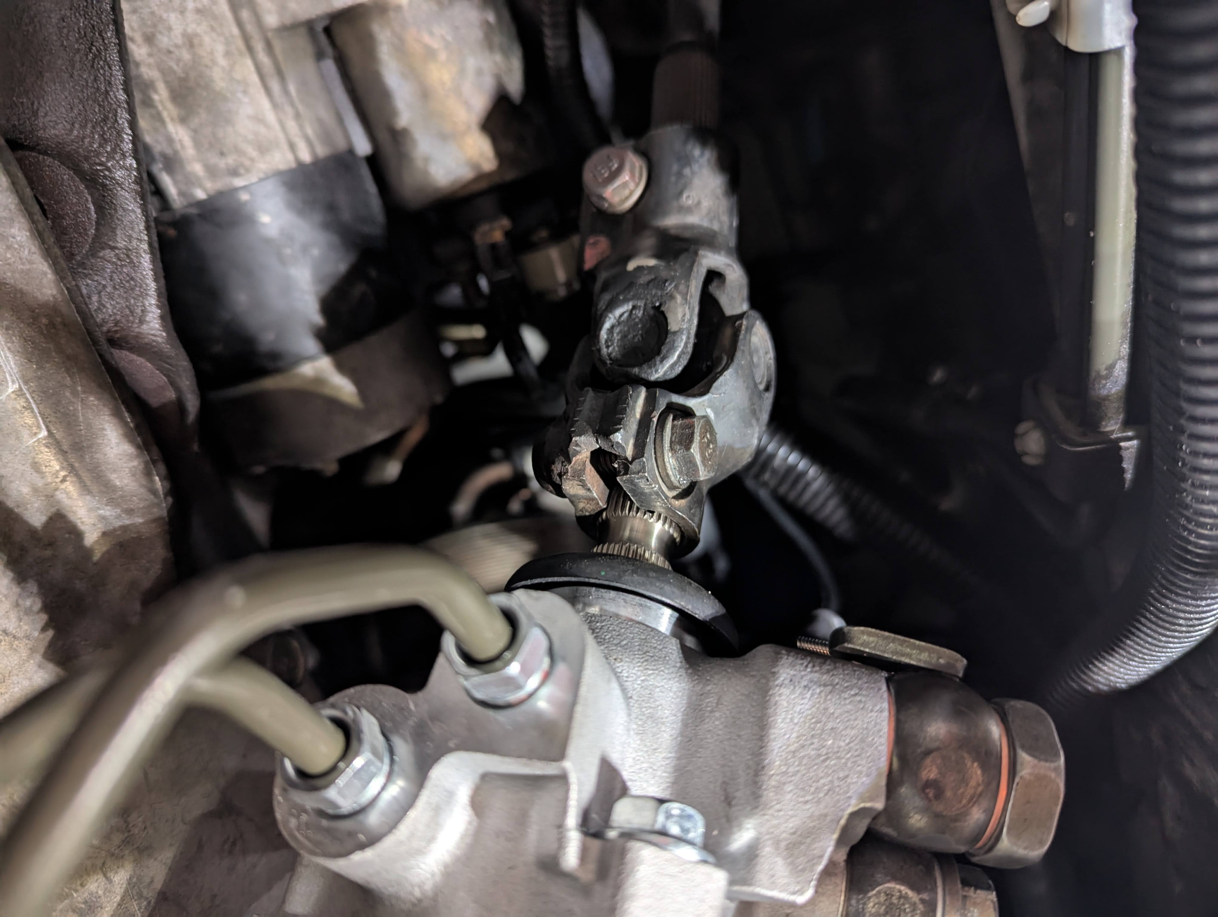

The pinion shaft on the other racks bolt on with 3 torx bolts:
Whereas my rack bolts on with 2 allen head bolts:

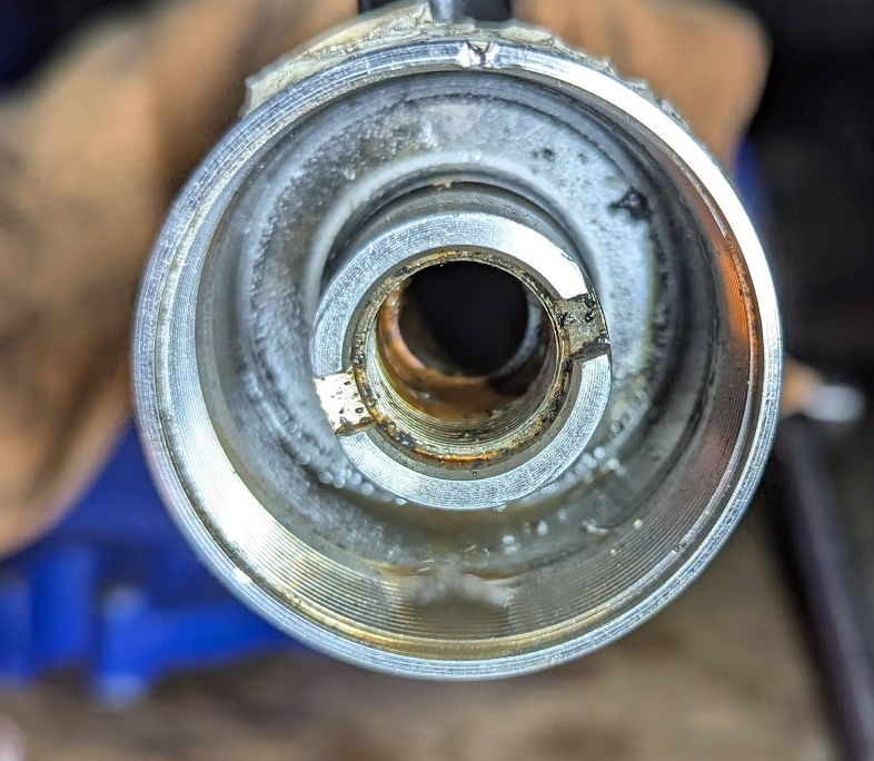

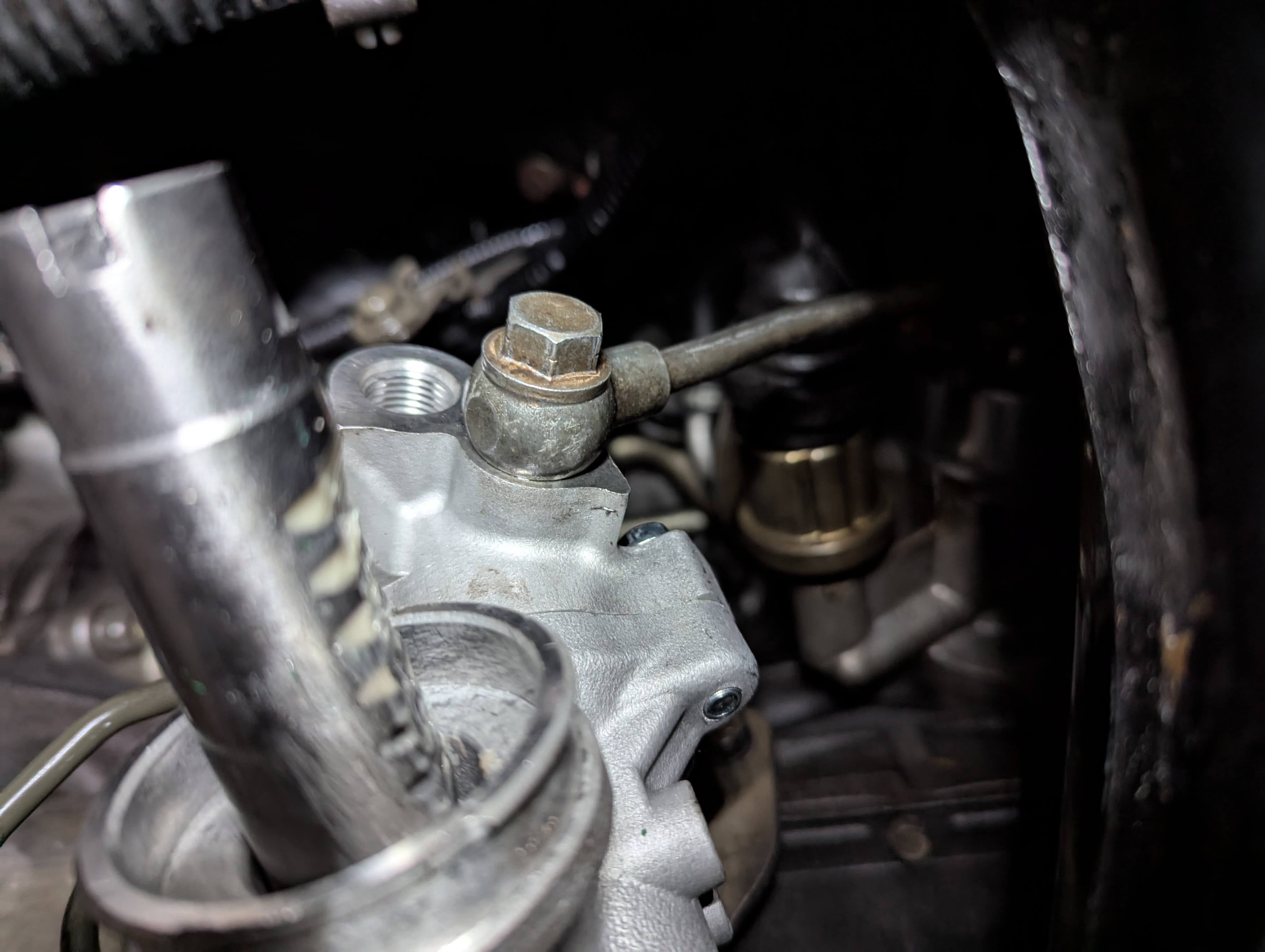

These changes are pretty inconsequential but the main difference is how you pull the actual rack out of the housing. The other skyline/s chassis racks can be taken out by tapping the rack out of the body with a socket and it just slides right out. I'm unable to do that with my rack because there's a hard stop at the end that doesn't let the seal/shaft be tapped out.

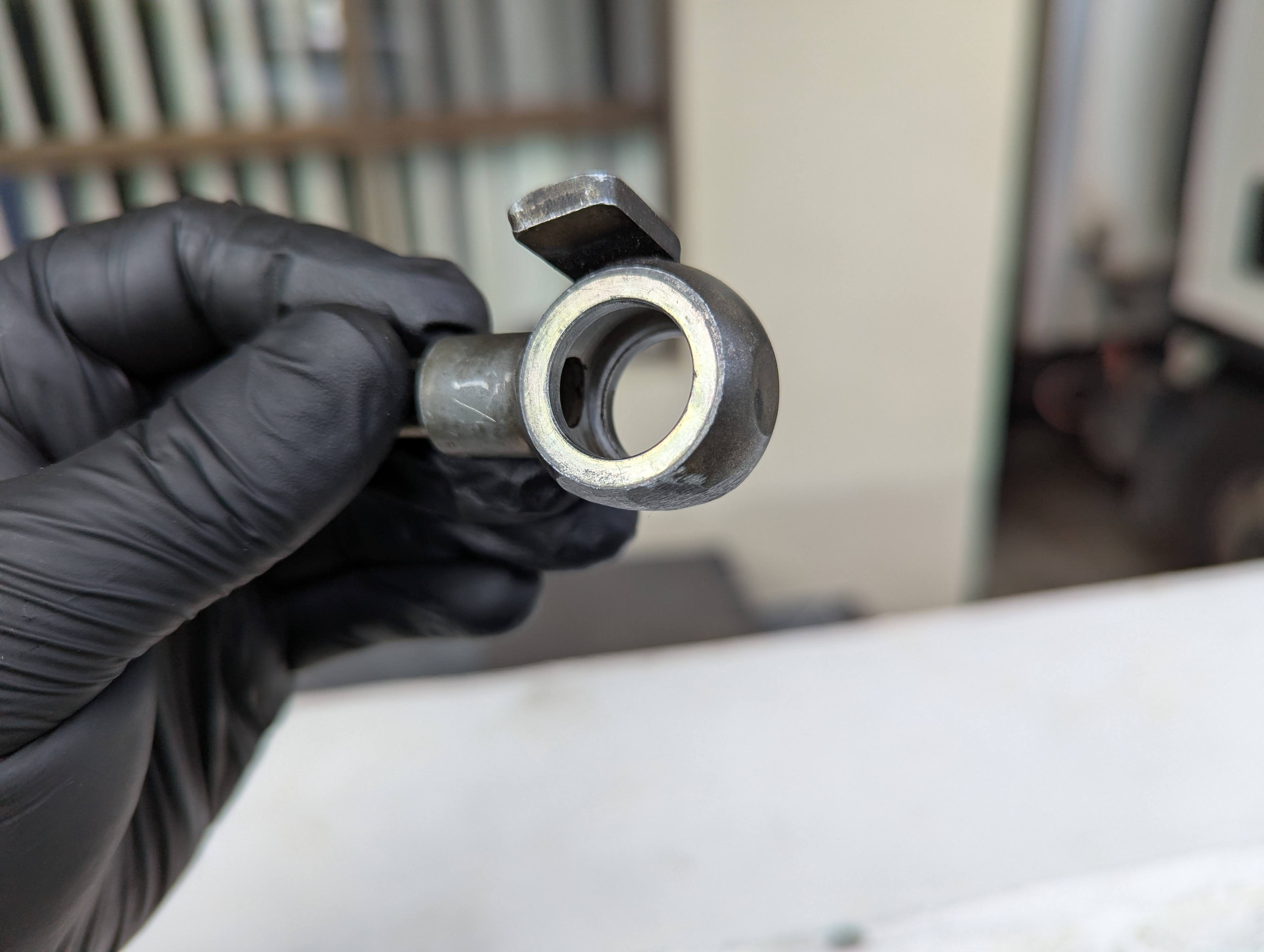

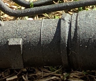

Can also see a difference in the other end of the rack where mine has a notch that looks like you're able to use a big wrench to unthread 2 halves of the rack whereas the other racks are just kinda set in with a punch.
My rack:
Other racks:

I've never played with one, but I would expect that you are correct. That slot looks like it is intended to be used to unscrew the end, and the flats on the body would be better than grabbing it around the round bit with a pipe wrench. So, yeah, probably unscrews. You'll probably have to make a tool to drive in that slot.

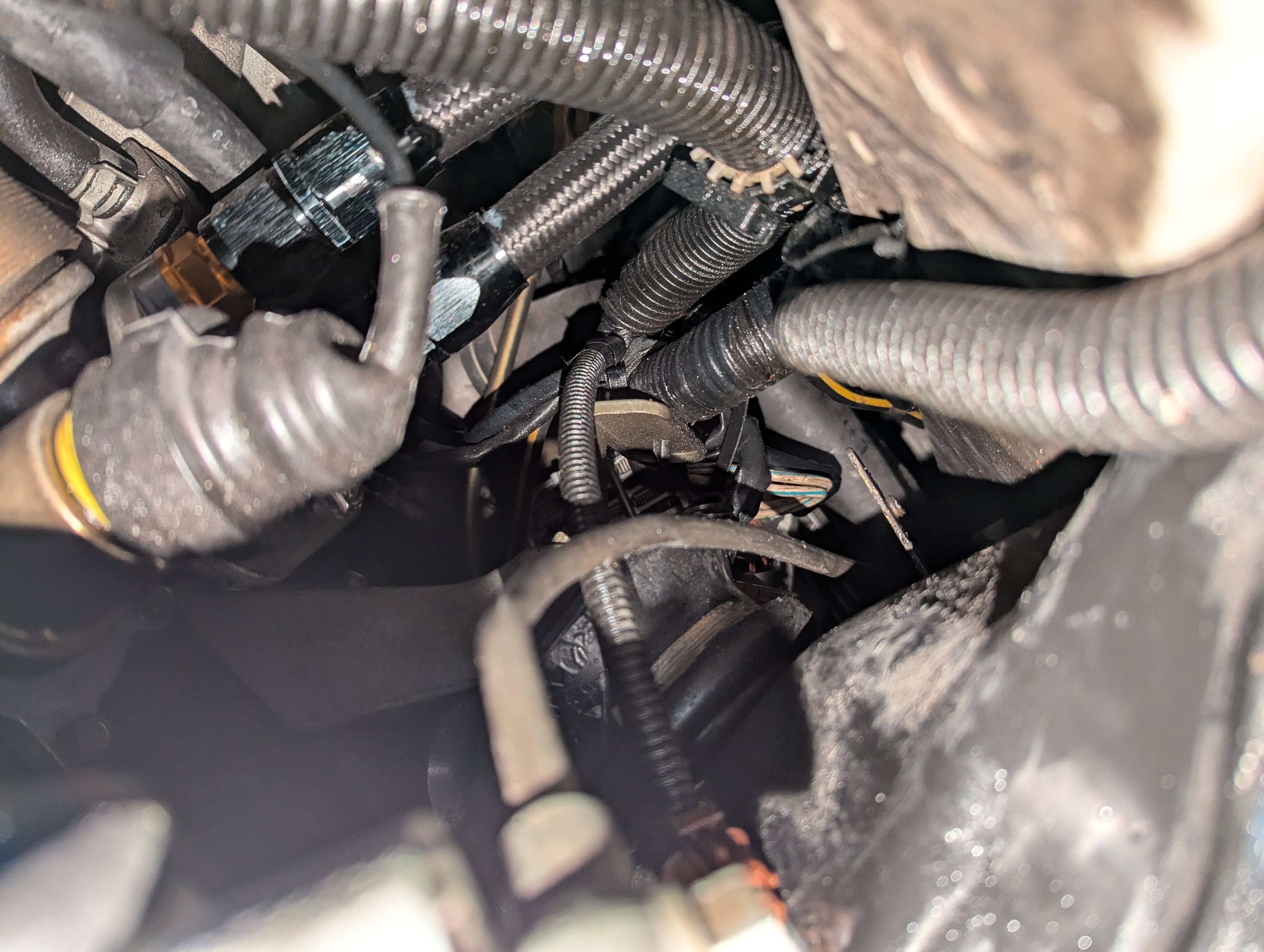

Hmm yeah that is a good point. It looks like it'll just bolt in with no real issue besides maybe the bushings being different. My other concern was that 2 pin plug that I assume is used in some way to control the rack solenoid depending on the speed signal from the ecu. The DMAX rack doesn't even have that plug though so, don't think it'll matter. Might just order the rack and see how it goes.

Note, the aluminium bit that screws in the end that you have to remove to dismantle the rack is single use as it's punch-marked, it will strip when you unscrew it, and then you have to flatten the notch in the steel rack body, screw in a new aluminium end when rebuilding, then punch-mark it again once assembled. it is also 'somewhat tricky' to refit the rack>steering wheel linkage gear as it needs to be set to the right preloads etc. A rebuild is probably something that's better just given to a steering shop for a couple of hundred, unless you're mad-keen to do it yourself.

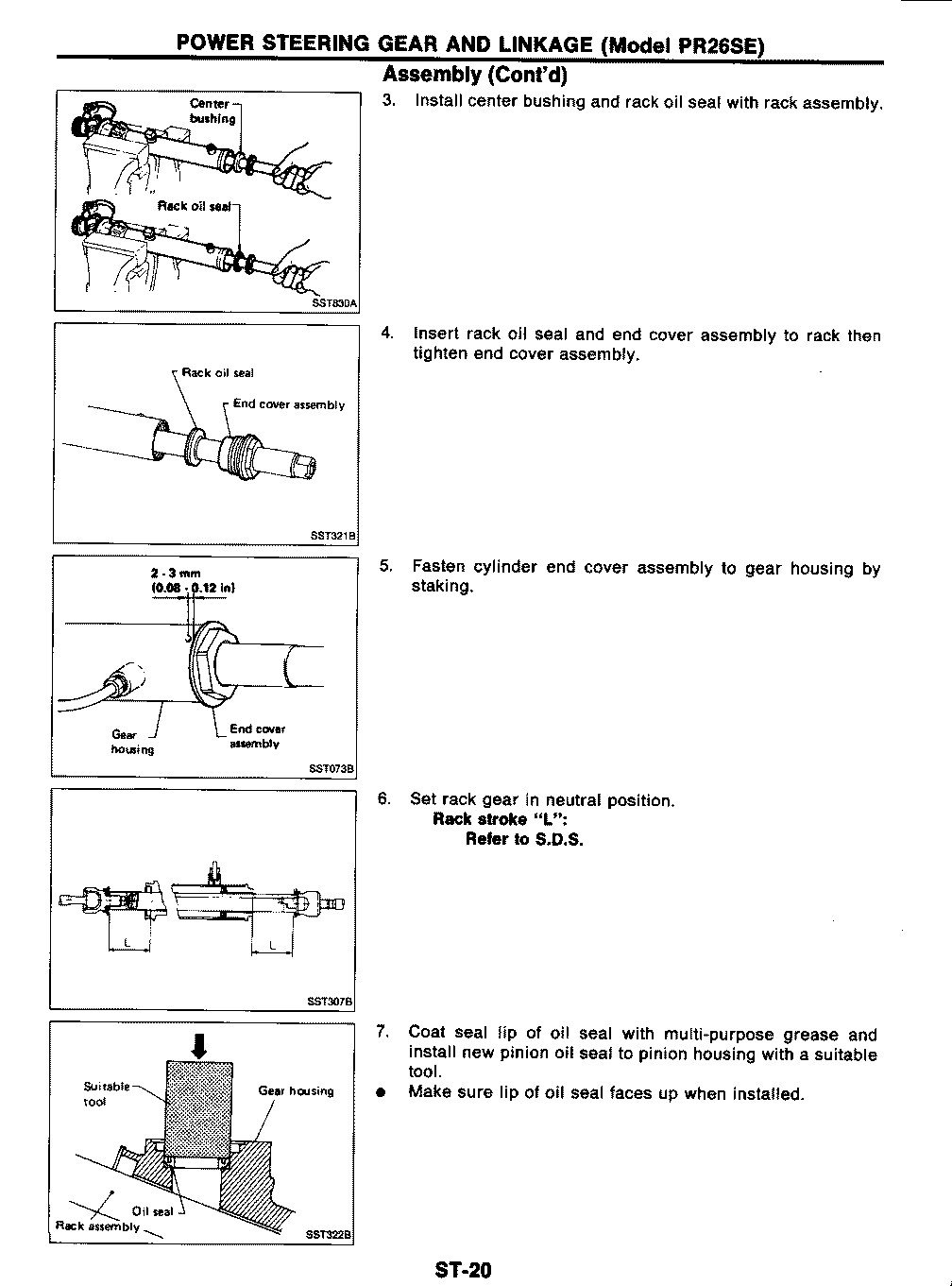

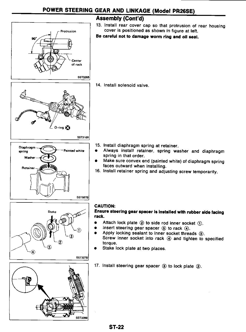

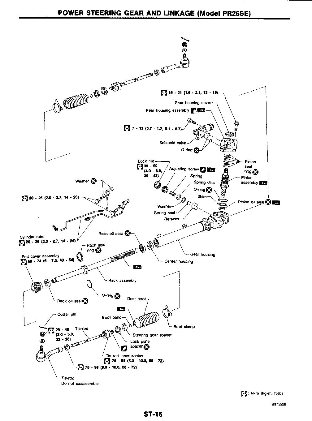

I had no idea where to find the workshop manuals so no I hadn't seen it until now. Taking a look at it though, the rack in that diagram looks like the one that I don't have so I can't just pop it out with a mallet or something.
I've kinda given up on the rebuilt at this point to be honest, just waiting for the dmax rack to arrive so I can get it to fit and be driving around again. Appreciate the input :thumbsup: Also I ignored all the advice I saw about that punch mark on the nut at the end and absolutely stripped the hell out of that nut lol

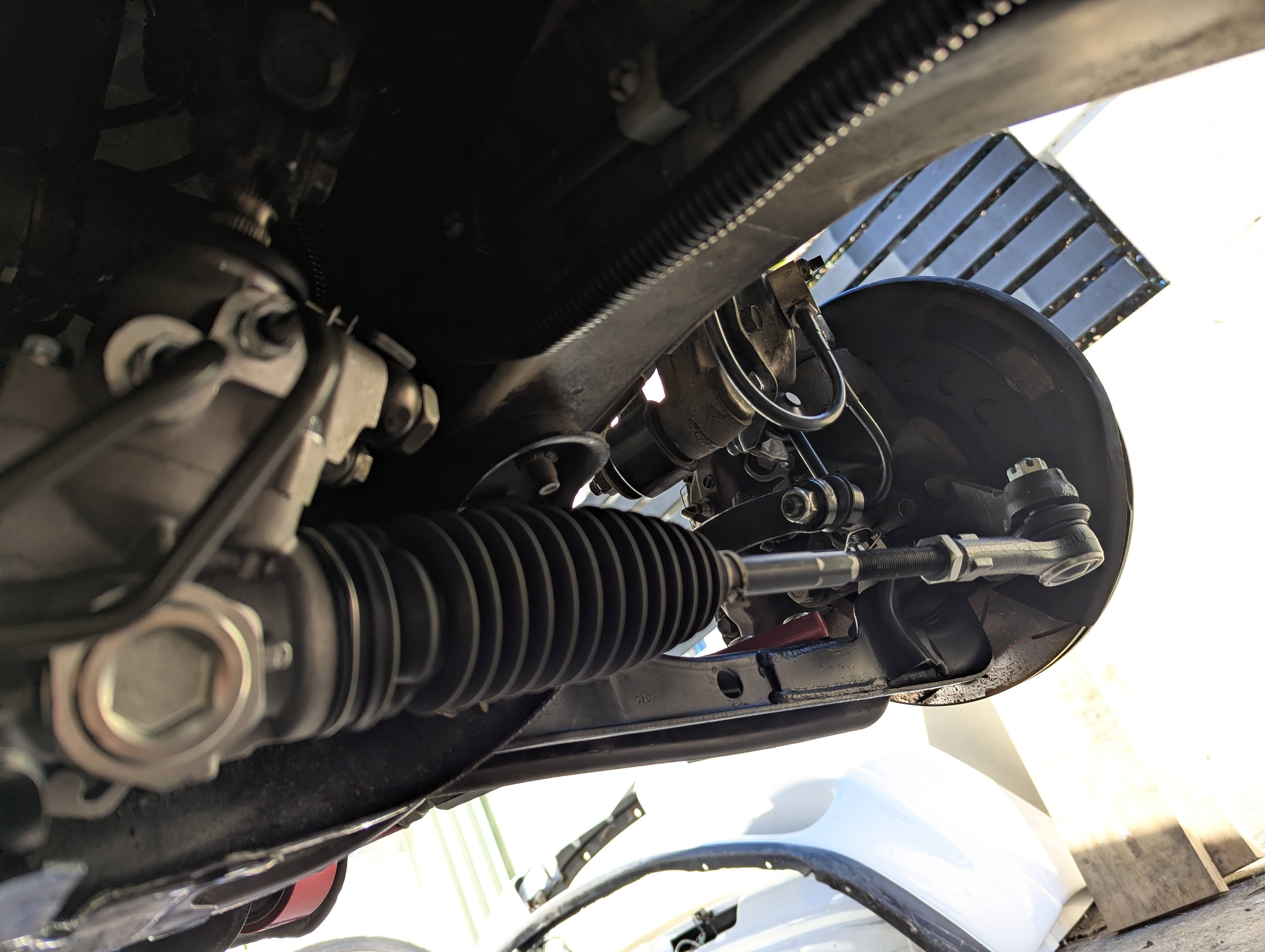

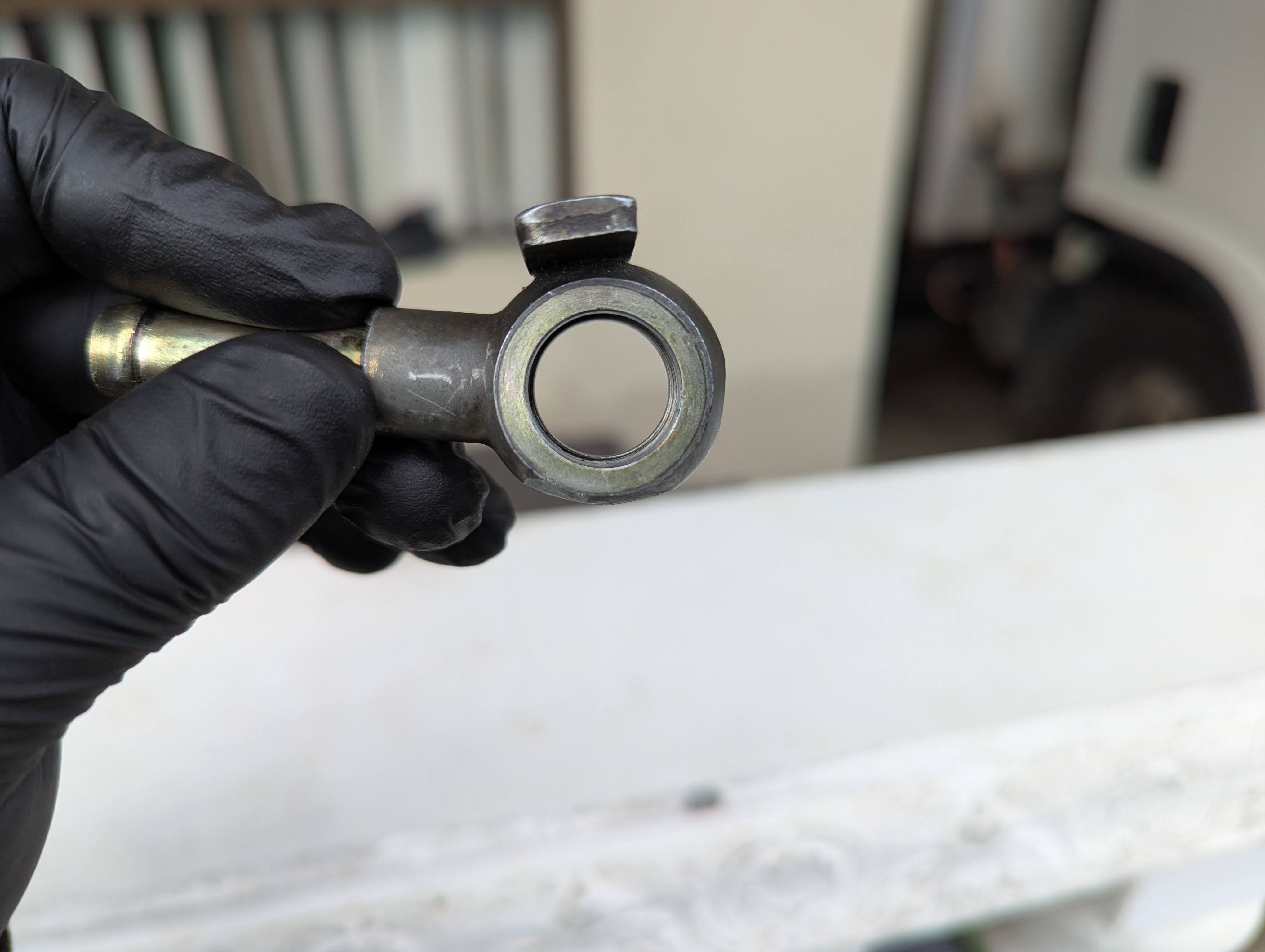

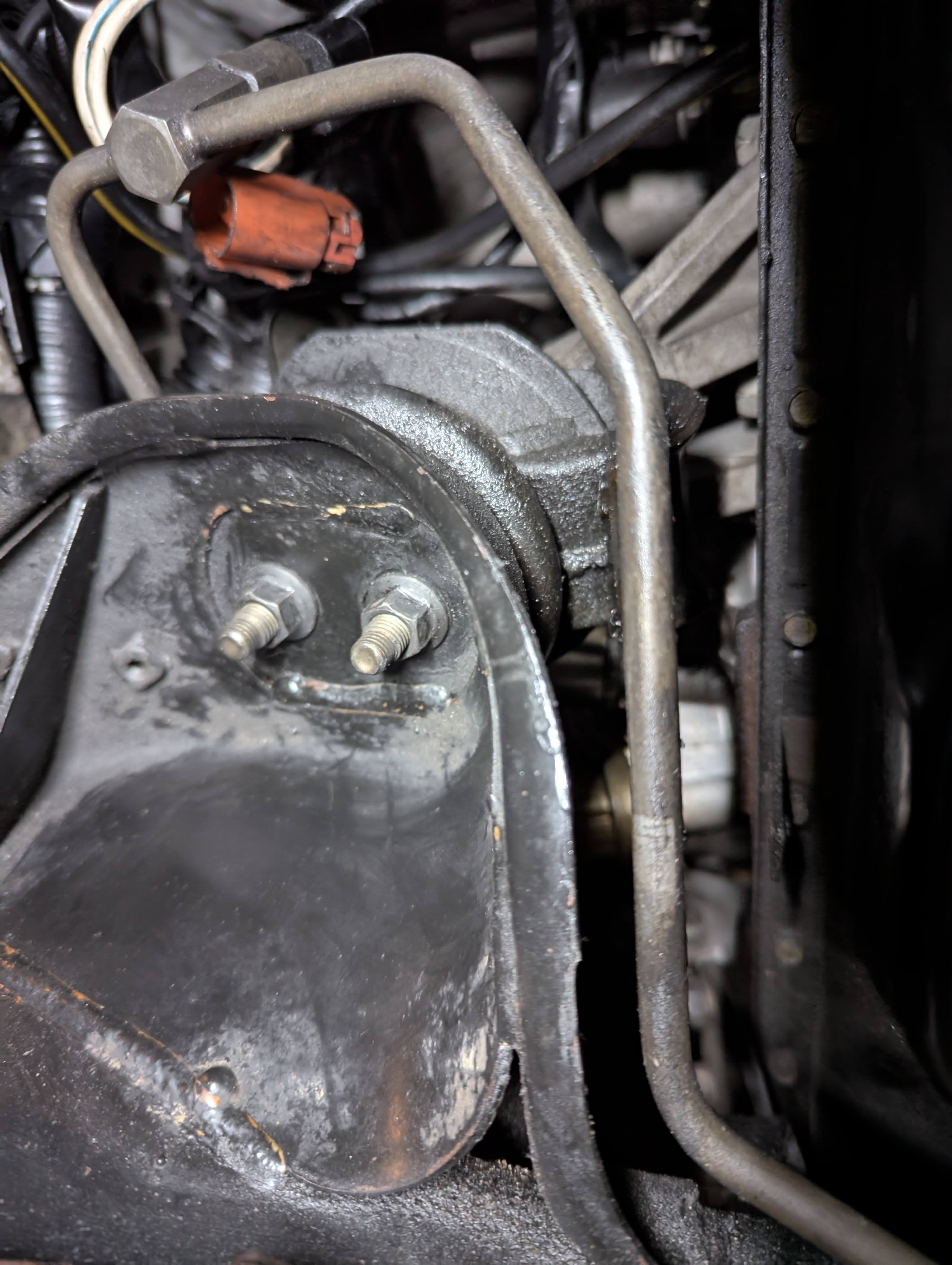

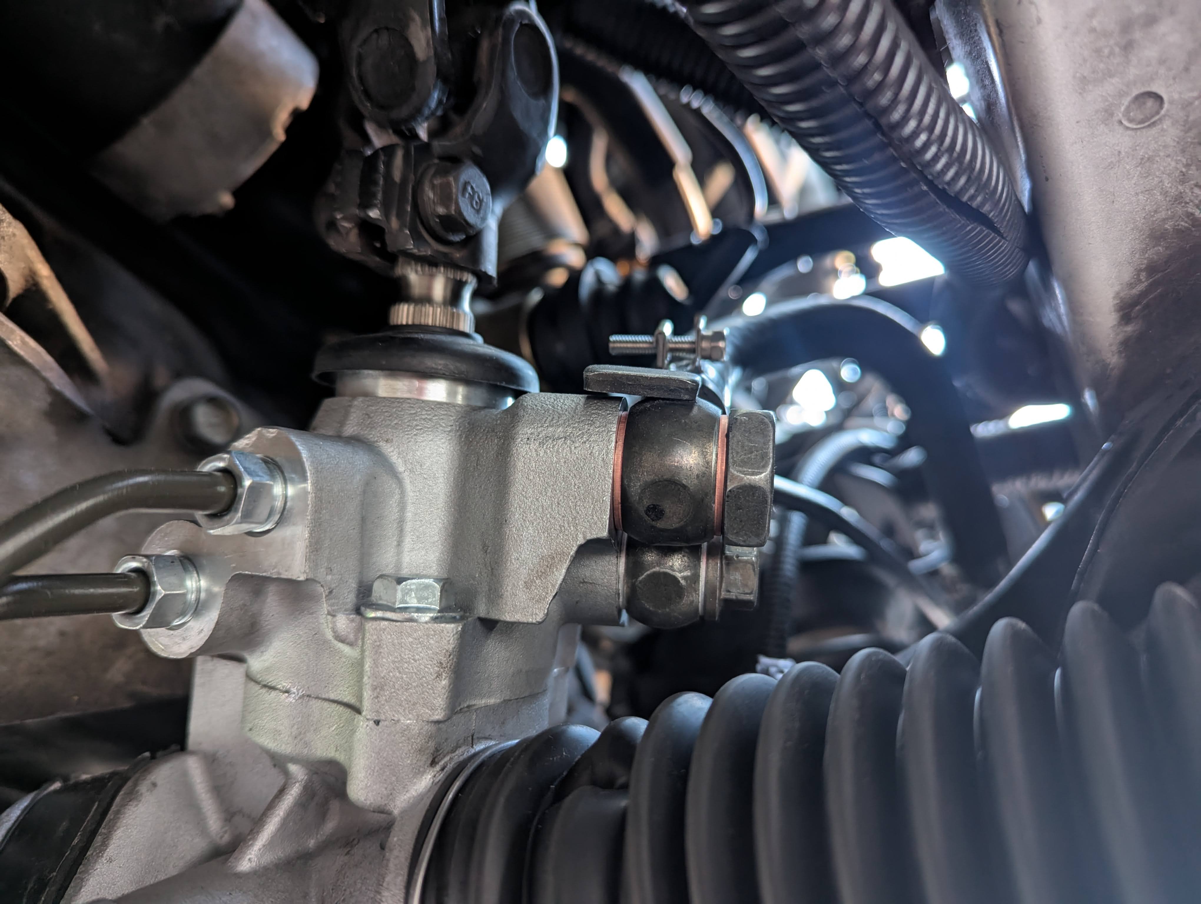

Finally have an update on this :sweat: Rack came in this week so I did a test fit. You do need the S chassis bushings since the rack is 5mm thinner than the R33 rack. The main issue I foresaw and ran into was one of the hardlines not lining up properly with there it's meant to on the rack.
After some gentle coercing and bending very slightly, I managed to get it to fit without any kinks and keeping the hardline pretty much in all of the factory mounting positions. I did have to unbolt all of the soft mounts to move the line around so I could snake it out and bend it safely but it looks good to me for now. I'll update when the rack is fully bolted in and functioning.
