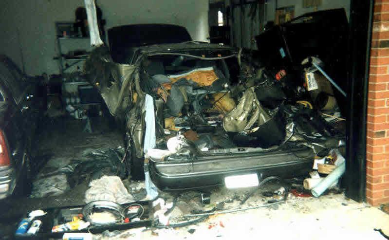

Add into the equation fun things like nitrous backfires, DIY installations, and who could forget the genius who connected his bottle heater to a constant 12v and went off and forgot about it? Not much different to leaving a car sitting in the hot Australian sun.

...and a reminder of why this is not a toy. :P
