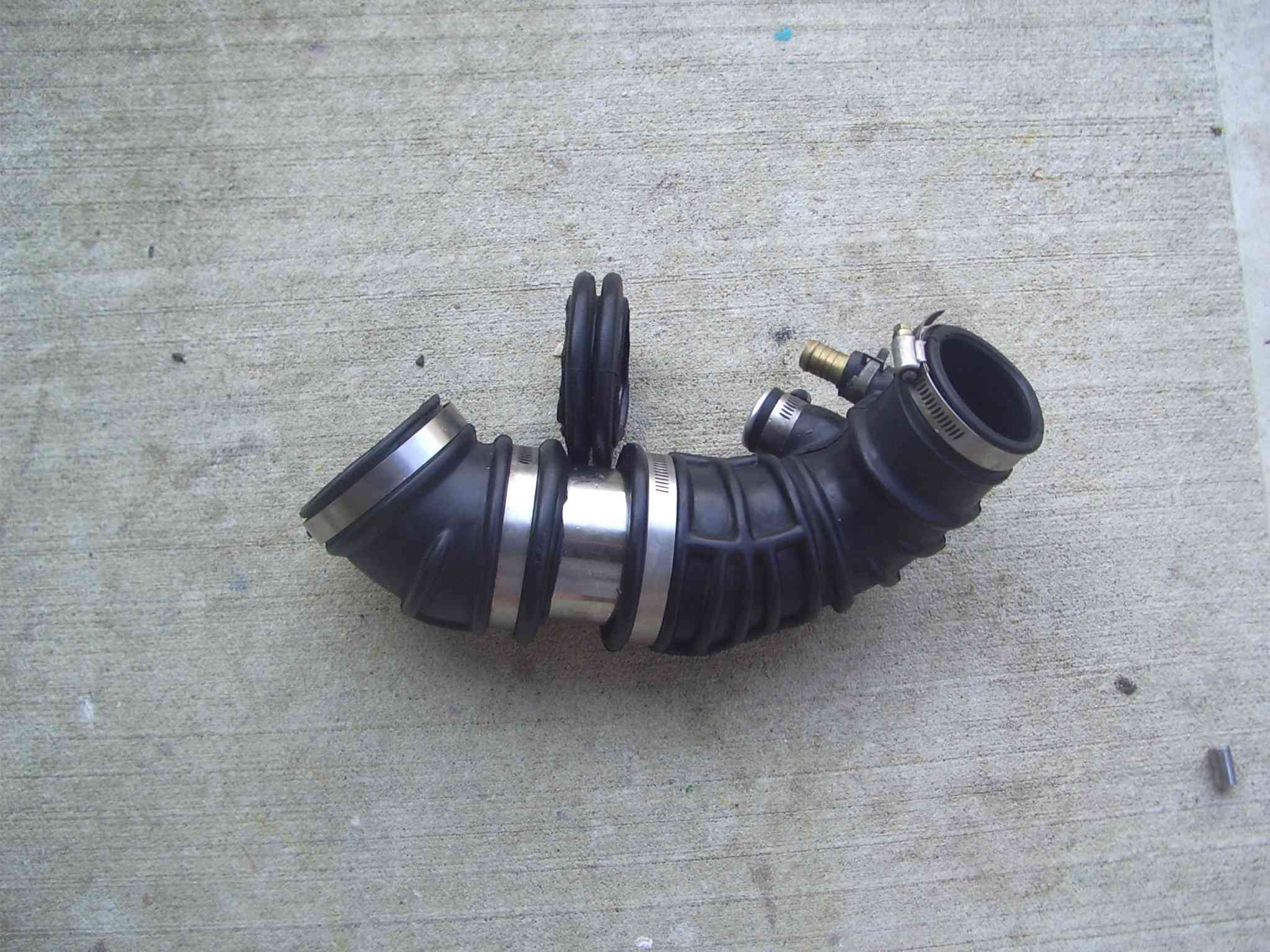

All you need:
- Scissors
- A 13cm peice of off-cut 3inch metal pipe. Stainless is nice but, mild steel is fine. (usually free)
- Two appropriate sized 3inch diameter hose clamps ($5)
How to:
* Remove the intake pipe from the vehicle.
* Block the turbo inlet with a clean rag to prevent dirt getting in.
* Cut a section out of the middle of the flexible intake pipe where shown in pic 1. Scissors do this easy enough. Note to take the middle 2 bumps out cutting along the 'valleys' either side of each bump.
* Take a moment to clean out the peices of intake pipe you are going to re-use.
* Grab the off-cut 3inch diameter metal pipe section and cut it down to 13cm. 13cm is as long as you can realistically go.You can go much shorter 10cm or less if you like and this will give you more flex for re-fit if you want it or if you are using an aftermarket pod that sits in a slightly different position. Run a bit of sand paper or a file over the edges to remove any sharp bits that might cut the rubber pipe.
* Push the 13 cm metal pipe gently but, firmly into the each side of the two intake pipe peices with hose clamps already loose but in place.
* tighten clamps
* re-install
Off you go! :(

I also have done this mod but its slightly different for a R32 GTS/4 as the pipe seems to have a bit more of a curve.
I cut the rubber once in the middle flange and inserted a curved 3"Dia piece about 45degrees and just mooved the
rubber back into the orig shape on the outside but did not clamp it at first because the fit was so tight.
But I had idle issues that went away after clamping as you did. :(
you get 7+ hp for doing it regardless. Not sure when the stock one sucks closed but, I assume you would need a fair bit of power to do so anyway.
