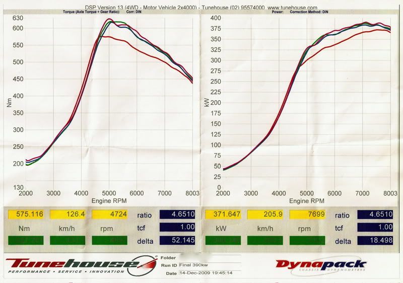

Hey Moneypit,
Well done for persisting and solving all the issues you encountered along the way to make the V Cam work! I am glad everthing worked out for you in the end.
Impressive result on 2.6L capacity. The V Cam certainly makes engine revs pick up a lot quicker and smoother.

Hi Moneypit,
Thanks for the feedback, we were very happy with the result we achieved and are very happy that you are too.
It was quite a drawn out process getting it all to work in harmony and Jim took his time to get it perfect.
We look forward working with you on the next stage!!

bit of a thread dig, but was looking through this the other day and thought i'd compare to my recent E85 run, and was surprised to find some pretty similar things.
at 4000rpm we're both 175rwkw
at 5000rpm we're both a touch above 325rwkw
at a little past 7000rpm we're both at the peak
comparing say 3000rpm i have 75rwkw and you have a touch above.
is the difference "of interest" just the pre 3000rpm perhaps? or was this the prelim tune and there was still some tweaking needed?
