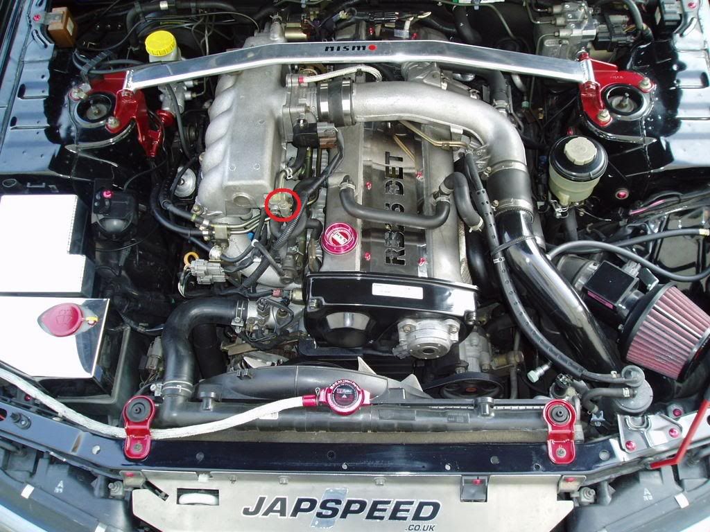

http://i161.photobucket.com/albums/t228/MrPs_skyline/Old%20car/Bleeder.jpg
circled in red - 10mm bolt - will probably be pretty seized up, once you crack it it should be fine though. don't lose the washer. :P

http://i161.photobuc...car/Bleeder.jpg
Anyone know whereabouts it is on an RB26? Same kind of spot?
Maybe I could use the water temp sensor as a bleed point.
