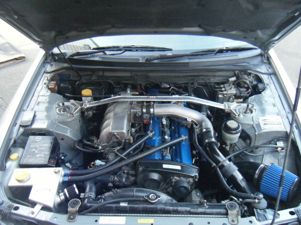

Hi this is how mine is setup works great large hoses from r/covers and smaller hose to turbo inlet catch can full of coarse stainless steel wool and pvc stock
Back to what i believe was part of the original question and what i would like to know, is it better to use bigger breather hoses to get more out faster than standard, i have mine plumbed up in the factory configuration but i use a line from the cam cover that does not have a restrictor in it like the factory line does, it then runs through a catch can filled with stainless steel wool as a filter and then back to the intake pipe, is this better/worse/no different to have the restrictor in the line?
I used to have my breathers vented to Atmo with the PCV blocked but after a while i was getting blowby and plumes of smoke out the exhaust at idle, and taking off, and backing off.
I was advised to put the PCV back to stock, and have never seen another cloud of smoke since.
The setup i have now is, Stock PCV, Breathers vented to Atmo VIA a catch can, and no turbo inlet pipe.
As someone mentioned, i just dont think the turbo inlet has enough vacuum at idle to sufficiently draw the vapours out of the head, if it did then the PCV wouldnt be there factory.
