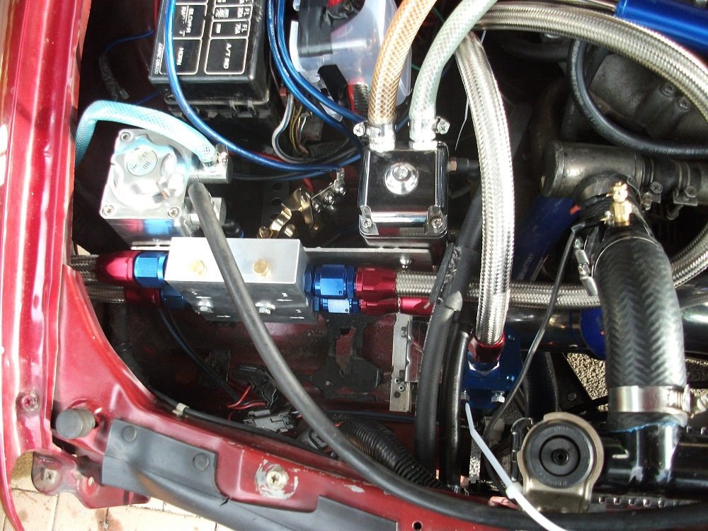

I went with a remote thermostat, (Earls) which is a pain cos its gotta go somewhere (no space). Having the thermostat in the plate would save space.
But if you hook it up wrong, no oil to motor.

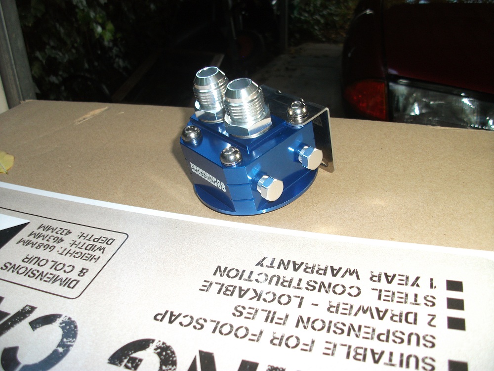

However the one bit i got right is the sandwich plate, it needed one 90 deg fitting and one straight to get past things.
Pic one: i found this style of sandwich plate easy to fit lines to.
Pic two: my mess, should re-do it better.

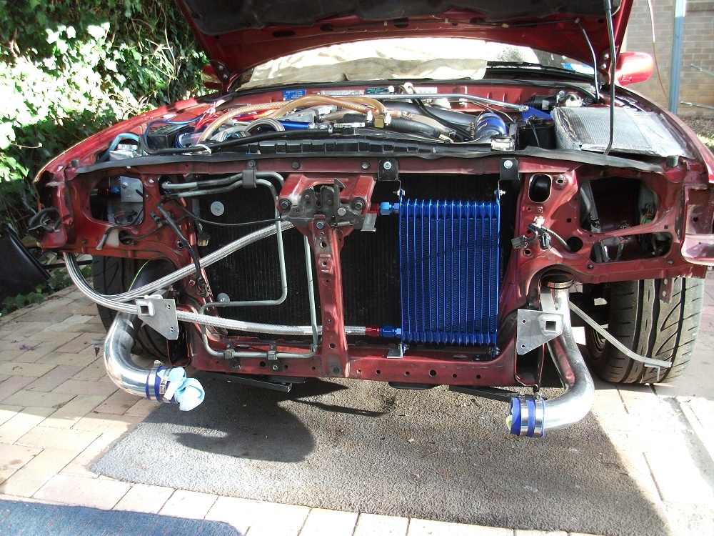

Pic three: Aircon sux goodbye.

The Greddy unit linked can spin around to any angle, and allows the lines to go into any of the four holes. It's a high quality thermostat too.
It uses 1/8th bspt fittings for the sensors which is standard.
lol yeah i was gonna say.. it has a big nut in the middle of it, put the sandwich plate on where you want it then tighten the nut :/ same principle as every other sandwich plate on the market!

I thought that was wrong there's no way your engine will starve from oil. And there's no way I'm eliminating air con to fit this, I didnt have much room between the cooler and air con condenser so I snuck it in behind the air duct for the driver side steer wheel below the indicator. 2 mounts directly to the front reo bar direct and made a bracket just to take some of the weight.
Almost the whole core has air flow I just need to get new lines made as these won't reach as it has 4 shortish lines for the remote set up.
