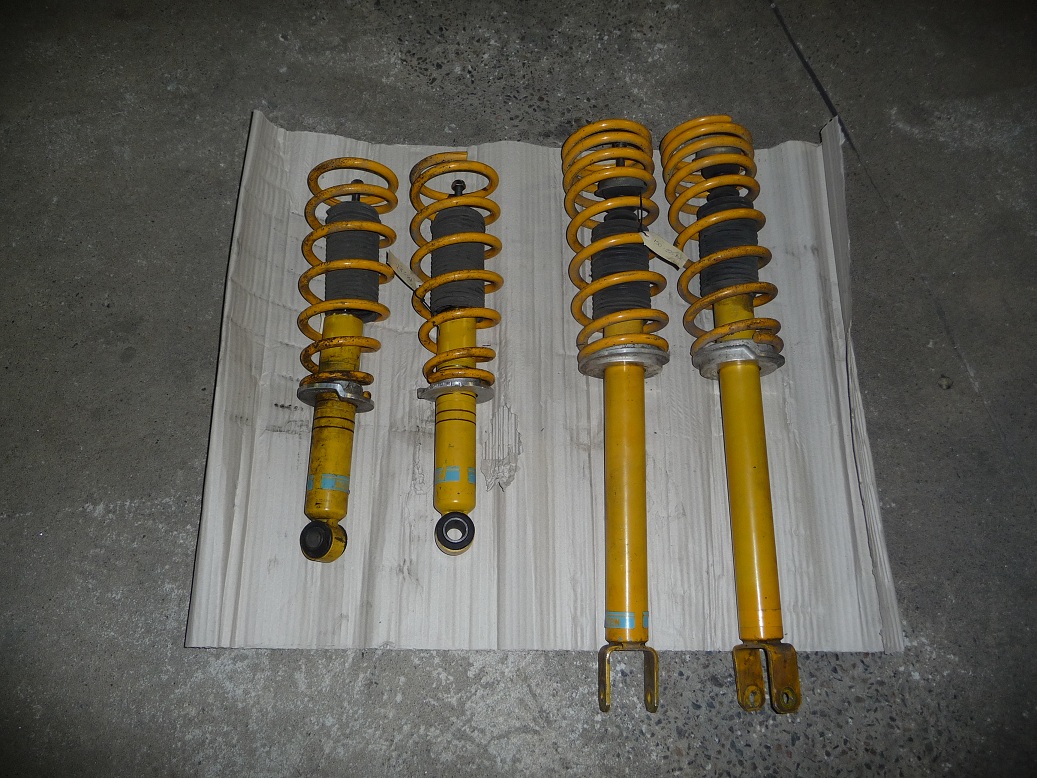

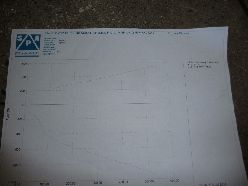

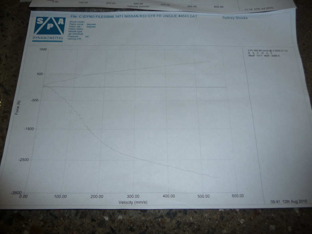

I downloaded these from a for sale thread ages ago - simply because they were the only dyno charts I had seen on GTR dampers. They are for the yellow Bilsteins off an R33. Anyway apologies to whomever the vendor was - hope they sold them...
