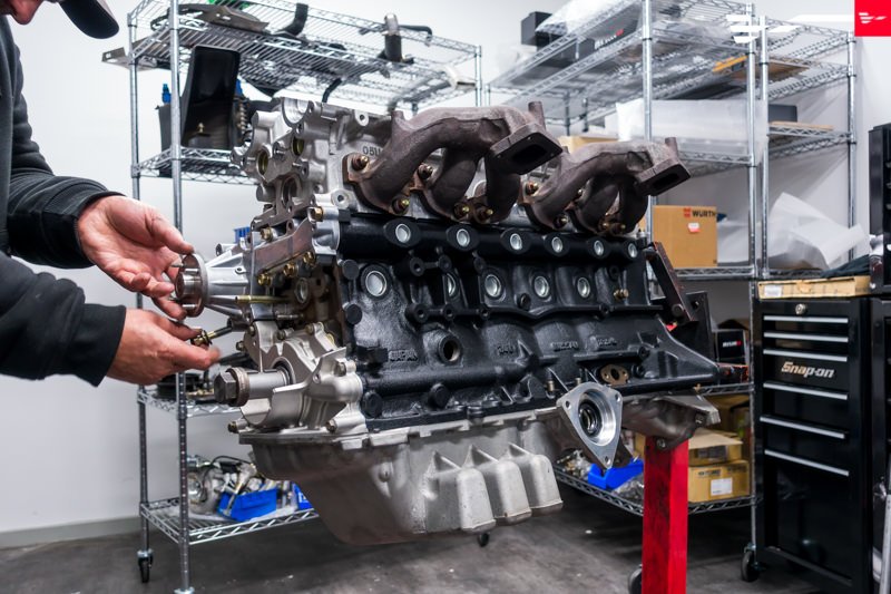

I've missed a few steps in between but an update nonetheless. Tomei 2.8L Stroker Kit, Water Pump, Tomei Oil Pump fitted - Standard Turbo Manifolds and Sump dummy fitted, for now.
