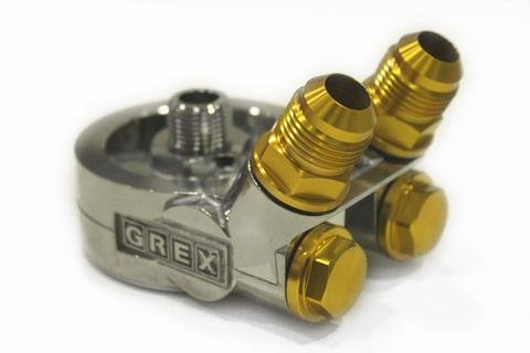

The oil cooler/sandwich plate was fitted in Japan (I'm the first owner from import) and there are some other GReddy bits on the car, so I took a punt and searched for Greddy oil cooler bits.
this
looks similar to this on my engine
still interweb searching for detail on the GReddy kit, but from other 'net photos I've found it looks like the sensor port on the left/upper gold bolt is on the correct side for measuring the hot oil from the engine rather than cooler oil returning from the oil cooler.
Unfortunately I can't find detailed info on the GReddy site :(, but the hopefully the laser thermometer approach will confirm this...but swapping the bolts/plugs over is easy if I need to...

Shouldn't be NPT.  All Jap threads are equivalent to BSP.  This very argument/topic has been thrashed around on SAU for a long time now.  Do a search.  You'll probably also find details on the oil flow in various threads on here, including for the Greddy plate.
  • Like 1
I found lots of useful info - including the flow info - cheers
Back then when I used the same type of block, I just tapped with a 1/8npt into the blanking cap. Then smeared a bit of gasket maker onto it before fitting.
Didn't leak at all for 4 years.
Sounds like the best option is to swap the blanking plugs (the correct side is the one with the likely BPT nipple) and tap the other plug with 1/8 NPT
