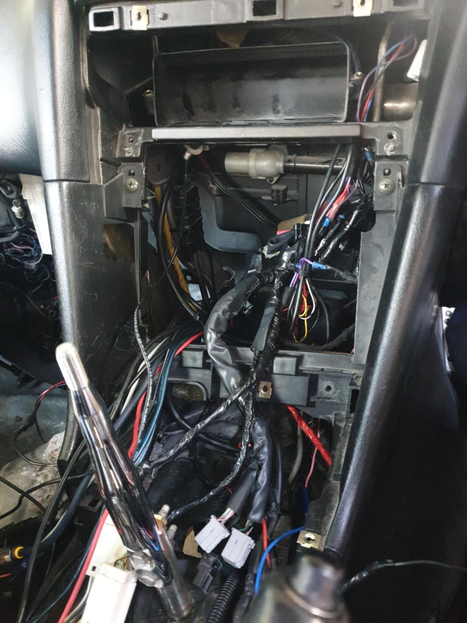

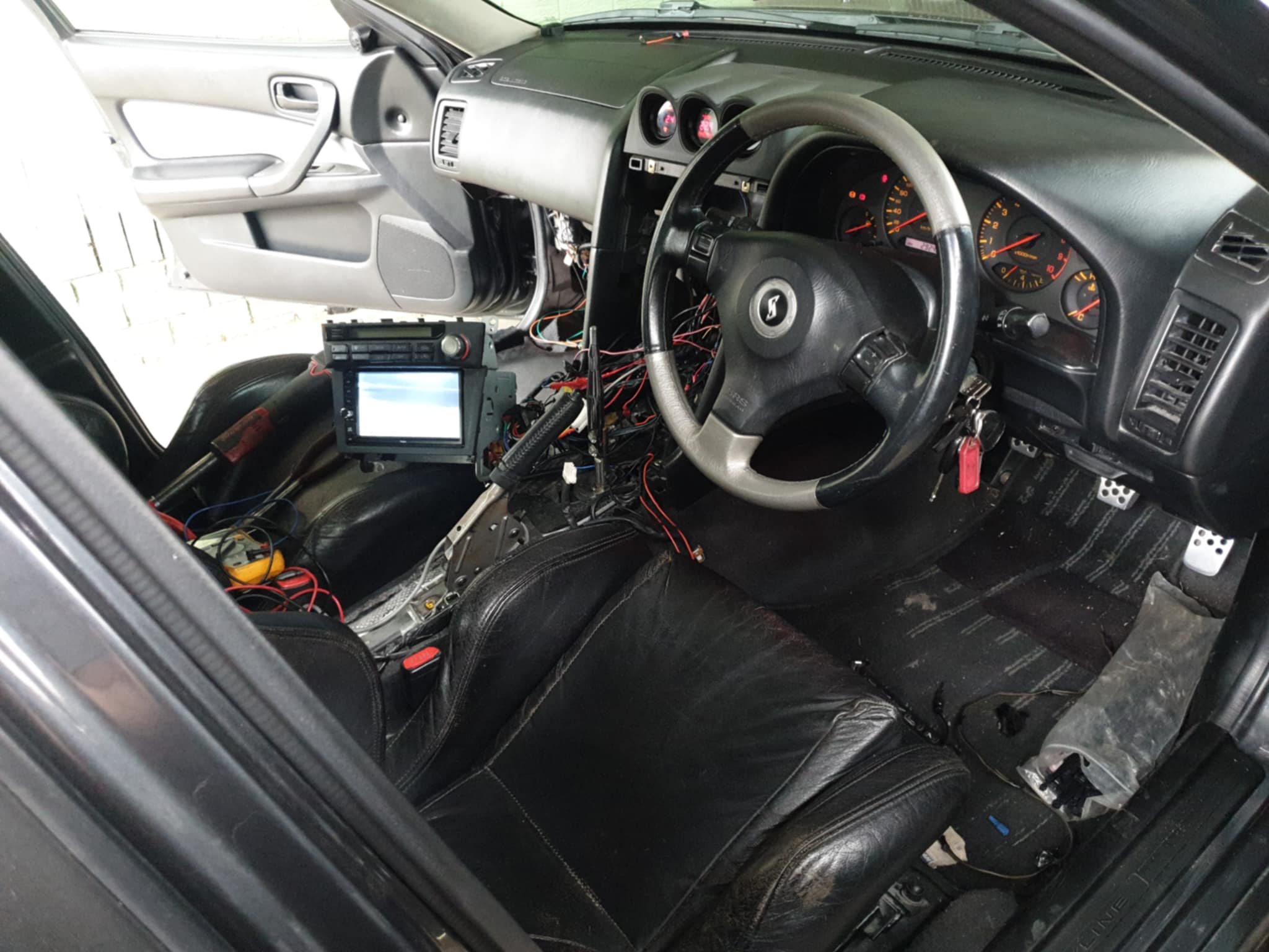

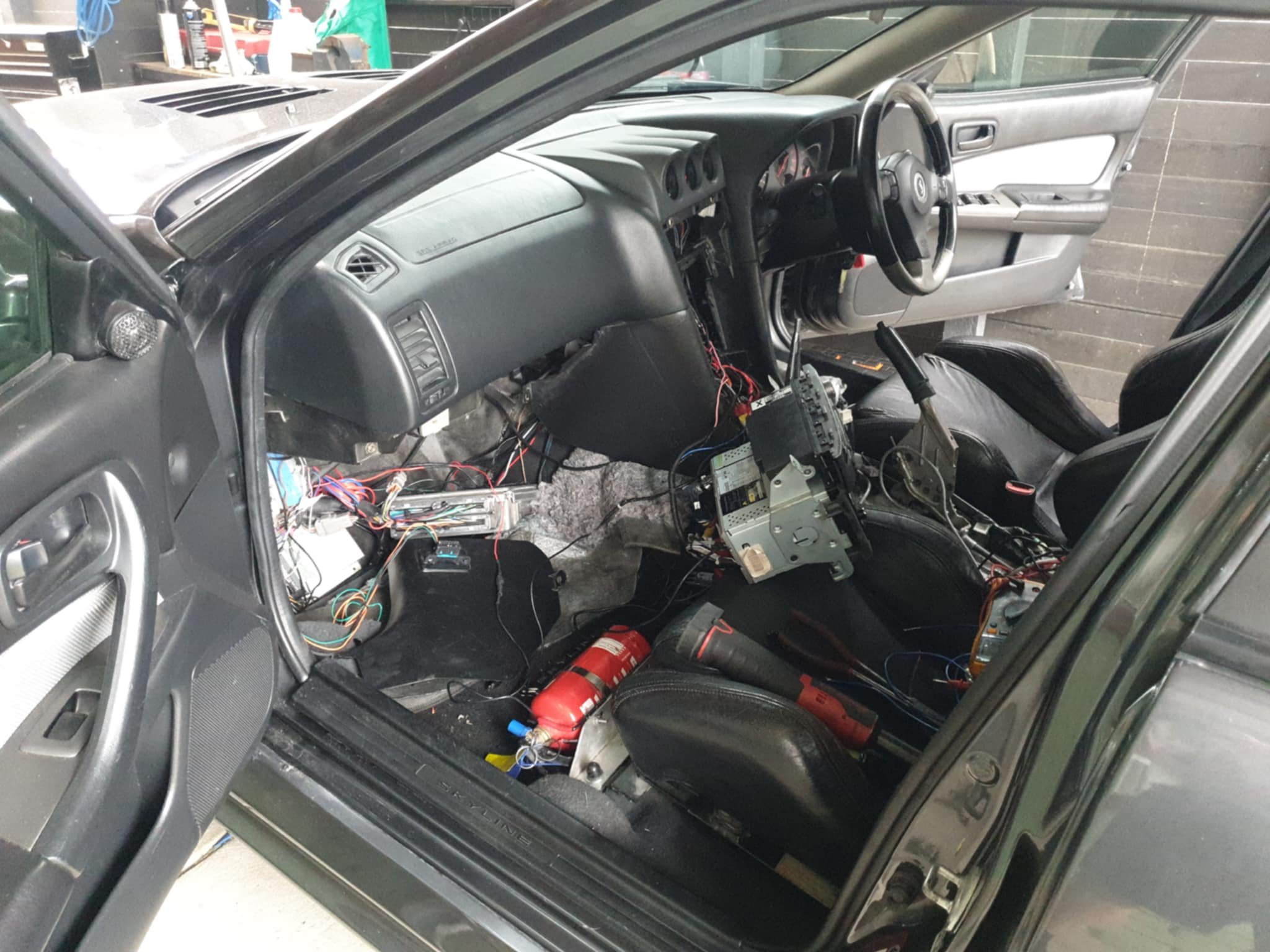

As the guy was reversing I noticed my reverse lights do not operate, along with my reverse cam.
This is a bit distressing, because 100% of guides talk about which wire to connect to backup cams as "the goes with the [other color] wire". Often when doing conversions.
Unfortunately the R34 colour wires aren't documented
Unfortunately I had a T56 Magnum gearbox with it's reverse switch, which also isn't documented.
Unfortunately there's definitely not documentation for people with both of these in the one car.
Unfortunately I forgot.
After many hours of this, I have a reverse cam and reverse lights again.
83b98f60-521f-49a3-aa58-c1839647773c.thumb.jpg.d7024b02c2ebc55f83abd7de8c5f00bd.jpgca08303b-e165-4fd4-ad8f-9779e1f9e47c.thumb.jpg.0098b6708a829e1acc0a03924894d82a.jpg
The wire going through the trans tunnel to the reverse switch had broken. Upon inspection, it looks like this one wire had about 7 spade terminals and extensions in it.. for reasons I cannot possibly comprehend.

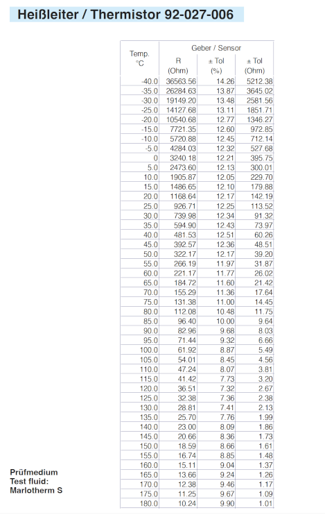

I believe the resistance chart is this
How the f**k do I convert this to a voltage?

So to further complicate things or hopefully explain better:
This is a VDO sensor. It clearly does this math inside the gauge itself... because it displays a temperature in C to me instead of a voltage. The signal wire to the gauge is in Volts, not Ohms.

ChatGPT spat this out:

Yeah, it looks like it's being ran as a constant current setup is my guess.
Get some more data points, reading the degrees C on the gauge, and what the voltage is you're seeing out of it.
The sensor itself is not linear, even in smaller ranges of like 20 - 60 it's non linear. But if we can get some good plots, particularly at those 5volt steps, it will be very easy to work out, and then I can give you a logarithmic formula if its you need an actual formula.
Also, very likely ChatGPT will lead you astray with some of this stuff, as it totally depends on how the circuit is built.
