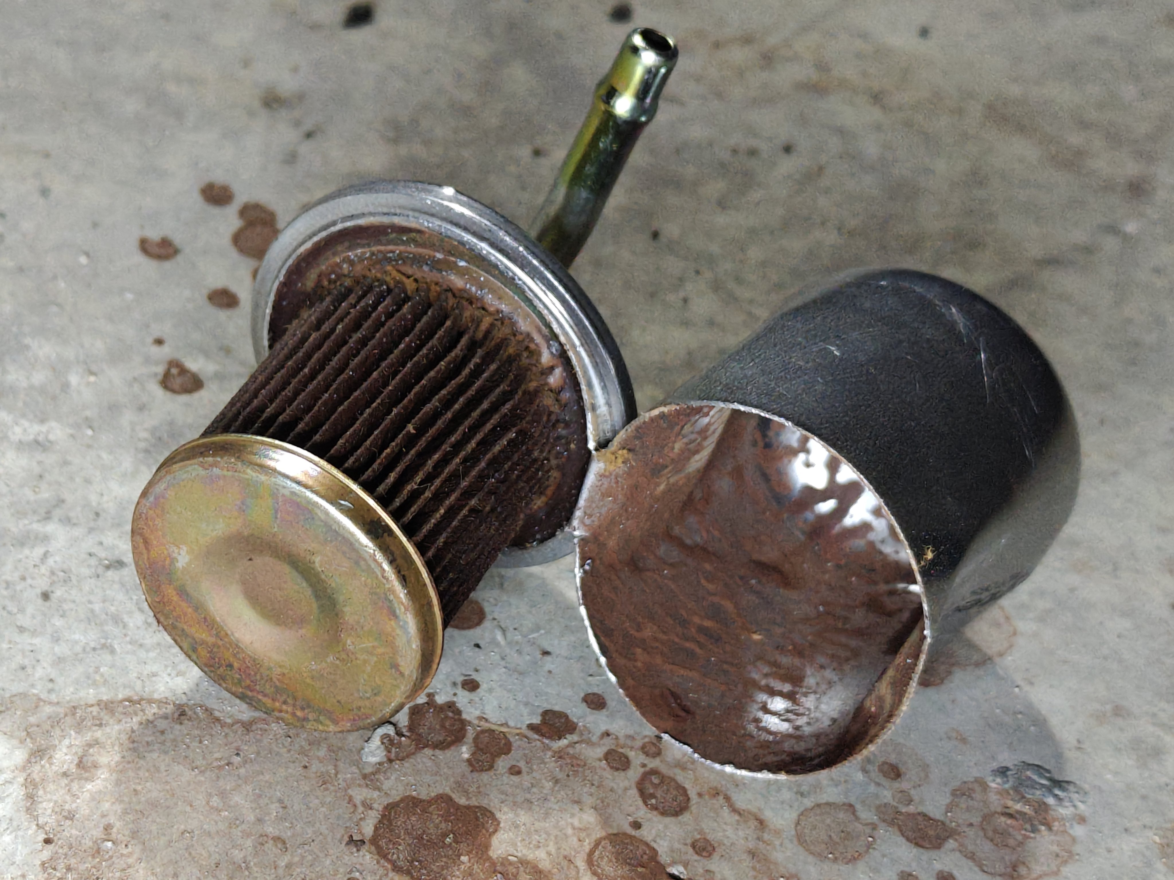

This is what the old fuel filter looked like:

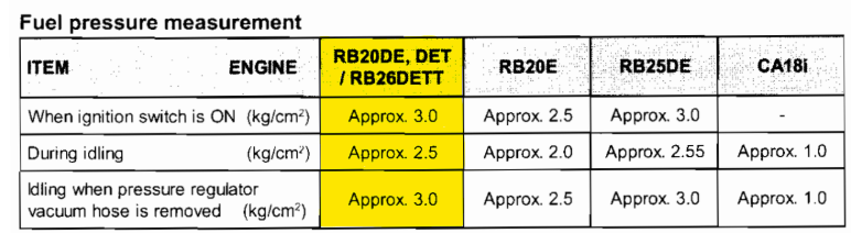

I would put a fuel pressure gauge between the filter and the fuel rail, see if it's maintaining good fuel pressure at idle going up to the point when it stalls. Do you see any strange behavior in commanded fuel leading up to the point when it stalls? You might have to start going through the service manual and doing a long list of sensor tests if it's not the fuel system for whatever reason.
I got ahold of a fuel pressure gauge and did just that. The pressure is strong and stable, even to the point of stalling. 3.0 bar on ignition, 2.5 bar on idle, 3.0 bar on idle with FPR vacuum removed.
It idled for longer with the FPR vacuum removed but eventually still stalled. Then I tried one final time and revving was also just cutting up – I now assume that the plugs are fouled again.

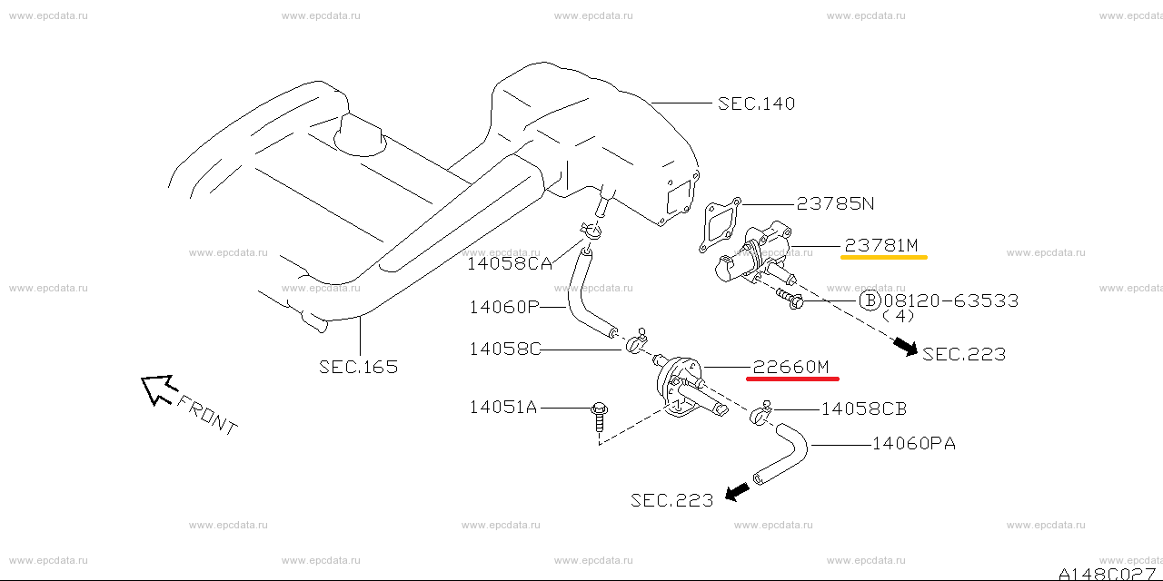

On 24/08/2025 at 8:10 AM, MBS206 said:
Find out what RPM it was idling at with the IACV unplugged.
It's very weird that the rpm didn't change at all, and then it stalled.
My bad, I unplugged the one underlined in red instead of yellow before.
With the car started, after unplugging the IACV (the one underlined in yellow), it idled at around 400/500 for 3 seconds before stalling. Attempting to start the car without the IACV will not start the car.
