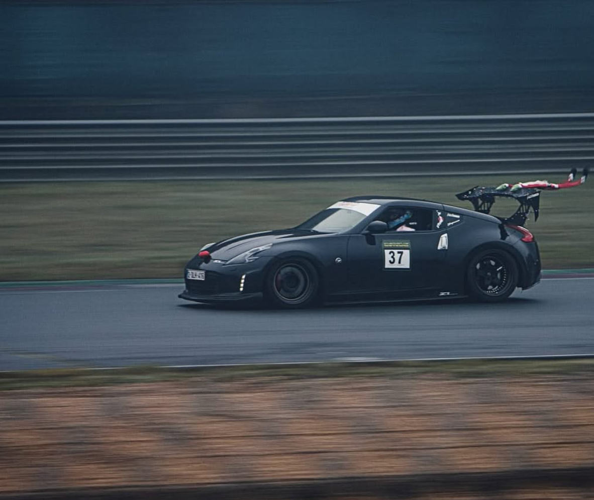

Hello,
My name if Frederick, i'm 30 years old and I live in Belgium, Europe!
I used to have a Nissan 370z daily but since I got a company car I turned that into my seattime driftcar.
About 3 years ago I also wanted something older with more feel, so I got an R32 GTST with an rb26 engine.
I am now getting the rb built to have around 800hp and it's close to being finished.
I'm very excited for how it will drive and how driveable it will be!
Regards,
Fred!

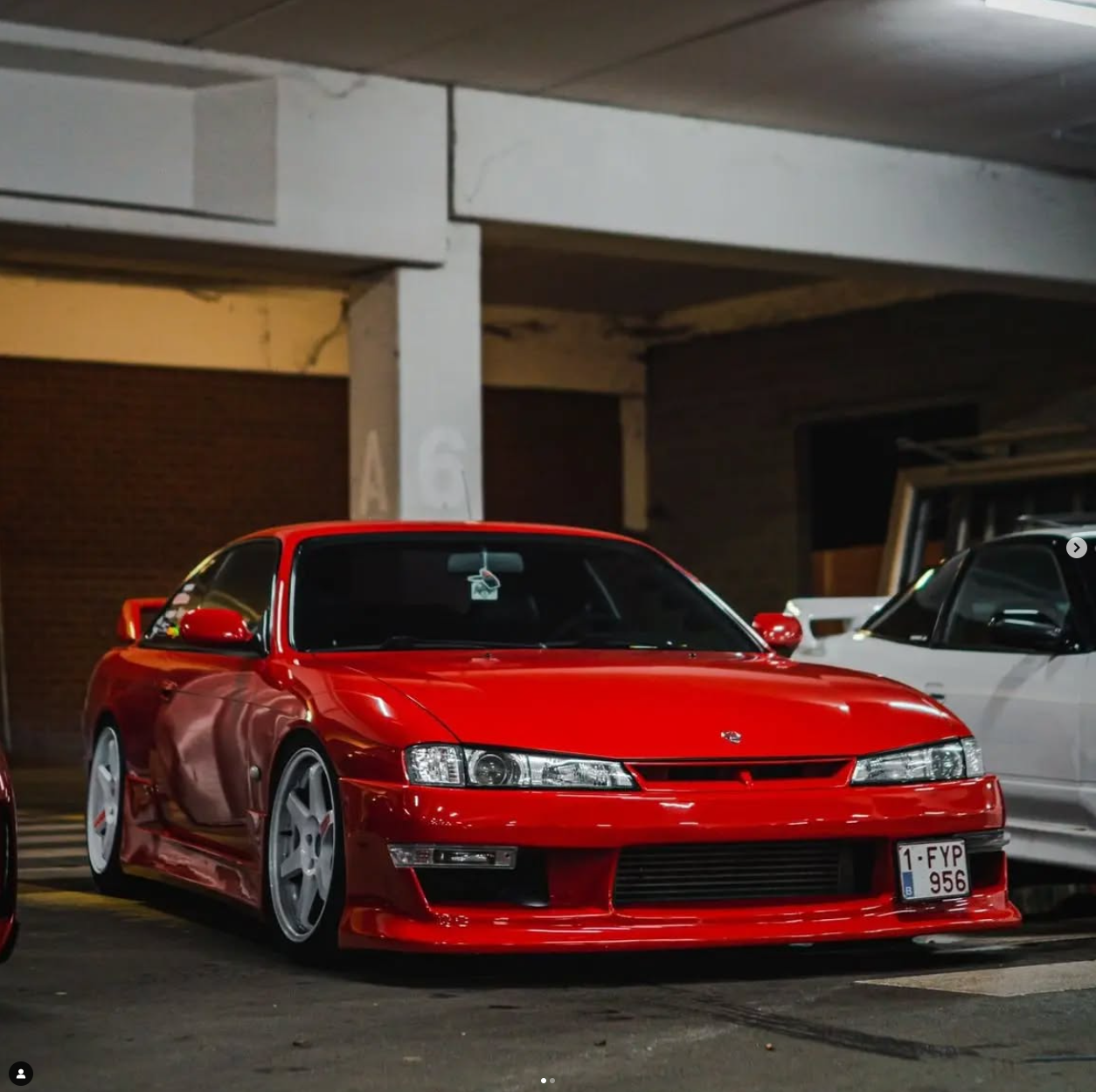

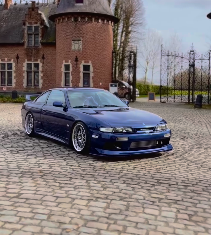

Hope you had a great time here in our tiny country. :)
The JDM scene we have here is quite small, it's mostly BMW, Volkswagen with burble tunes haha.
But the few JDM cars we do have in the scene are pretty nice. Some of my friends drive cool s14's too. :)
Both built engines, red one makes abt 500, blue one abt 400 i think?
