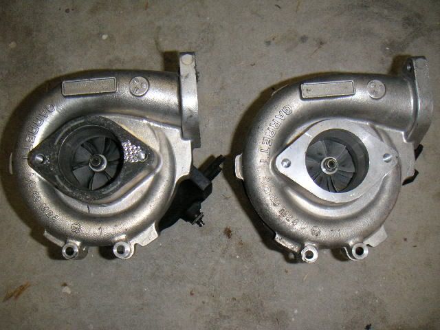

Someone has offered to sell me these turbos:
Group A N1.....the code is something like 14411-06U-00
R34 V Spec II
AR 60-64
5 degree cut rear wheel
360 degree thrust bearing
Steel wheels
Is there some way i can verify that they are of an R34 VSPEC II?
They've done low kms and look to be in great nick.
He's saying he wants $1000 bux.......good price?
Also, how will installing these turbos on my standard R32 GTR improve performance? It has nothing, except for Apexi airfilters and a full exhaust system.
Cheers,
Ali

part# for 34N1`S are 14411-AA403
14411-06U00 are R32 nismo
https://www.sau.com.au/forums/topic/83853-r34-n1-turbos/#findComment-1518357
From what i understand the N1 turbo's have a slightley larger turbine blade than stock giveing a small power improvement for the same rough amount of boost. Of course the main bennefit is that the turbo blades are steel, instead of the stock ceramic ones. This means better reliability and the ability to run more boost than the stock turbos.
The N1 turbo's were designed by Nismo for competition use, offering the best trade in their opinion between response and power. Their the best option for the price for track GTR's, road/race GTR's and fast street GTR's. The spool up time is almost identical to stock, but you can also run boost levels up to 1.3-1.5 bar without fear, unlike the stock ceramic ones.
With the appropriate other mods, Exhaust/IC/Fuel System/ECU and 1.4Bar ive seen a few GTR's make anything between 260KW-330KW at the wheels, depending on tune and dyno.
For $1000 id say they were a good buy.

OK bit of confusion, the code hes given matches R32 nismo code, but he reckons that the paperwork is in fact of an R34? Anyways....

this turbo 100% not R34 N1 turbo,couse R34 N1 turbo got separate wagste at back of turbo and R34 V-spec2 use same turbo as R34GTR,no any different.hope it wil help.
the one you got more than likely are R32 N1.not Nismo turbo.
couse Nismo turbo's code are RR580 or RR581.
just to ad to the confusion
https://www.sau.com.au/forums/topic/83853-r34-n1-turbos/#findComment-1520144

LoL....that pic with the code saying its nismo has confused me now......so are they normal n1 or nismo n1.....or what not.....:S
https://www.sau.com.au/forums/topic/83853-r34-n1-turbos/#findComment-1520151
I thiink they were called Nismo on the R32.
