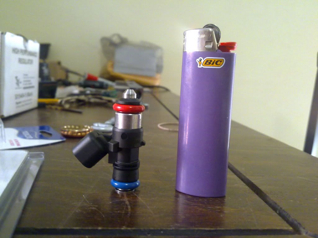

02022012395.jpg Cute litte buggers hey....These are a 40mm length injector almost identical to ID injectors..they're also available in 2000cc but if you need injectors this big your probably not running the stock plenum anymore
ID injectors (1000cc and 2000cc) are 48mm when you take the extension of them and would probably fit as well, I am waiting for someone to confirm this though as Im yet to see it done..It is a very tight fit mainly due to the hose plumbed in underneath the back of the plenum..But I'm fairly confident an extra 8mm would squeeze in there..if not it is possible to machine down the manifold spacers for a little extra room..
Your looking at about 600 to 700$ for injectors

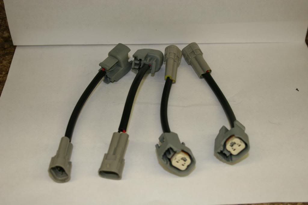

you will need the correct plug adapters to suit..these are relatively inexpensive and you injector supplier might even throw them in if you ask nicely..you will need to wire these into your loom..pretty easy only 2 wires and it doesnt matter which way they go..Aternatively you can get plugin adapters, they look something like this and simply plugin..

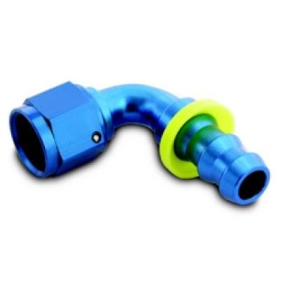

You will need at least 1 90 degree -6 or larger fitting for the back of the fuel rail, looks like this
your fuel rail kit will probably come with a straight through fitting which wont work..
you may also need other -6 fittings for the fuel return bottom of the reg..I was advised not to put a 90 degree bend here as fuel needs to be able to exit the reg as quickly as possibly to maintain proper pressure. However a 45 degree should be fine..I used a straight fitting and it nearly fouls on me manifold which is not ideal..
you will need hose clamps, at least 4...ask for proper fuel injection hose clamps they are much better than regular ones..Only 1 or 2$ each depending where you get them..
^^^^The one on the left is the one you want ^^^^

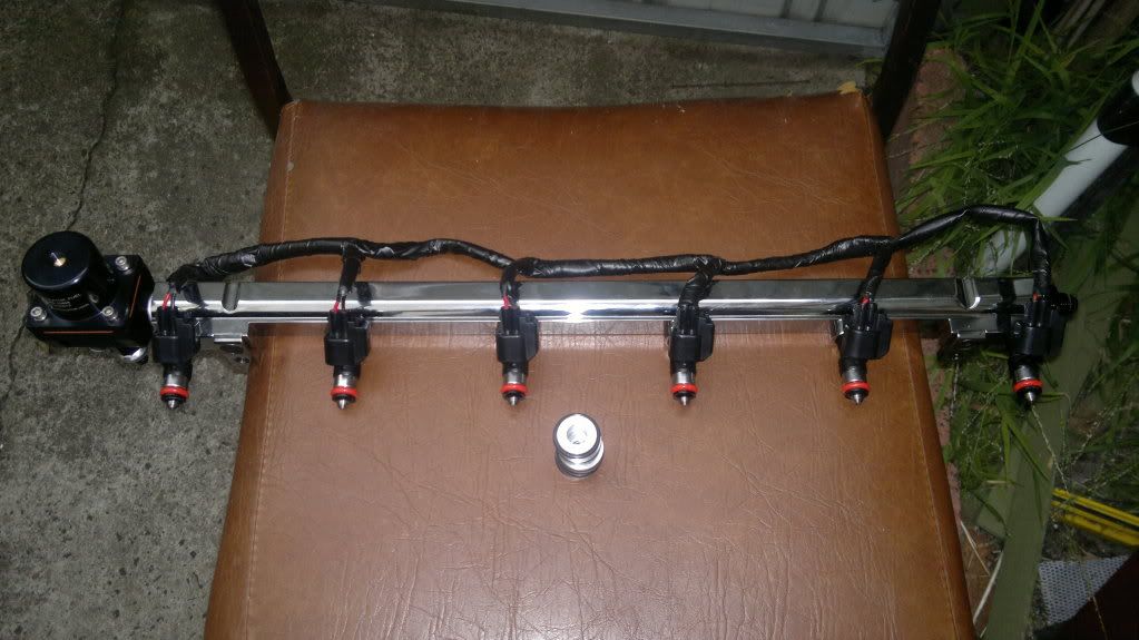

Once you have it all you will need your new rail ready to go, It should look something like this
Some things to note,
NB..always use some lube when inserting injectors into rail, WD40 is fine, to make sure the o-rings dont grab and twist out of shape..Also there is no need to use any sealant on the fittings An fittings will seal when tightened, helps to spray a little lube on them as well..
NB.. I attached my reg at the end of the rail in the original location..you do not have to do it this way..the reg can just as easily be placed anywhere in the engine bay you choose and joined to the rail via a hose..this may require some additional fittings..
Hot Tip..attach a lenght of fuel hose to the back end of the rail now as it will be near impossible to do once the rail is in

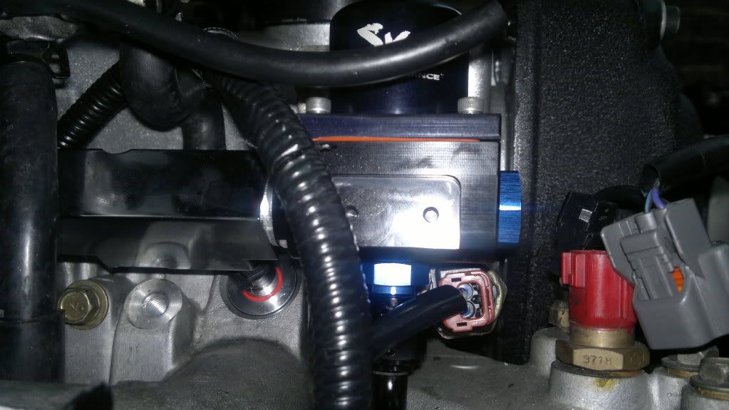

I broke this plug the first time when doin mine as the reg hit against it
as you can see its very close but by twisting the reg a little I got it to fit..
So yeah, Take care ...:)

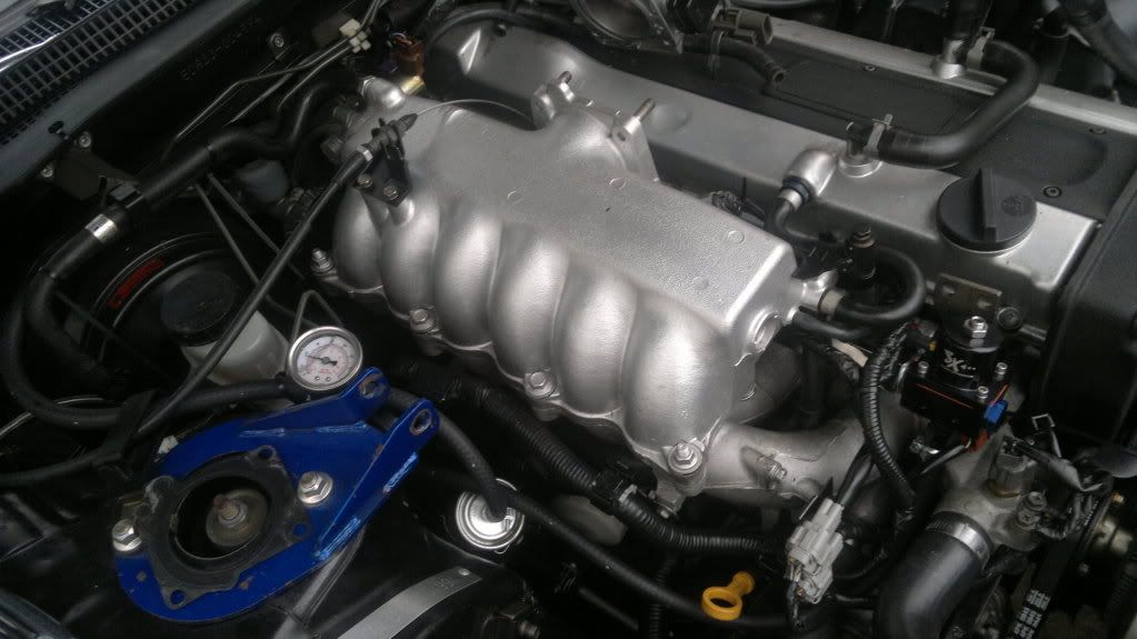

now to attach some hoses...heres an image of my layout..
Now as you can see the hose from the fuel filter runs up around the back to the rail, I put the gauge in this line.
You can also attach the gauge to your the auxillary port in your fuel reg, the choice is yours but you CANNOT place it in the return line..make sure all hoses are tied up and clear of anything that may get hot..the last thing you want is a melted fuel line = FIRE!!! :devil:
Then run a fuel hose from the bottom of your regulator to the dampner...
Attach the small vacumn line to the regulator and cable tie..
