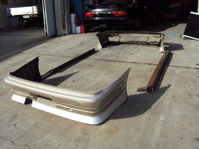

Bought a body kit from JDM Garage:
The side skirts didn't come with it though so i thought id find some to match later down the track as this "Grace" body kit seems to be quite rare.

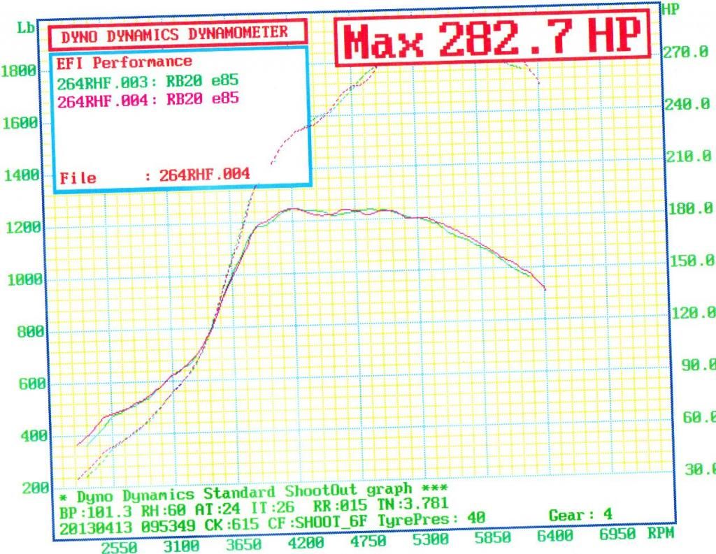

Kept it untuned for a while as money was tight so a few months later got it tuned:
Finally got it tuned with E85 but the GTR injectors ended up maxing out at 210 kw at about 17 PSI. Cam gears were suspected to be adjusted a little on install. Didn't bother adjusting them as injectors were maxed out anyway so after i get bigger injectors ill go more boost and adjust the cam gears. Also the ECU has boost control so i might use that instead of a T piece.
Big thanks to Ben M1 Tuning (If you need a tune on the Gold Coast or Bris here is his facebook http://www.facebook.com/ben.phillips.7311?fref=ts) for tuning the car, very happy with how it turned out and how it drives.

2510 with my 4.3 diff is good. Feels like its always on boost. It feels pretty progressive too its not like nothing nothing ON its smooth and if i adjusted the cam gears i could've kept the power going for longer. On 98 they seem to max out around the 210ish kw mark but when i retune it with bigger injectors, adjust cam timing and tune a little i hope it gets a bit more.

figure the only reason the gtr injectors are maxing out is because your running e85, usually with gtr injectors you would see 230+ on 98 before they max out.
also make sure you've done the fuel pump direct rewire mod for more voltage
Edited by Dan_J
as Dan_J said zac, its most likely the e85,
Usually people double their injector size when going to e85. Maybe not quite double but if they had 550's /600's they go to like 1000cc/1200cc injctors
