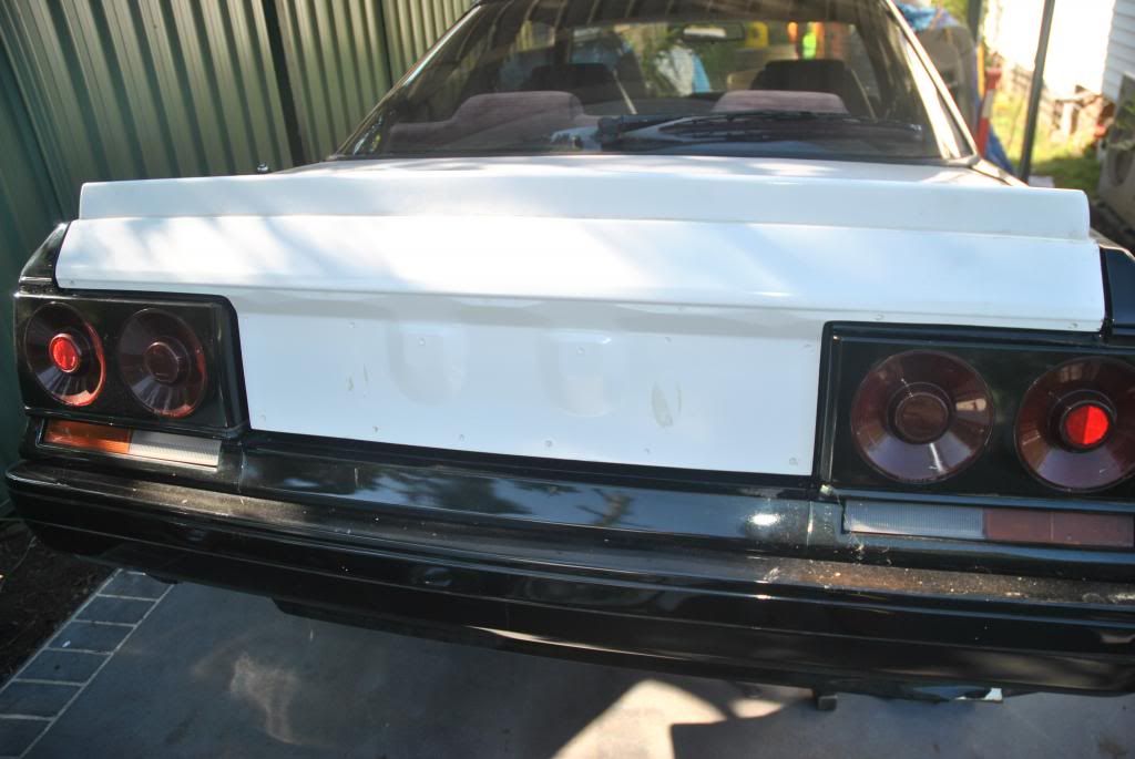

fiberglass boot with n1 lip
i should have the front guards back soon

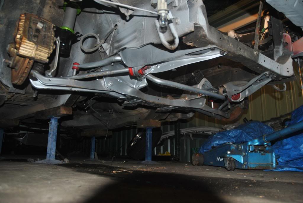

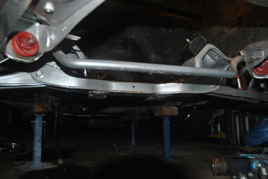

randys old rear end
new rear end, has been modified to make it faster

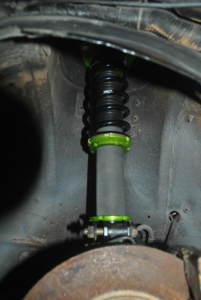

new struts

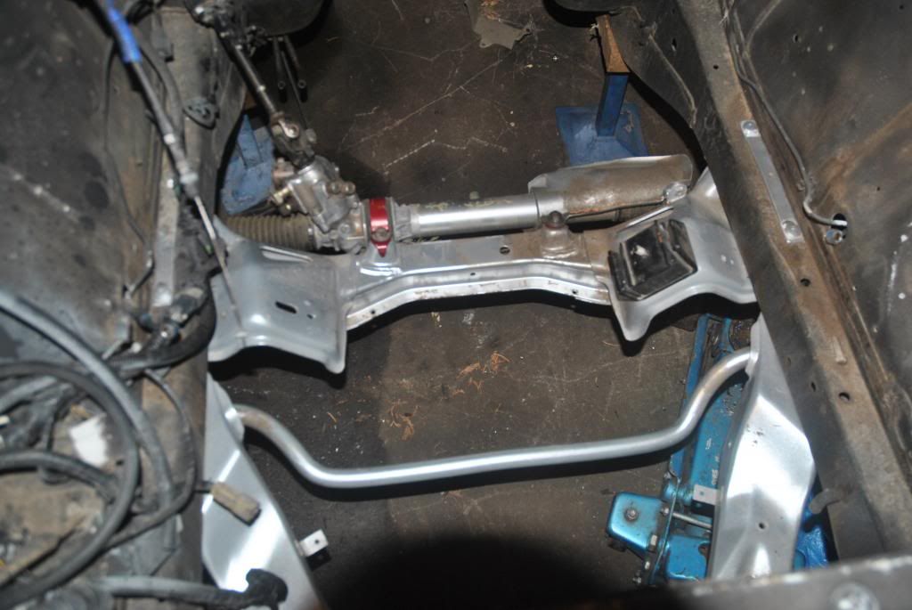

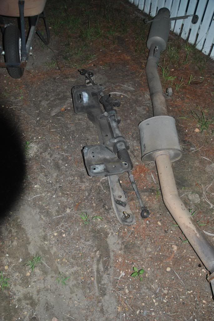

old ghay arse 8 port hr31 rack out
http://i236.photobucket.com/albums/ff9/fatzgtsr/r31%20coupe/DSC_0075_zps3216550b.jpg
new flashy( least now i can see the oil leaks)

new front struts
http://i236.photobucket.com/albums/ff9/fatzgtsr/r31%20coupe/DSC_0070_zps2c9dc665.jpg

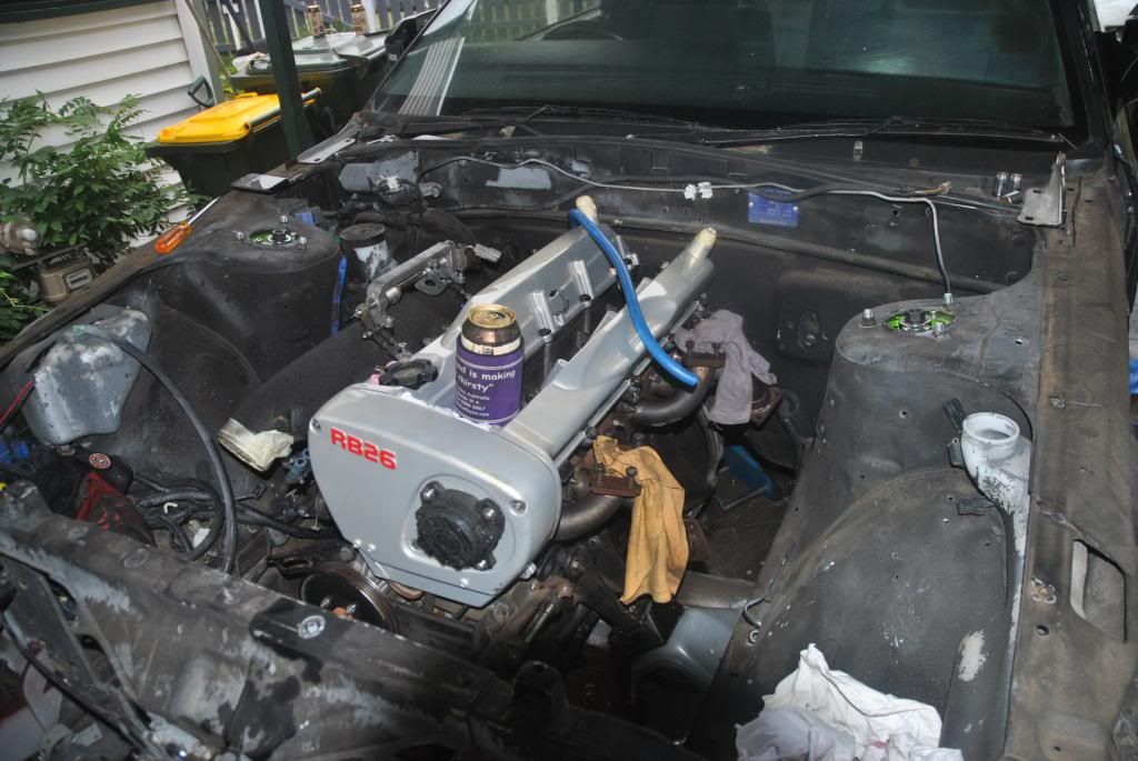

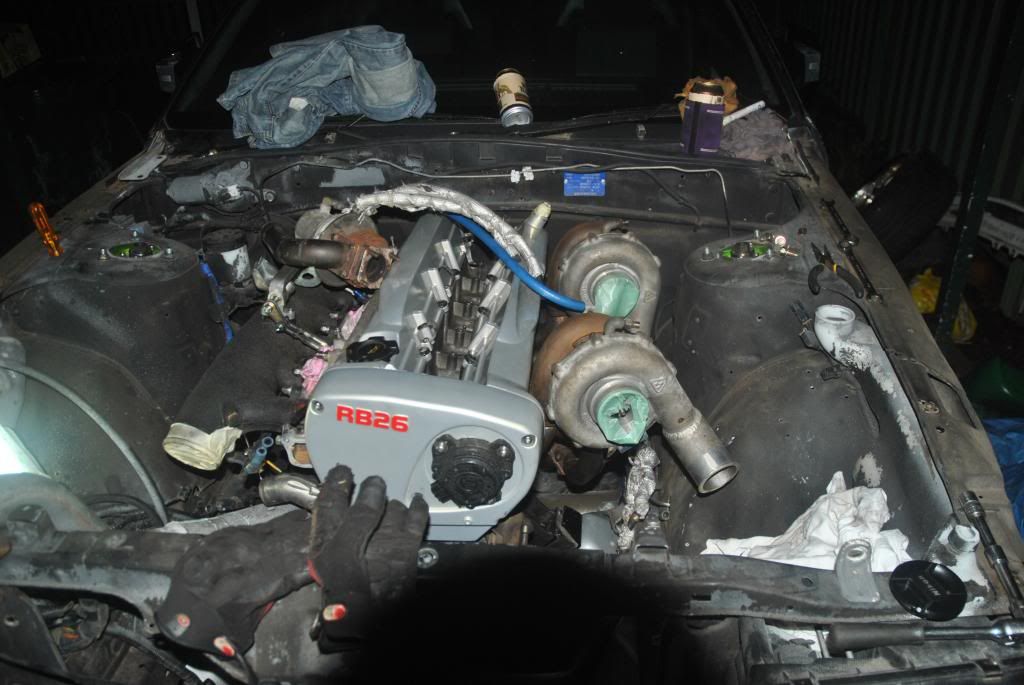

so some more progress

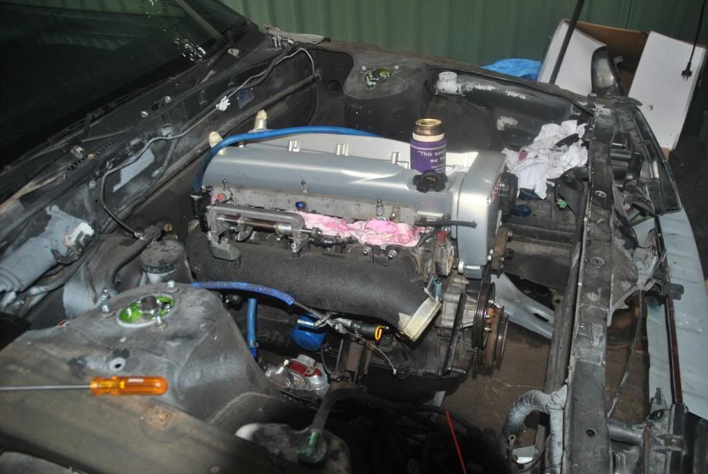

dummy fitted the engine box and turbos
to do so had to pull the turbos off
http://i236.photobucket.com/albums/ff9/fatzgtsr/r31%20coupe/DSC_0076_zps5112a893.jpg
then slapped the motor and box in
http://i236.photobucket.com/albums/ff9/fatzgtsr/r31%20coupe/DSC_0080_zps45acdff0.jpg
http://i236.photobucket.com/albums/ff9/fatzgtsr/r31%20coupe/DSC_0079_zps420e163e.jpg
turbos were fine
front dump pipe was fine
rear dump pipe fowled on the firewall at the expansion joint, was expected as the 3 litre is 1 inch taller and it just touches.
will give it a massage
besides that r31 are heaps larger than gtrs so there was a fair bit of room to move
new front struts

i also got out my pwr radiator with inbuilt oil cooler, its farken expensive so naturally it did not fit lol, close but no cigar( will have to re-drill the upper mounts)
also dummy mounted the ic using the gtr mounts ( slightly modified)
they are not centered so will have to make something up and shift it left about 2 inches to center it
will also need additional bracing as its a big f**ker
