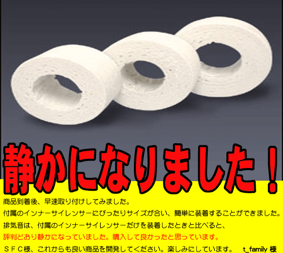

ordered SIS090 today with special sound absorbing cotton ring to reduce the drony.
NIS001 is 135mm length, SIS090 is 220mm. i would like to cut 85mm on SIS090, this could make the exhaust air go into the small room then out to atm, like a smaller muffler.
Edited by YangLIU
Yeah i dont understand the need for the cotton donut....
The silencer works as the exhaust gasses now exit further towards the rear of the muffler thus less space for noise?
Wow. That cotton ring will do shit all. As will your small gap plan
I'm betting on it. 5 bucks. Cash.
here is a video for that cotton ring. not sure if it is sure.
