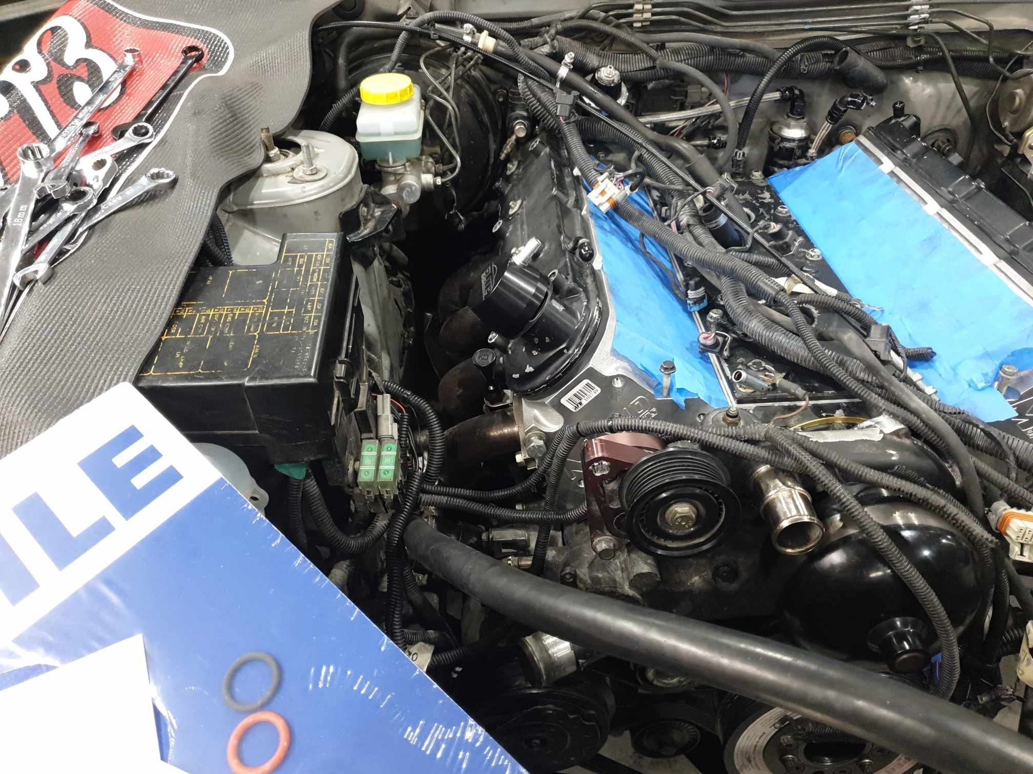

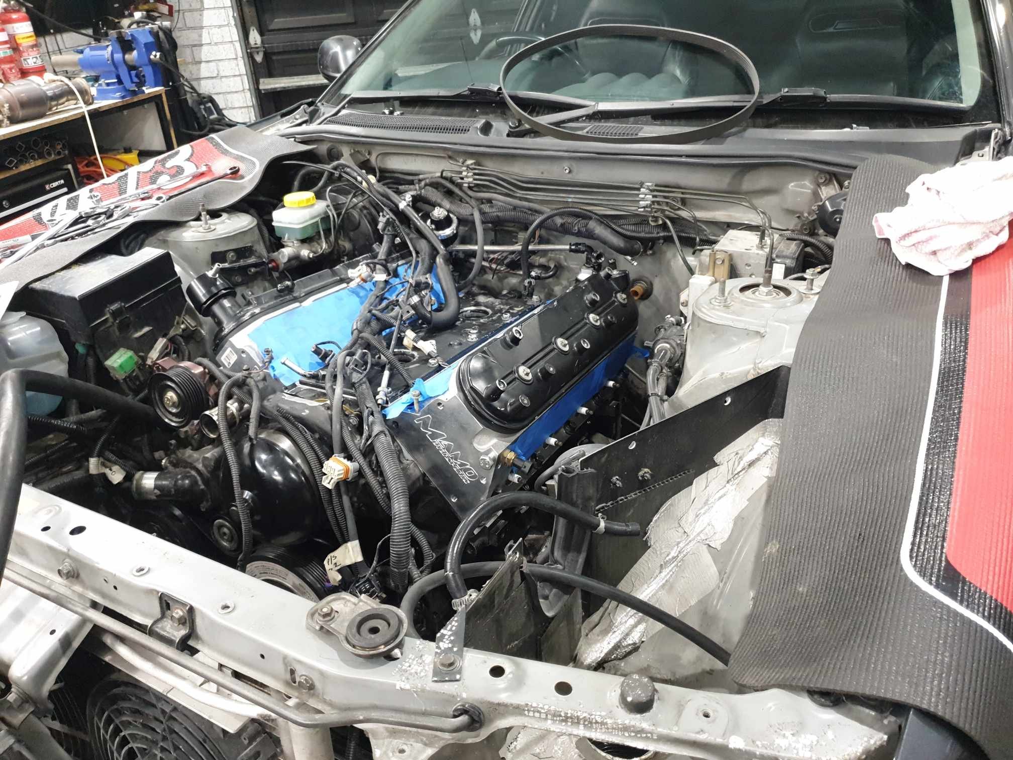

488187041_991353296523877_865422083166730912_n.thumb.jpg.bb2a5999335bed4a8305363fb6eb1c8b.jpg486353497_535933245841069_4695779592493430602_n.thumb.jpg.cba94d4f5c4827341d5e737181f05453.jpg
Bellhousing bolts done up, driver side manifold is on, AC Compressor and hard lines are back on the car.
Next step will be to connect various engine bits/wiring/intake/radiator etc. Then oil and coolant and ... test start it?

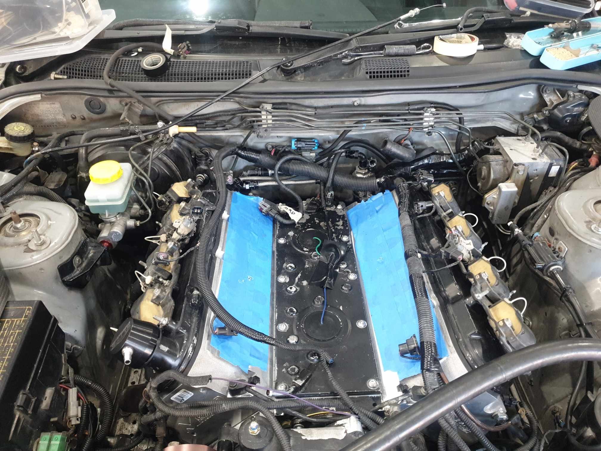

The FAST manifold is a little larger than the stocker. This is problematic because there really wasn't much clearance to begin with, so going from 'barely enough' well into 'no' is sad based on the external dimensions of the thing, even though where it bolts to the head is the same.
Result is the fuel rails sit a good 25mm higher, and this is a bit of an issue with the wiring that runs behind the motor, and the fuel lines, and everything else.
When pushing the manifold on, it required a huge amount of force to crush wiring looms to fit it, sensors like the MAP sensor are about 1mm from the firewall, and the FPR just has to bend ABS lines to be forced into place. After some brainstorming and some sad drinking, the loom for some reason ran from the grommet behind the ABS sensor, then to the driver side head, then back to the passenger side head.
So all of this was pulled back and stripped, a few wires cut and rejoined, so that the 'branch' was now on the passenger side's head as below:
Before you basically couldn't see anything behind the driver head. This is much improved!
The MAP sensor is now pointing up (instead of at the firewall)

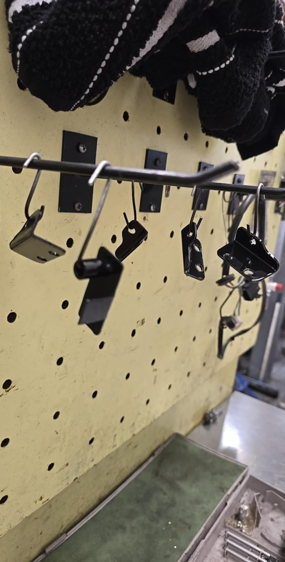

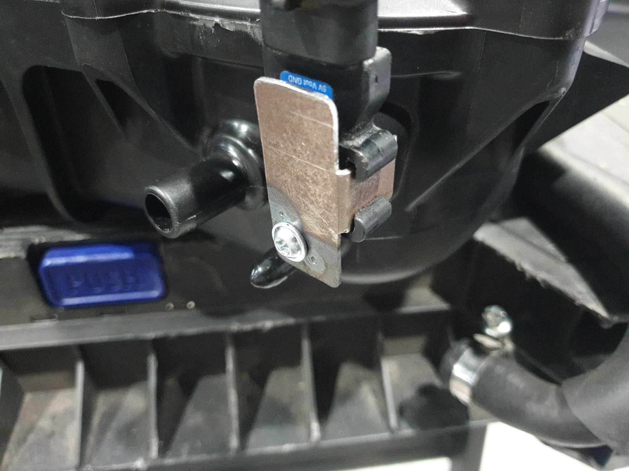

Brackets have been made up for the rail. The rails are for a LS1, the manifold is designed around a LS2 as it's base. Which of course has slightly different bracketry and water pump clearance, hence the mods people need to do.

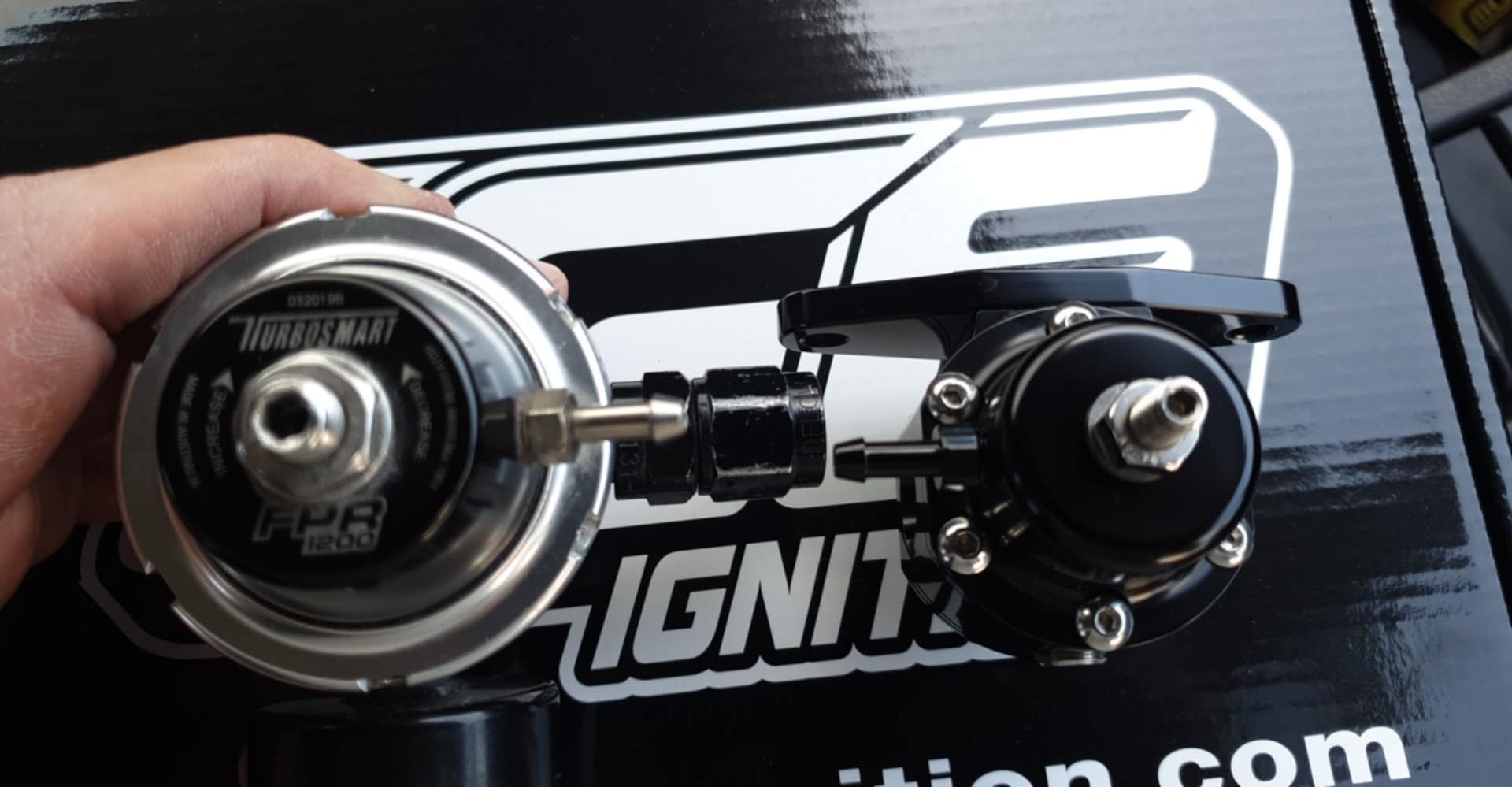

Should be hopefully mounted tonight. I spent money on a new FPR that is slightly more compact than my Turbosmart FPR1200.
The gauge has also been moved to the rail. There's also apparently an ORB to AN Union instead of the adapter, because the ~25mm of the current adapter is going to make the difference.

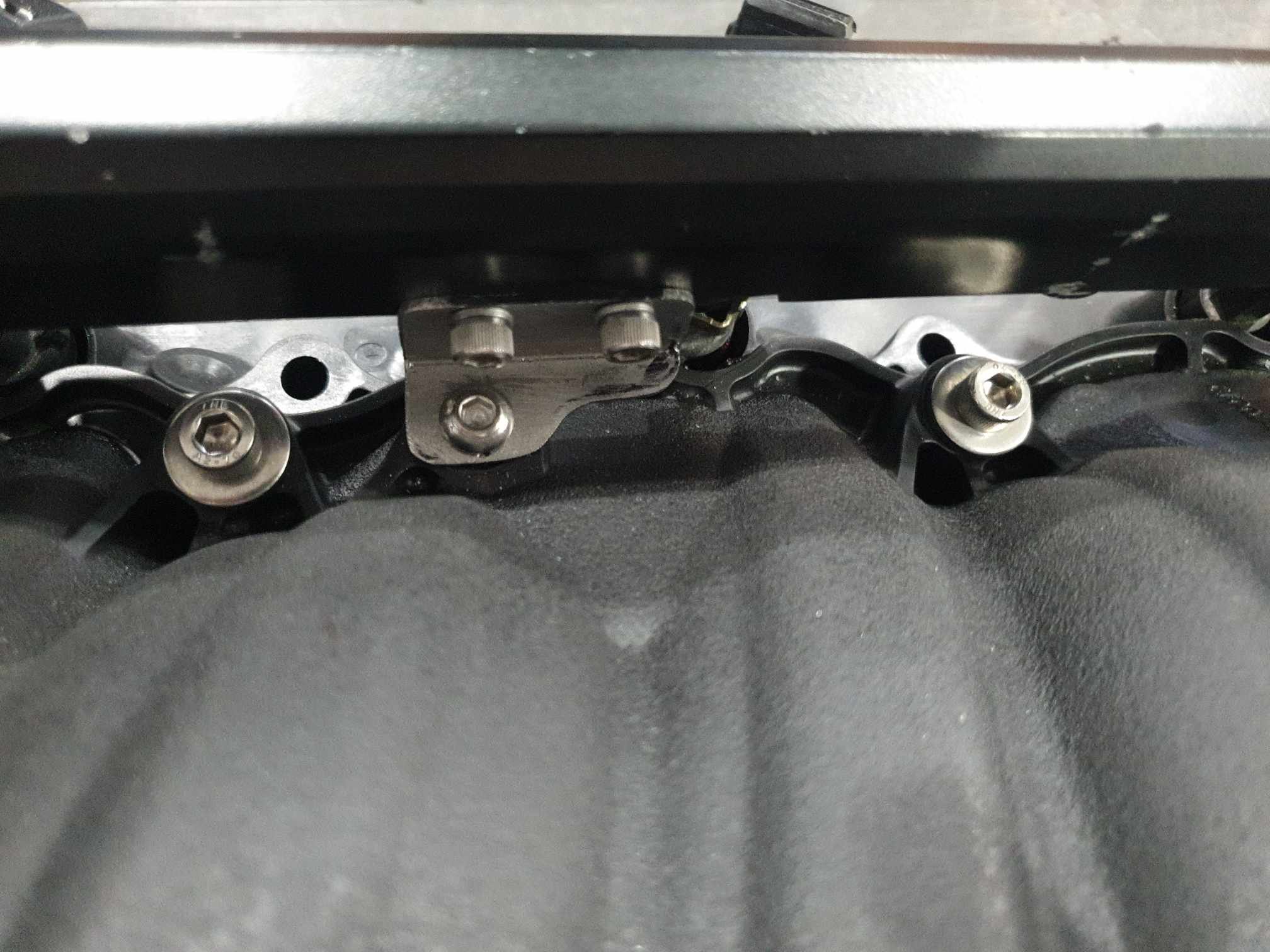

The old manifold was quite under the GTR strut brace.
The new manifold is quite [unknown] the GTR strut brace.
The GTR strut brace was needed to clear the bonnet vents.
The Old strut brace will almost certainly clear the new manifold, but not the bonnet vents.
The old strut brace will almost certainly clear the new manifold, and the new bonnet without vents.
But I am hoping the GTR strut brace clears the new manifold :p

The GTR strut brace clears the new manifold.. by about 0.5mm.
So this means I need to buy an OEM GTT Strut brace (again), which will clear the new manifold, but not the bonnet vents. I guess I can sell the GTR Strut brace with the bonnet with the vents as a package deal as someone will need this one day.
So my choices are vented bonnet but no strut brace, or GTR Bonnet with OEM brace (which I have to buy) but is bright red instead of the same colour as the rest of the car, which means the entire front end of the car will just be red until it goes back to paint jail.

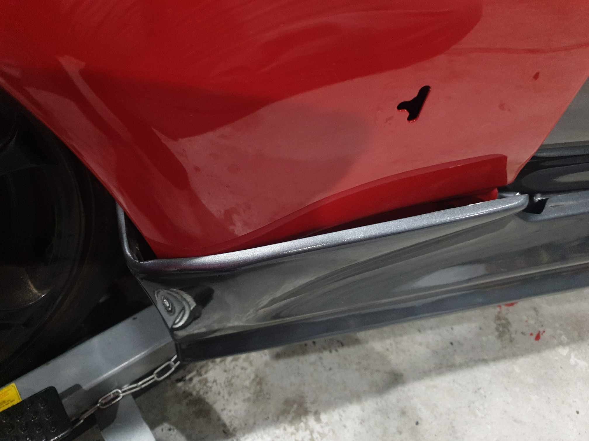

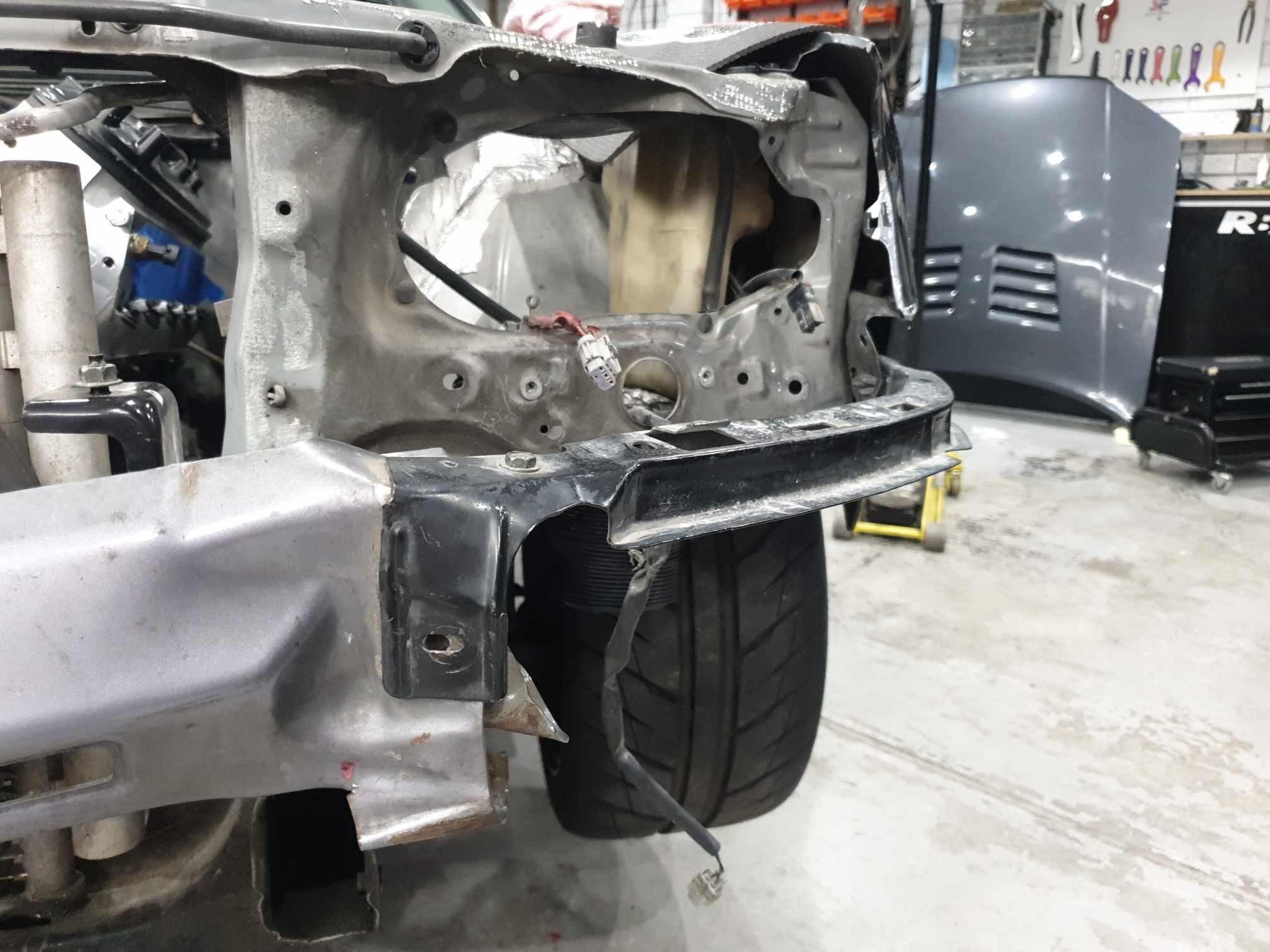

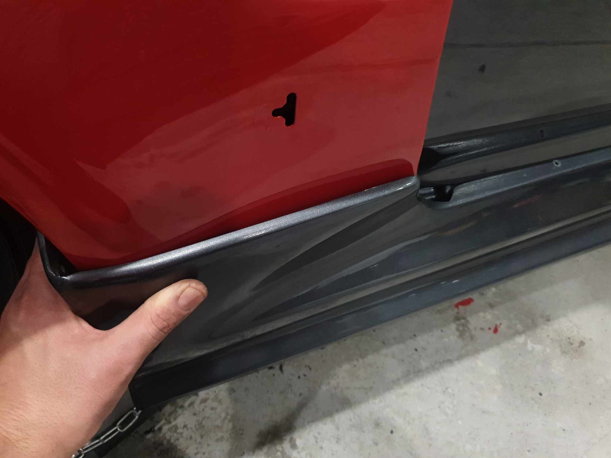

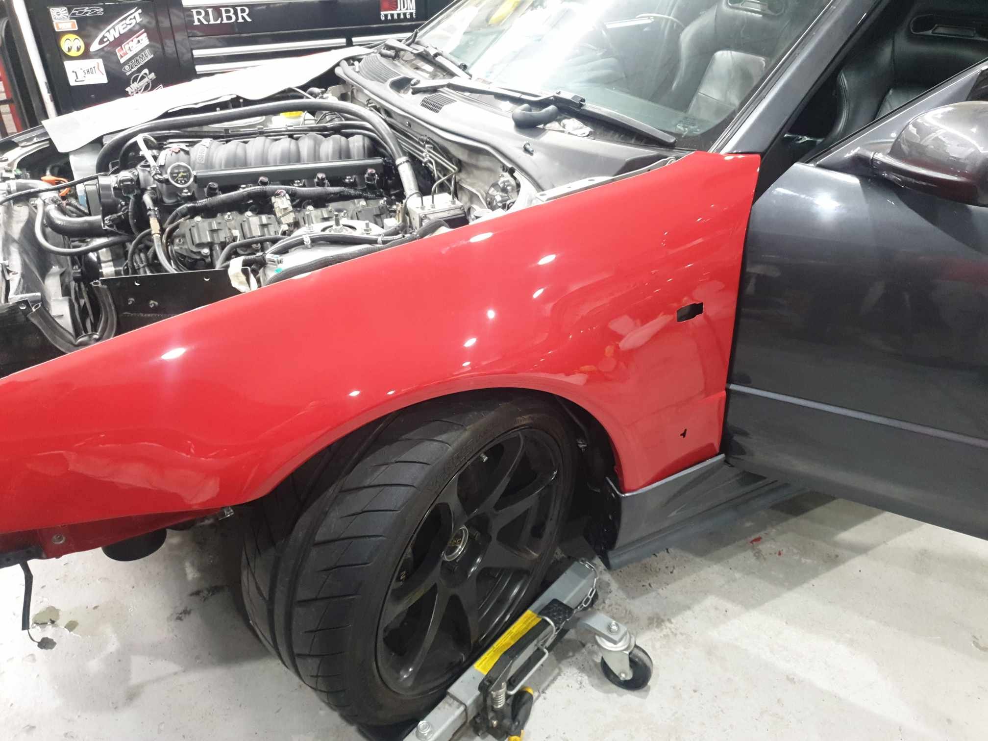

491003844_994580856114253_6161370987884605823_n.thumb.jpg.57223c562d09f50f5168e72ee2961cdc.jpg490997180_1222109089478912_7663178205040388476_n.thumb.jpg.9000bbbfd5b67f1213c99316ec1e5431.jpg490986117_1185606749672057_3052965393335818268_n.thumb.jpg.9c5668331e3319a8295b4489e4dac25f.jpg
The good news is.. using MR HAMMER it was actually pretty easy to bend back the bent bits to make sure the guard and headlight/new headlight tabs line up right. Yes, we used a R34 GTR guard to make sure the bolt holes all lined up with a known straight guard.
As above, you can see the side skirt and the GTR guard are not meant to play together, but everyone seems to think this is a simple fix to the point where nobody who has had these talk to one another mentions how...
...so I'll just assume they know how to fix it when it comes to paint jail time again. Whoever they are. Nobody returns my calls.
