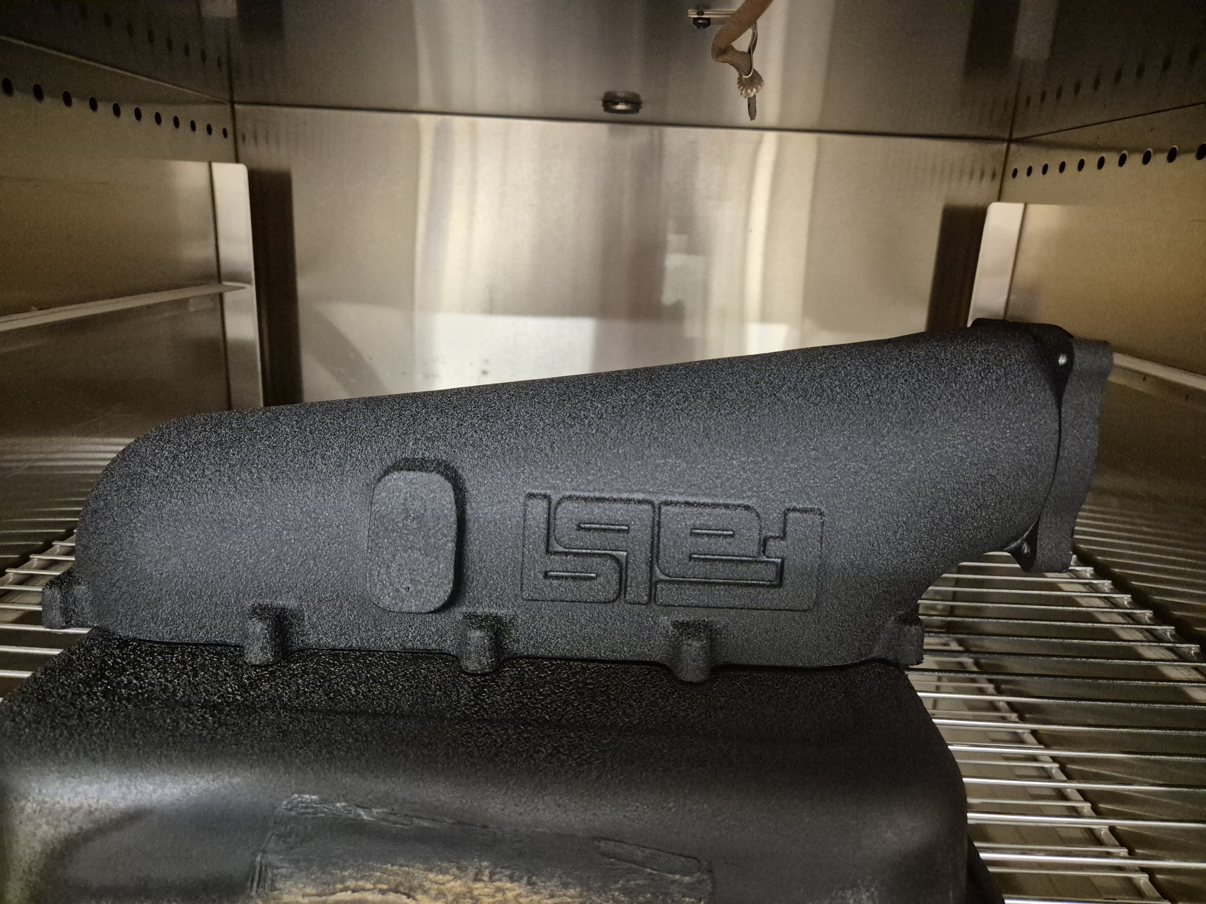

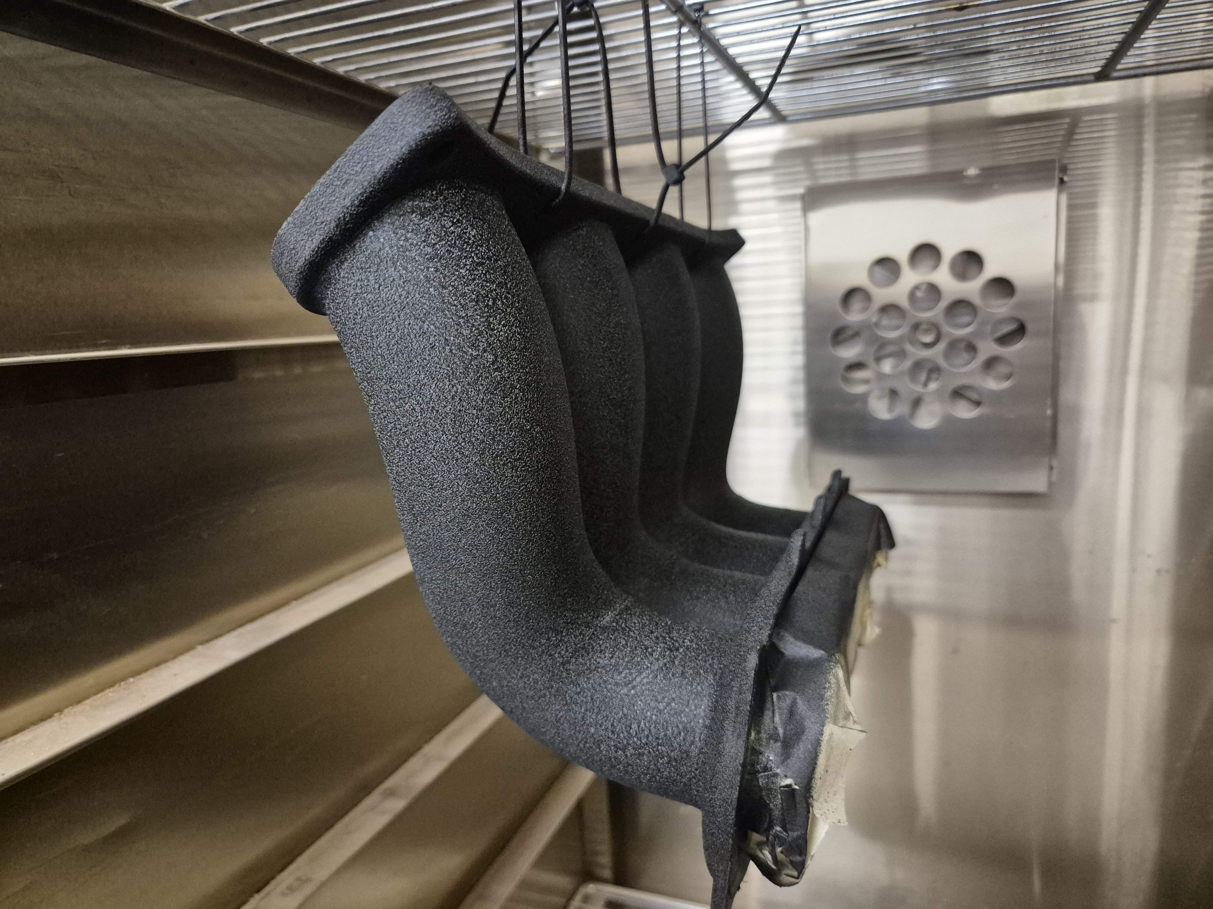

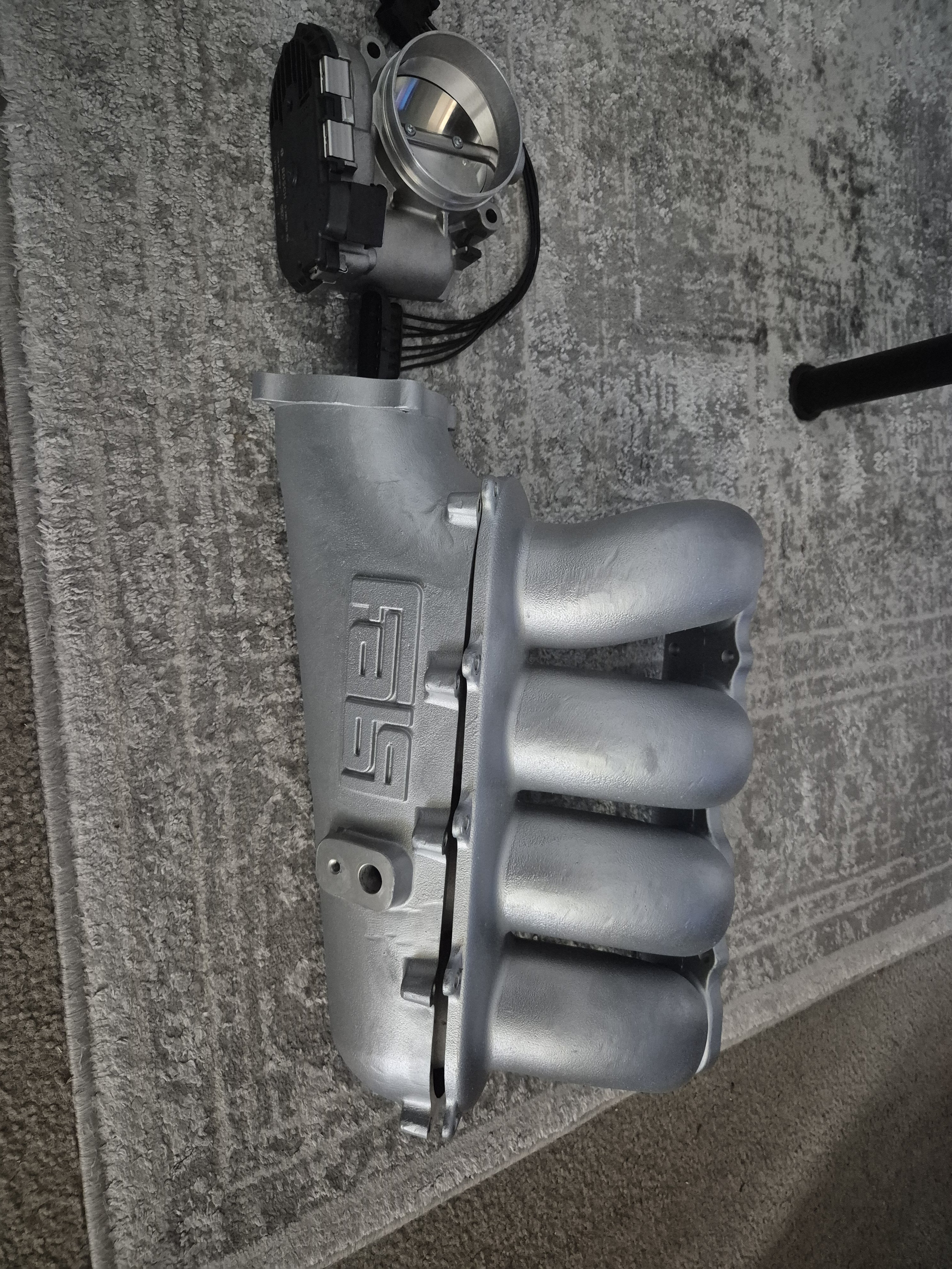

So, my intake arrived
I'm not happy with the coating finish so I went to Supercheap and got some black wrinkle paint and some prep stuff
I was initially thinking about using grey wrinkle paint, but finding a quality product that gives the texture I want was "unfindable...", so the tried and tested black wrinkle paint is again finding its way into the engine bay for the OEM look
I'll sneakily head into work and get the big ovens cranking to cure the paint over the next week or so
I've also contacted MX5 Mania today to talk about the install and tune, so painting it is my "main effort" prior to sending the car off
In other news, the correspondence from the US supplier is fair to midling to say the least, I'm still trying to track down the intake box thingie with the larger intake pipe to suit the throttle body, it still is "awaiting fulfilment" (no stock currently available), if it isn't here soon I'll just get MX5 Mania to fabricate up a CAI that is easy to service the air filter
  • Like 2
https://www.sau.com.au/forums/topic/486007-nc-mx5/page/11/#findComment-8001484
Final finish outcome of 80°c was typical to the pics, I've turned the oven down to 50°c and will pick them up after the gym tomorrow
The before and after difference was amazing, the wrinkle paint has covered all of the casting marks completely
It did take a couple of hours to key it all and get in all of the crevices, but, for me it was time well spent for the final outcome, but I have all the time in the world to do it at the moment
Ended up with 4 coats, each sprayed at different angles to get optimal coverage and thickness
As for the fixtures and intake box thingo that hasn't made it, the supplier is apparently posting the fixtures, and, are now sending a different CAI that is in stock
The replacement CAI is actually better than what I originally ordered, but will require a pod filter that locates under the front bar, still serviceable, but it basically removes the whole OEM filter box and ducts into the front bar, so filter cleaning will require ramps and the removal of some front bar undertray, not a war stopper, just some ramps and an additional 10 minutes work every few months
From looking at it it is made from alloy pipe from the throttle body, through the CAI hole in the rad support, then right turning under the bar, luckily the wrinkle paint was on special and I got 2 cans for $30ish, so the alloy will get the same wrinkle treatment as the intake manifold, hopefully it turns up soon, either way, the car will be getting booked in soon, if the parts aren't here, I'll just get MX5 Mania to " make it work"

The other trick I've found with wrinkle black is to put the can in hot water for a bit to warm the paint up, and to pre-heat whatever you're painting.
It'll be interesting to see if you pick up any power with the intake, following with interest.
Got a proper lsd for this?
  • Like 1
https://www.sau.com.au/forums/topic/486007-nc-mx5/page/11/#findComment-8001582
The spray cans were in the "Kiln" room whilst I was preping the parts,  so probably around 2 hours to get them warmed up, the kiln room has 3 small ovens running at 100°c, 3 medium sized ovens running 100°c, and the large one I used running at 80°c, the room itself was about 28°c, I also spent a bit of time taping up the parts in the room as well, and by the time I was done I would assume that the parts were around that 28°c
As for power, I expect a couple of Killerwasps up high would be achievable with the current mods, I'm still running the MZR 2.0 intake and throttle body, and there is a slight mismatch with the 2.0 intake (smaller) and 2.5 intake ports (larger) on the head, this intake is matched and specifically designed to fix this issue with the ports mismatch, the throttle body is also a couple of mm larger, OEM is 65mm, the Bosch is 68mm
In the end it will look "prettier" than the molded plastic thing that is the OEM MZR 2.0 intake
As for the LSD, it's the OEM Torsen which works fine for what I use the car for, plus, basically no maintenance apart from the occasional oil change
