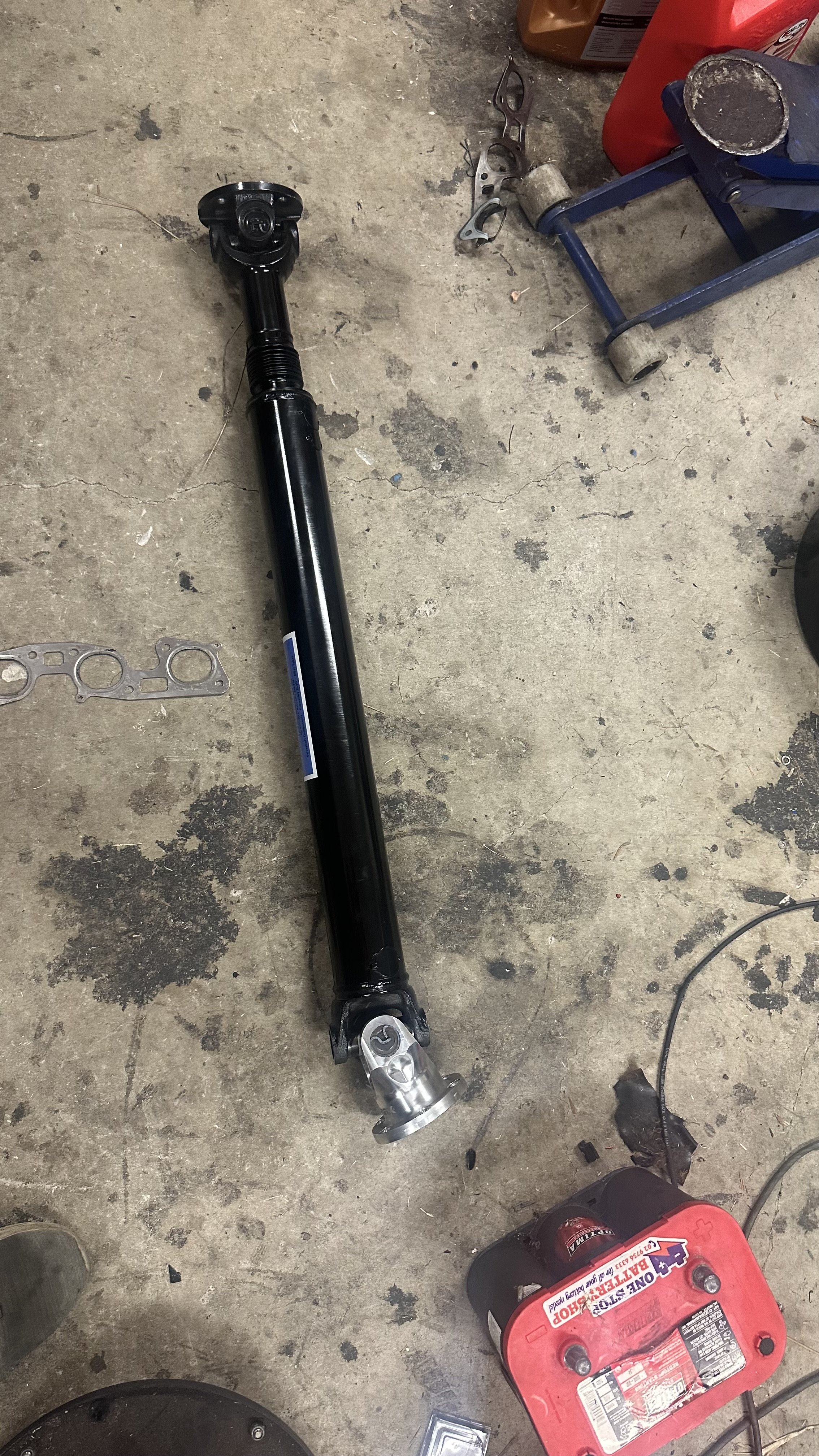

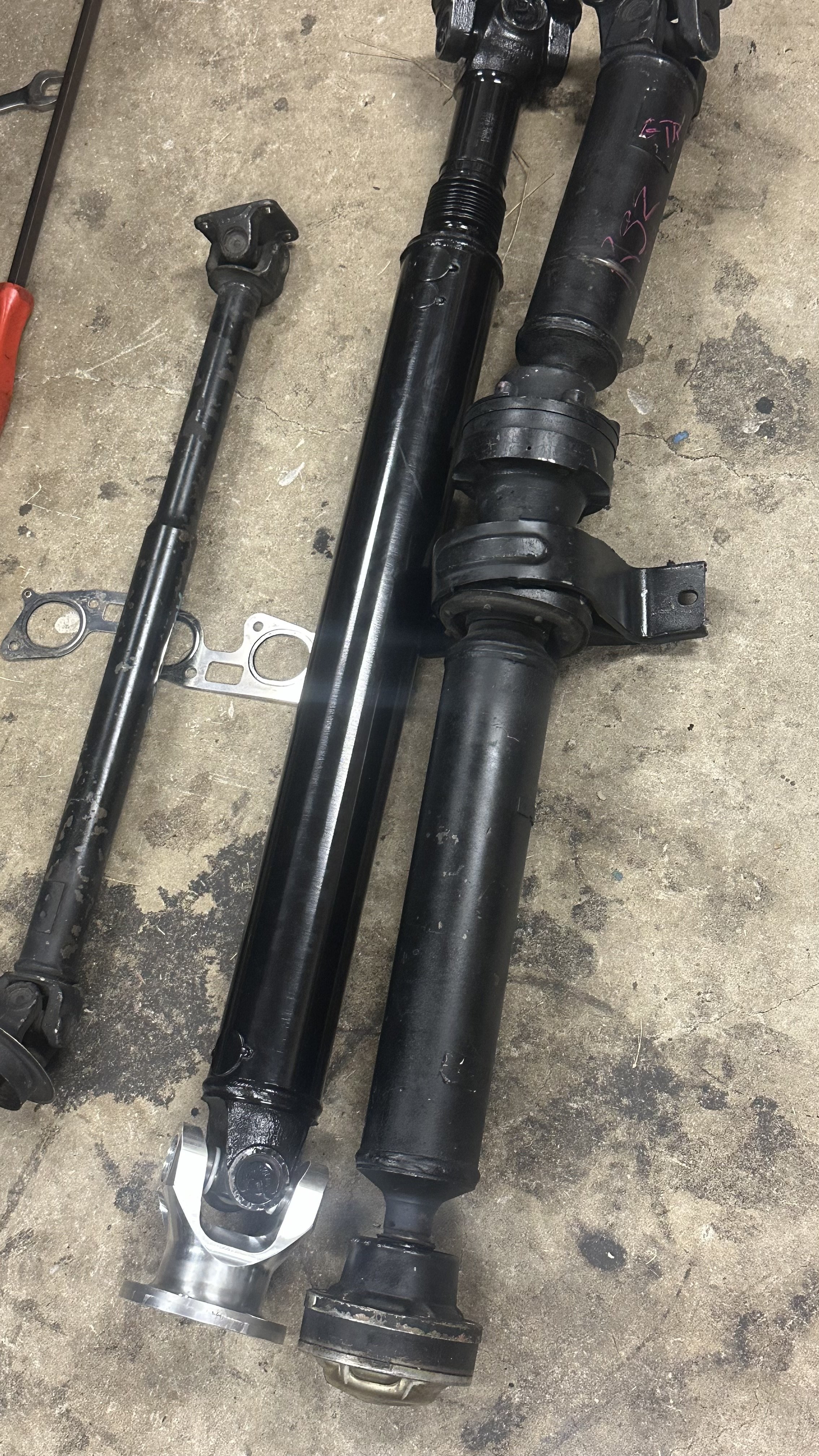

If you’re in Australia and need a one piece tail shaft give propeller shaft repairs in concord a call. They do all the big Sydney cars and they don’t vibrate at all
IMG_1502.thumb.jpeg.01caf81a380bbdc189ec0bc76400fb8c.jpegIMG_1505.thumb.jpeg.2eaa681657e7bf67c0fd0dbbcb4f5041.jpeg
don’t get one either cv joints, they bind and cause the vibrations

23 hours ago, r32-25t said:
The once piece tail shafts with cv type joints on either end are the ones that end up vibrating and the vibration is caused by the cv joint binding as it turns, I’ve also seen them explode from the binding
Alright I understand. The most likely case is probably gonna be that I just keep the OEM unit in the car as long as it works.
Are you referring to the common front u-joint + rear CV setup I see sold everywhere? I have a front + rear CV driveshaft on order but if this thing is going to bind I'm just going to leave it as shelf art.

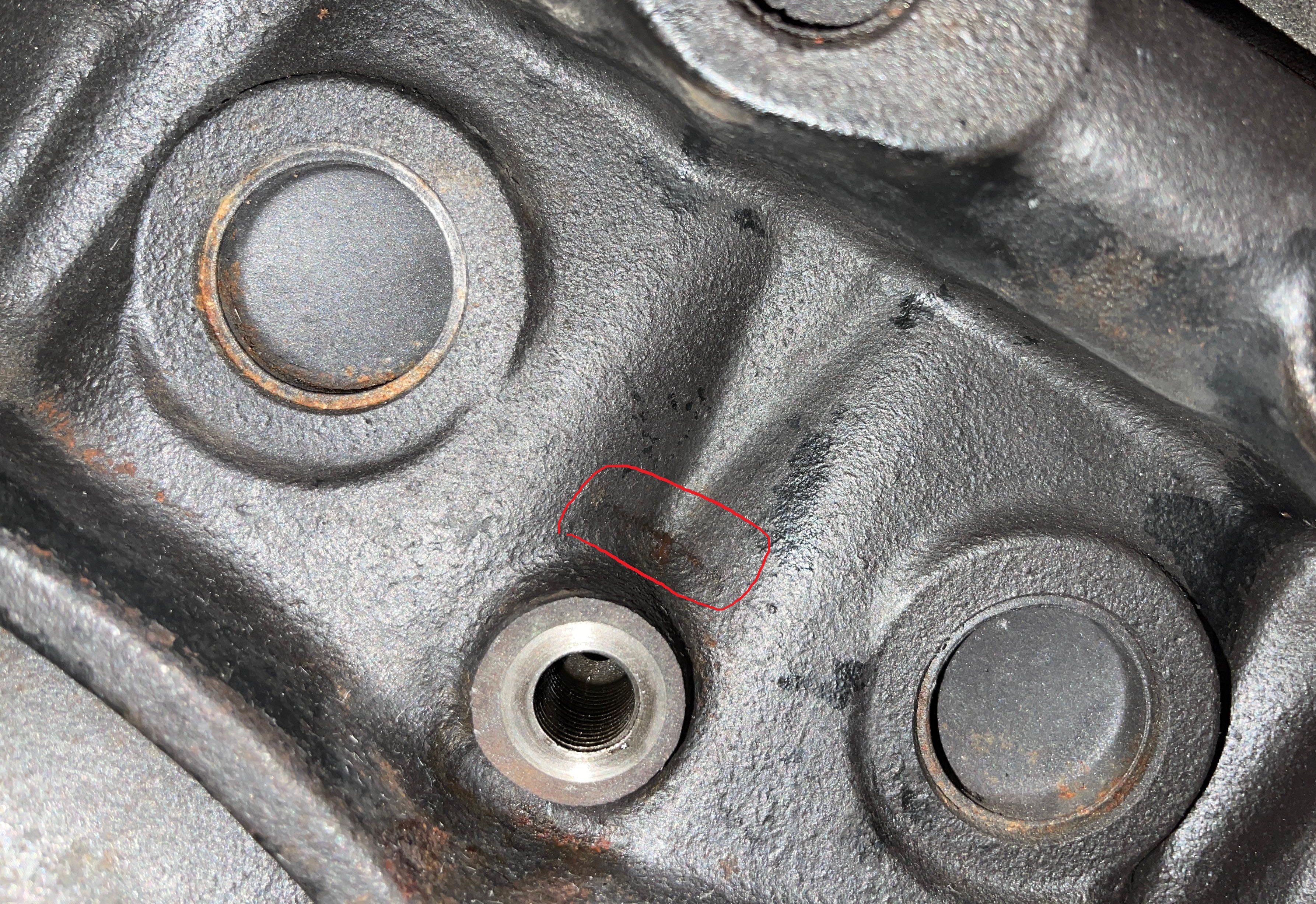

What you can see here (hopefully, despite shit resolution), circled in red, is a crack above the turbo oil feed. Extent is a few cm long and basically goes from #3 cylinder wall to #4 cylinder wall. It slowly lets coolant through, even without any pressure behind it. I am absolutely dumbfounded as to how this crack even formed, especially since it isn't along the cylinder as it usually is but rather a horizontal crack. Probably a few cm in length. Not sure on how to deal with this issue right now. Most likely, the only true fix is a new engine block, and even a relatively well done temporary fix requires at least a full engine teardown. Neither of those really fit my timetable right now, the car has been in my buddy's garage long enough as it is.
I'm open to suggestions, but I'll be looking into ordering a new 05U block soon so I have one ready for the coming year, or whenever the current block inevitably fails fully. (Most likely once the crack reaches one of the frost plugs)
I think it'd be a waste of money and time to rebuild the engine with this block.

That could be drilled, ground and welded. Would stop it progressing and leaking. But that block shouldn't be pushed very hard, as what you see there is a massive warning sign.
But that fix also isn't going to happen properly with the engine in the car, and assembled. So you're looking at anew block if you're doing all that work anyway.

New engine block time. Up to you whether you want to keep going down this road with this project. Unfortunately a lot of these cars are like this. The road to getting these cars into decent shape is long and not fun for reasons that you're discovering.
