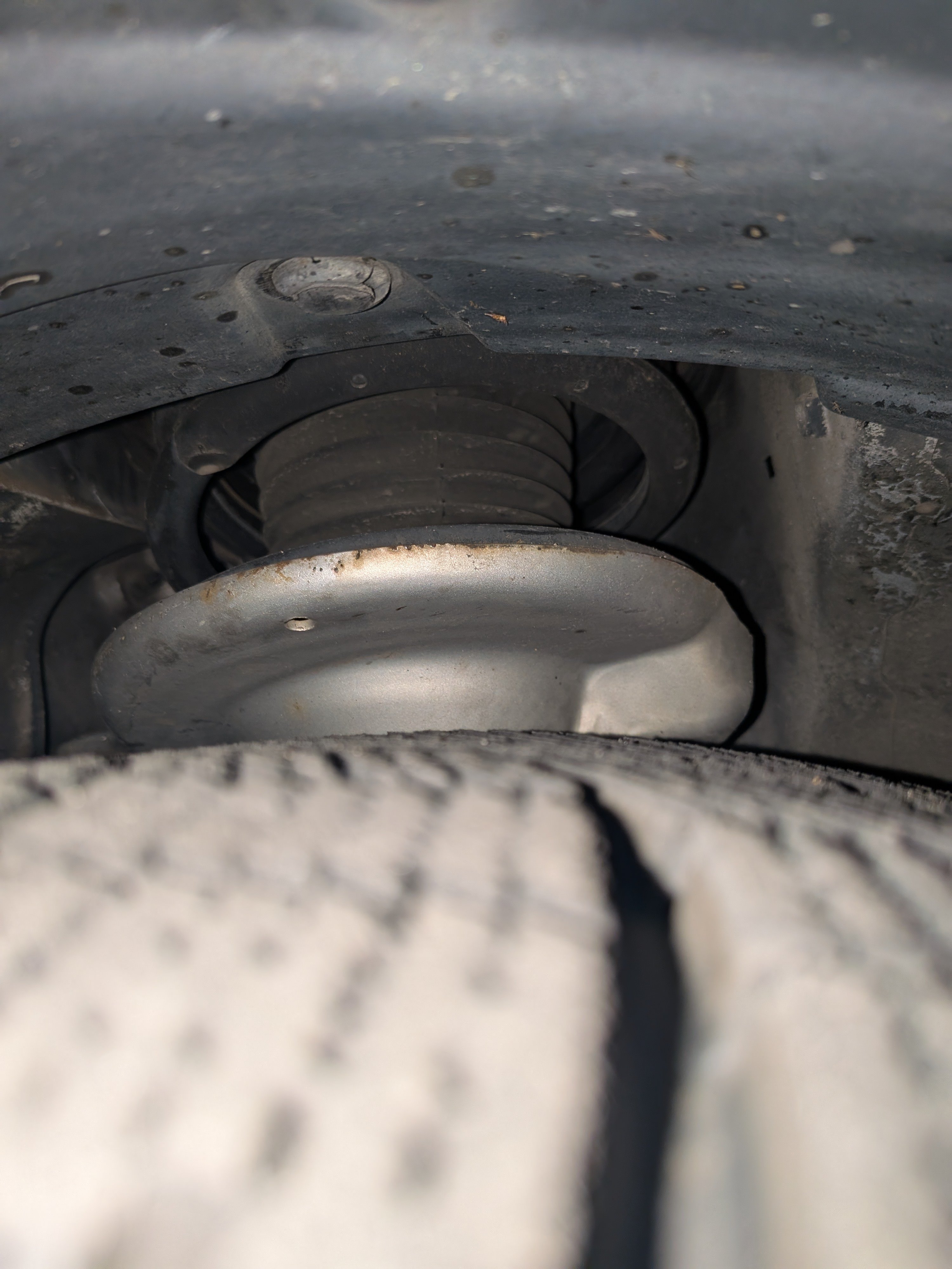

2 hours ago, GTSBoy said:
Judging by that spring perch and the normal looking spring on it - not a coilover. Well.... it is a coilover, just a stock format coilover, rather than what everyone calls a coilover.
