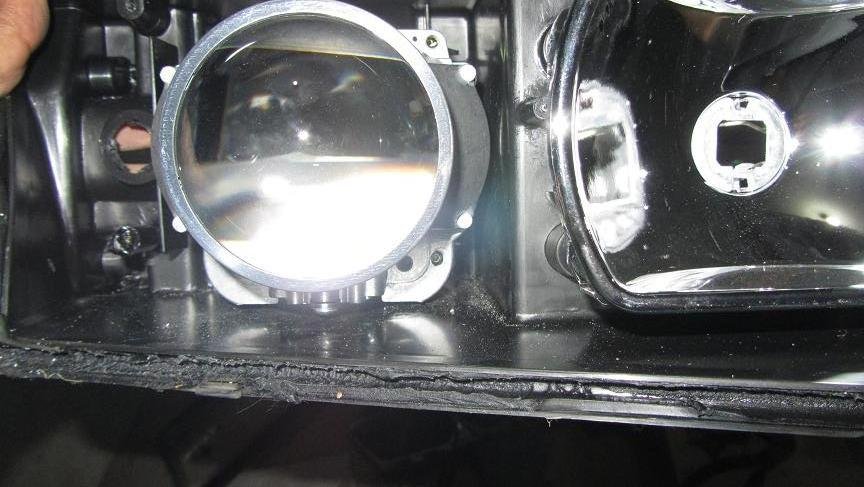

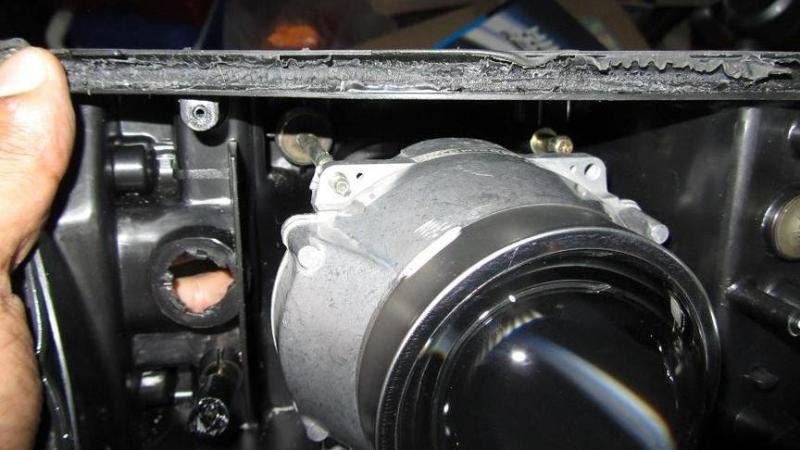

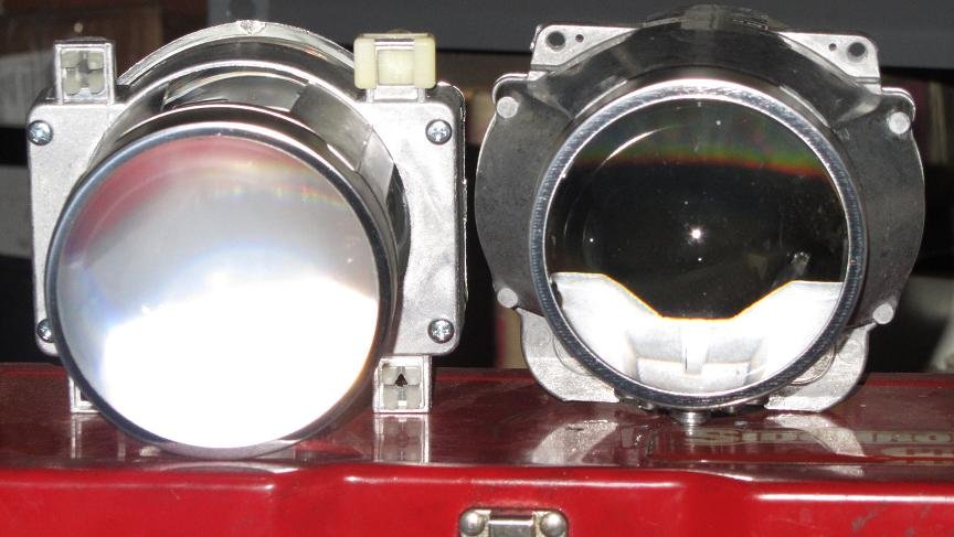

Started my retrofit today. Morimoto FX-R projectors are almost the same as R32 projectors. Tapped one corner and drilled the other, went straight onto the adjusters. Tap: 5mm dia 0.8mm pitch (M5x0.8). Need AMP to D2S straight adaptors, which I didn't order beforehand so my retrofit is on a hold :(.
So finished up at 3am lol started at 11:30pm

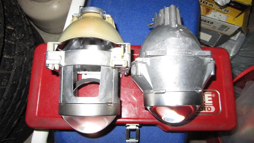

Standard R32 - Morimoto FX-R
Tap this existing hole with M5x0.8mm
Drill then tap the bottom right hole

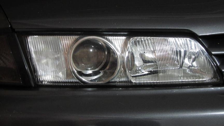

What you end up with
As you can see, the FX-R is a bit shorter than standard. You can make up a mounting plate to offset the difference, but the gap doesn't bother me.

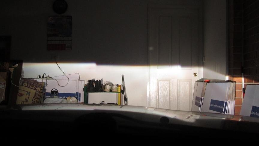

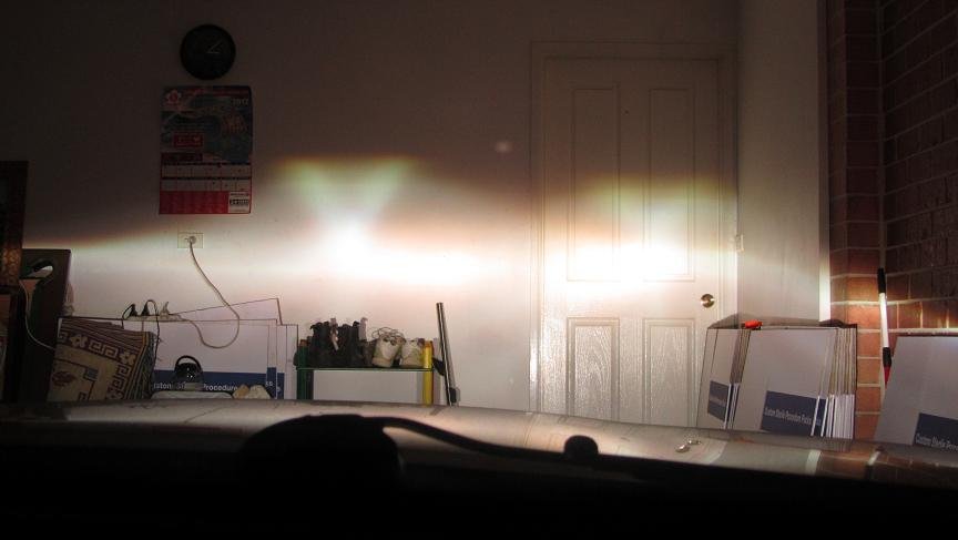

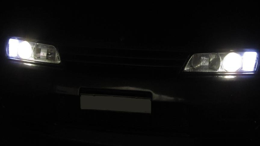

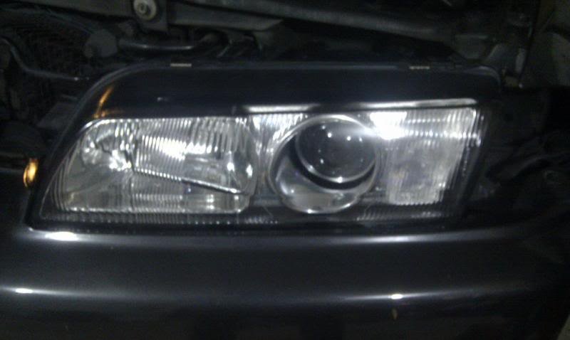

4300K cheap bulb and cheap LED parker. Note the parker is more than 6000K i.e. blue
Need to adjust it a bit more. The hole you drill will determine the angle of the beam as well. When I do another set I'll put more effort into where to drill the hole.

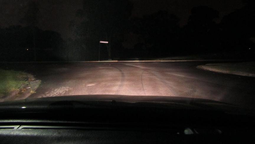

Crap picture, but they are so much more better than standard R32 projectors, as expected. Can actually see the road.
I'm going to put the fault with the bulbs for the uneven spread. High beam is awesome.

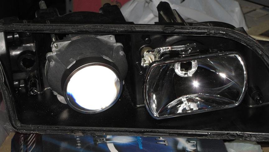

I've kept the standard halogen high beam so I can flash during the day. But when the shield drops, you can barely see the halogen. They are 85W, which I'm assuming is factory as both my projectors has them.

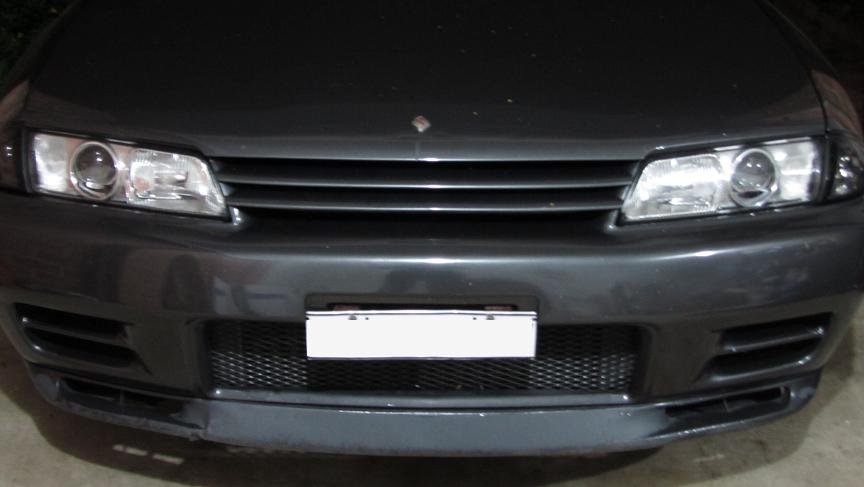

Here is a crappy pic of the second set I did. Painted the cover thing to make it look like R31 style :P
