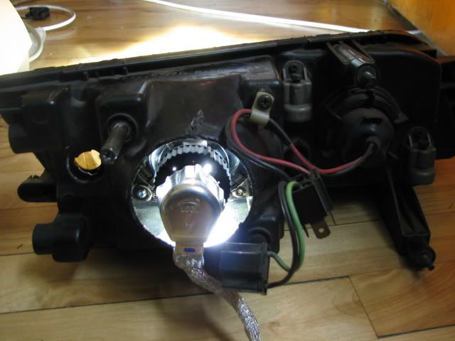

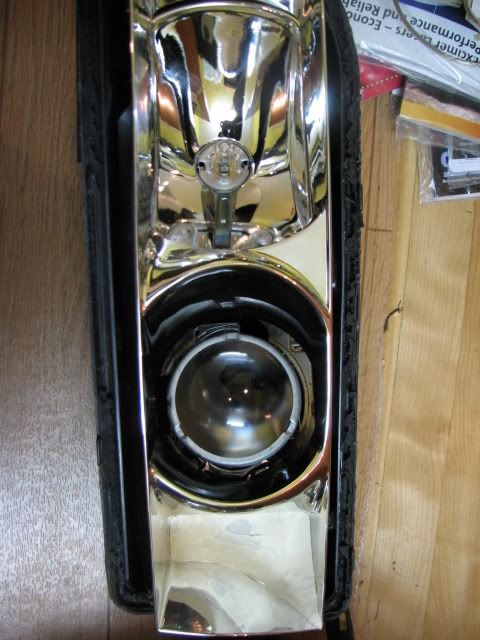

here are mine. Almost done with my e46 retro.

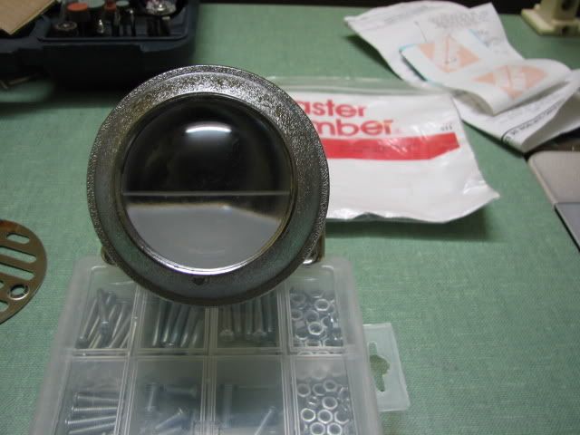

mounted with screw into the bracket

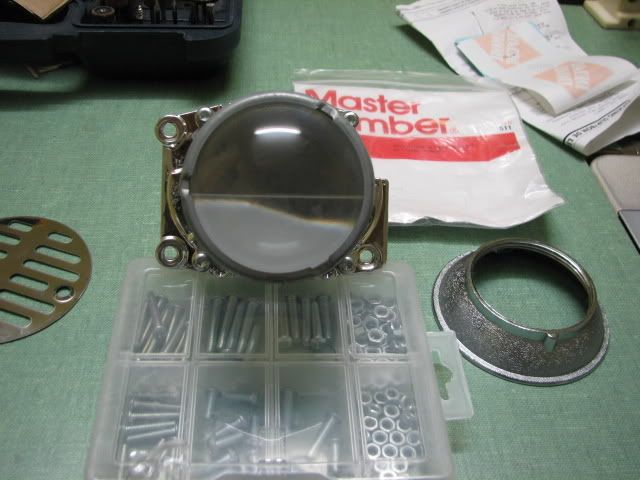

i will try to find a chrome bezel to put around the projector

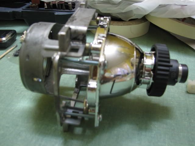

cutted the back to make the hole bigger

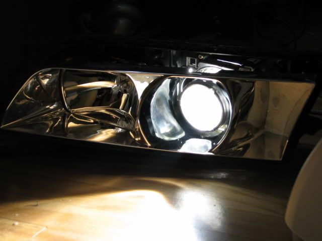

testing
nice cutoff

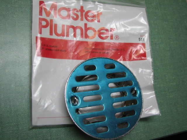

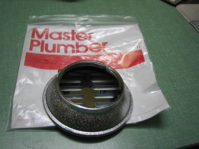

Found a chrome bezel at my local hardware store in the plumbing section.

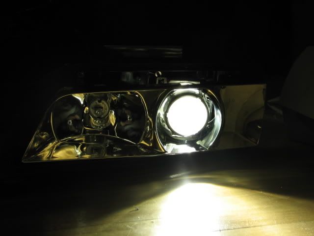

TADAM!!
I cannot believe that it fit perfectly.
Hidplanet are selling some custom made bezel for $43 usd /pair.
and these cost me $5 each
