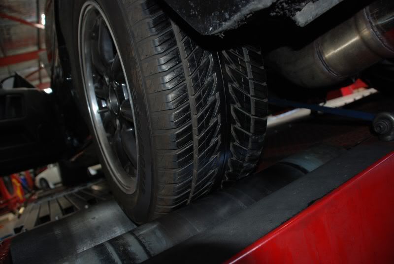

gt35 with 0.82 and everything you can think off to make it work
edit: sorry should add thats running 1.6bar, and massive wheel spin on the dyno to the point the tyres starting delaminating (http://i209.photobucket.com/albums/bb146/h...coupe/dyno3.jpg) so we had to stop (injectors at 100% duty cycle also). Tyres and lack of fuel meant we only moved the cams once before calling it quits.
Edited by DCIEVE
Yep using a 3582 as it came out of the box.
Should add the curve is a little misleading as the car would rev quickly to 6500 then hold there for a few seconds while the rollers caught up (with chunks of rubber spraying the wall), before revving out the last 1500rpm.
