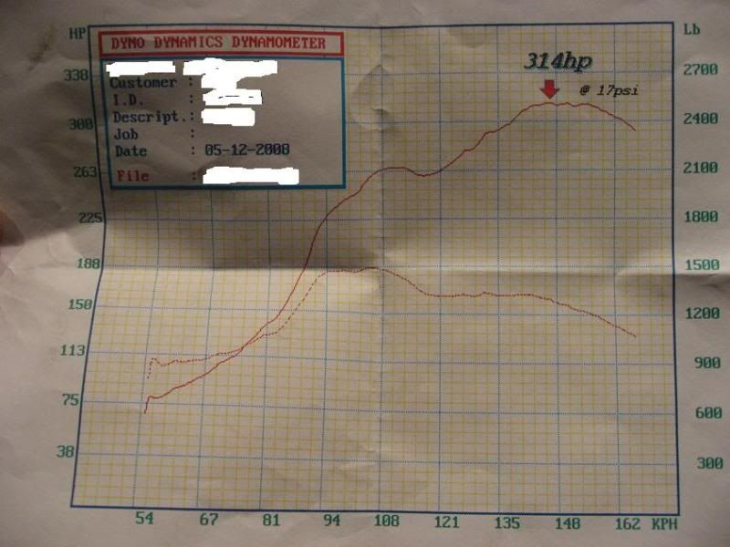

hey guys i been reading the 30 forums for a fair while and recently finished a throw together engine for abit of fun and see how the 30 performs compared to my old rb26.
I bought a stocker n/a bottom end from a mate for a carton and pulled it apart and ring gaps were shocking (like double the gap it should have), but bearings were pretty decent and motor had been rebuilt in 1998 so i just put it together. The rb26 head is a recond dead stocker with no porting or mods at all. I am using a 1.2mm hks metal gasket i had lying around as well. Comp test showed all cylinders are within 2psi and around the 150psi range so its pretty low comp ratio i reckon.
I threw on a brand new gt3076r 56t with the 0.8 v-band housing and a custom steam pipe manifold (used to be on Fatz old r31 actually) and a hks 50mm gate i had also lying around. Its got a 3" exhuast with a 3' used high flow cat and small centre muffler with internal diameter around 2.5' or so and a rear magnaflow 3.5' cannon (pretty much whole engine is using bits i had sitting around).
went to the dyno on friday and threw it on, ran great once we sorted a dead coil and idled smooth as silk >_< The tuner played around and did the offboost stuff and mentioned he had trouble keeping it off boost anything around the 2000rpm range it just wanted to scream on lol. We put boost on gate pressure (12psi or so) and it made around the 270hp range, then upped it to 17psi and managed 315rwhp (dyno is very low reading, on other dd dynos ive gained another 40hp or so, so its around the 345-350rwhp range).
We noticed it climbs real nice upto 5000rpm and then dips on the curve and then slowly goes back up to 6800rpm revlimit. When we added 2psi boost it would gain 30rwhp just under the 5000rpm area but by the peak power rpm it only gained 4hp.
any ideas on what it could be? afr's stay spot on through the rpm range and so does the boost so im thinking its the cat, or muffler or even the turbo is just too small and cant push much more up the top but the boost increase just pushes the midrange power up.
anyone seem something similiar with restrictive turbo/exhuast setups?
I was hoping for around the 360rwhp range on this dyno but it seems to have hit a brick wall and more boost is giving bugger all gains.

The 2.5" section isn't going to be helping at all but I don't see how it would recover and keep making power if it was a restriction..
My exhaust housing is my restriction and when that noses over, it does so rather hard and doesn't recover itself..
First step is probably cut out that centre muffler and replace with a piece of 3" pipe and see how it goes from there.
That's a pretty strange/poor graph; what yours is making in hp i'm making in kw. Even the curve itself is not what i would expect from the combination.
I personally would look at the exhaust system and remove anything smaller than 3", as this would definately have a -ve effect throughout the whole rev range, even replace the cat with a 3" pipe, just to test how restrictive that particular cat is.
With my previous rb25/HKS GTRS setup my old exhaust was causing the turbo to act like a big top mount; had sooo much lag then everything at a flick of a switch. Replaced the exhaust and cat and gained soo much low-mid range torque and power that the tune jumped into another load band on the ecu.

Exhaust is a simple thing to check, drop it from the end of the dump before the CAT.
That will easily tell you if thats the problem and will take 5mins.
Is the gate venting external or not?
Have a crack and post up how you go. (edit: i see your going to drop it, good-o)
The drop and then recover can occur with a restriction, where its recovering too is using less air vs what it should be @ that given RPM, much less.
Its well behind where it should be (at least another 40-50rwhp if not more), because if you arc from the 105km/h marker it should hit the 340-350hp mark @ 135km/h (where its only 300), and then noses over once again as its catching up right near the end...
Obviously thats only a very rough estimate, could go either way but that is what you'd very roughly expect once power is on - that the curve to keep climbing in a similar fashion till it flatens off a tad.
