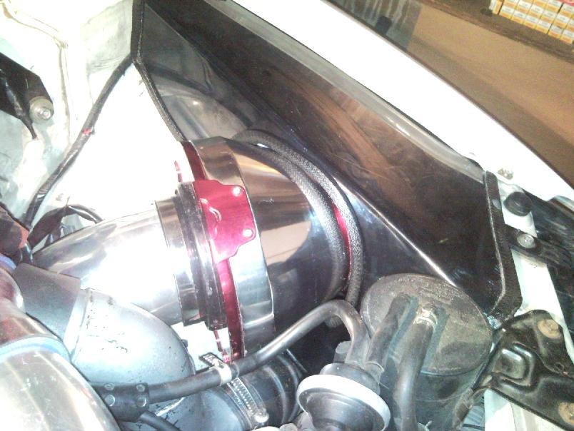

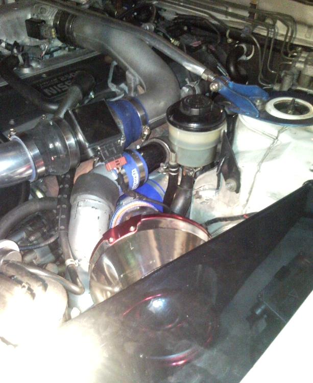

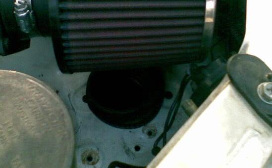

to be honest, with my cai and heatsheild, bigger the better for intake.
I see the point you make, but it was my understanding that your not trying to make it blast air into the turbo, which to be honest I can't see being much up until atleast 100kms/h at which point you legally cannot go much faster on our roads, as the turbo definitely has enough suction/boost to do that on its own. you are simply allowing the turbo to not suck in hot air from the engine bay, which can cause quite a large drop of response/power and instead have some nice <45degree air from outside, inwhich case, the more the merrier.
