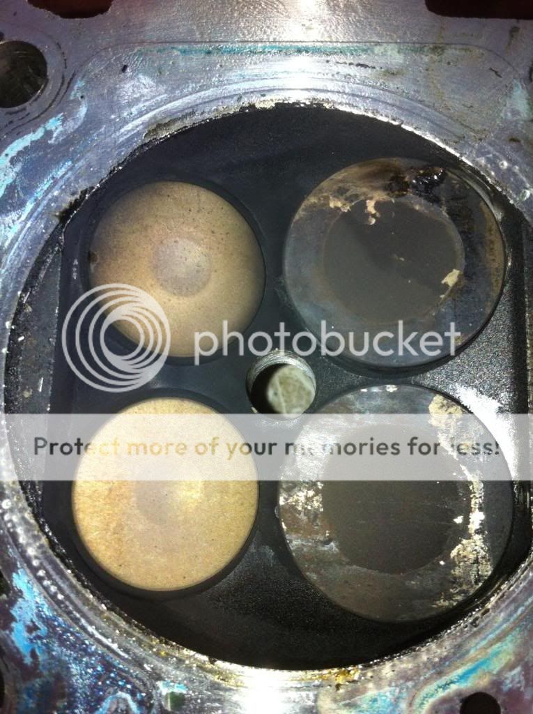

Engine is out and wouldn't turn over by hand or starter motor, head will be off this arvo do pics will be up this evening
ok so the head is off and dame they is heavy when u leave the intake on and trying to go up and over ARP studs,
and the news isnt good,

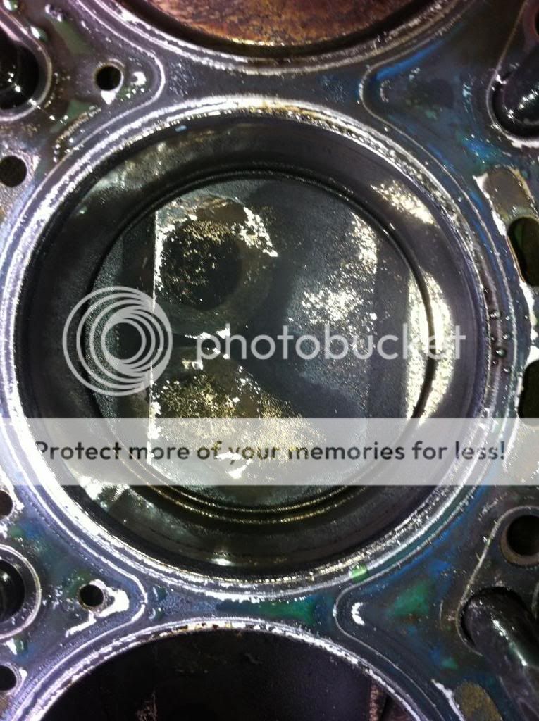

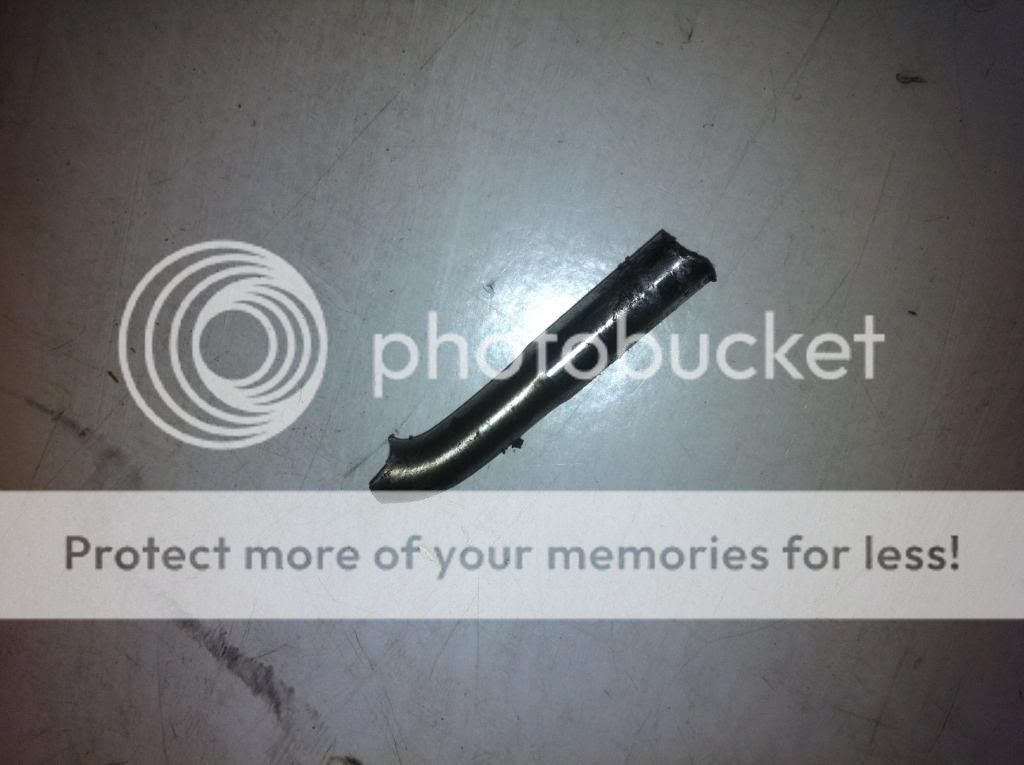

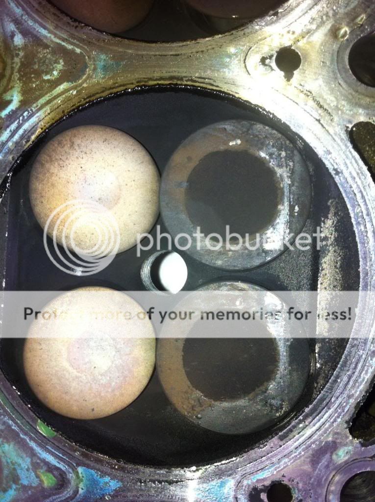

11 bent valves and 1 is now a limied edition 3 piece valve,
so clearly cam timing is to blame, its something i never considered, i now wish i could have checked cam timing before the belt came off, but i couldnt turn the engine over to get it all back to TDC any way,
it looks like all the intake valves have had a kiss with the piston and now are all sitting flat, and appear to be jammed against the head it self, hence why the lifters are sitting up againd the lobe, still able to rotate the exhaust cam and thats not fouling on the intake valves,
so hear are the pics,

if there is any positives, the bottom end is not siezed, yay

how is the bore of the cyl that dropped valve,i cant tell in pics that well is the R/H side of the bore scored of just lines from oil?
