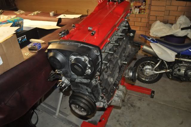

Oh dear. If you can't tell the difference between foot pounds and nm you're screwed. Id get someone else to assemble...
Also, there is a special tool that you use to file rings.
How the hell did you do it?
I thought you were actually starting to do well... until.
I wouldnt be sure of myself with a fresh built engine, Id get someone experienced to this stuff just so I know its done right, the money spent on engaging someones experience now will be money and worry saved in the long run...
How were you going to drive down to sydney area to get the car tuned, would that mean you would be driving it all that way untuned?
doesnt sound like a good idea to me...
I read the wrong side of the torque wrench. It was only the oil filter mount and thermostat housing anyway.
I'm getting it put on a dyno before I drive it to make sure the tune is safe for running it in. And I was going to hold the wastegate open for run in anyway.
Wat?
You need pressure in the cylinder to bed the rings.
I was thinking the same thing Wolverine, I admit I have made mistakes in the past but the less people that know them the better. lol.
When asking for help its good for you all to know what has happened up until now. I've got nothing to hide. I admit I made some mistakes but it's all a learning curve.
The only concern I have is that I may have a few dog hairs in my engine, I think everything else has worked out ok.
Trust me I will be doing minimal driving until its tuned properly. With a baby on the way I can't afford to do this again.
How long does it take to run in an engine on a dyno vs in the road. Liked if I get my tune checked, I might just go for a late night mountain drive. I'm thinking mt nebo and mt mee and mt cootha all in one night. That should get me my 200km before the first oil change.
Yeah I'm using the hypergear atr43 ss-1. Going to run 14psi or as low as possible if I can't get the low.
Ok kewl, il plug it and if there is an error il know why, this big earth terminal plate is driving me nuts too.
