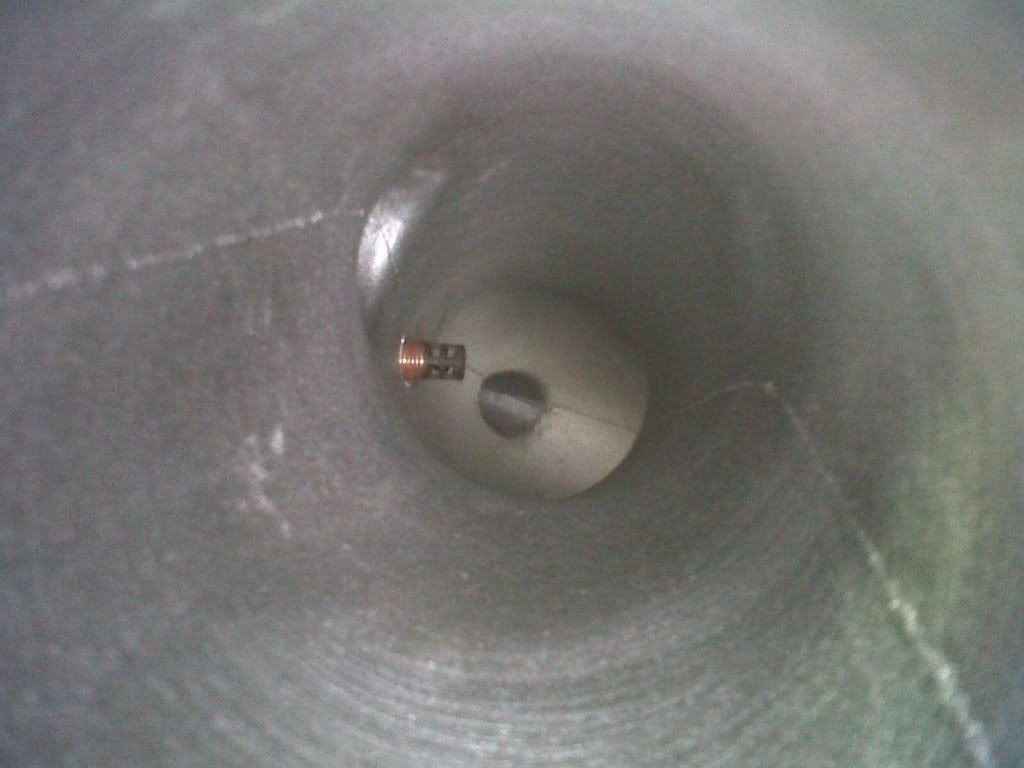

I havent really thought about how im going to seal the IAT sensor in there yet :/
The Bosch sensor has a little rubber o-ring on it so I figure I will drill a hole the exact same size as the sensor part, the rubber o-ring should hold it somewhat but I'm going to have to seal it in there with something else to ensure there is no chance of any leaking.

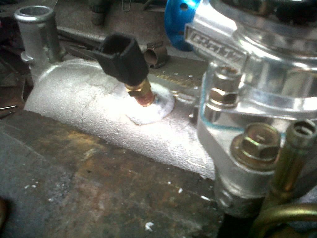

Strange i didnt realize the R34 G4 didnt have an onboard sensor. Mine for R33 def did.
RE- the IAT sensor, Link can supply them too, thats what i did. And just wire it into the AFM loom.
Also handy to wire in your boost conroller (i use the Link one also) to the solenoid loom.
Makes for FAR less f**king around under the dash wiring stuff in keeping your ECU loom pretty much intact.
This is my Link IAT. As far as i can tell, and remember, its just screwed in. No drama.
Reason I went with the open air (and difficult to fit) sensor was because of the info here:
http://www.linkecu.com/products/InstallationAccessories/Sensors/intakeairtempsensors
But if yours is working fine maybe I should get a closed / threaded sensor too so its easier to fit. They are cheap enough too.

The one shown above isnt a closed type, its open
