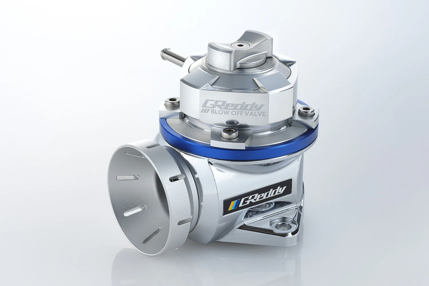

Yeah the hybrid you mean one of these? https://youtu.be/kL518ThmzSw?t=118
Yes that one that only vents is that i post above( GReddy FV2) right? That FV2 has some type of screw/valve where you can control how "hard" the spring would...but i think even on the hardest it would not be "good"...i would need to restrict this "more"...i consider this 🙂
And car should be ok(or rather same) with this like with no BoV?
Yes, that's a hybrid BOV.
The adjustable spring load ones are about making teh pressure build up higher before venting, so you get a more agressive whoosh. That is not what I meant or what you want.
By "restricting", I don't mean "keep it closed until the pressure is higher, then open it fully". I mean "open it as soon as it is required, but only have a small port area, so that the flow rate out of it is slowed down". The pressure will rise to be higher than a bigger ported BOV would provide, but it would do while it is venting. The idea is to slow down the rate at which the replacement eair is flowing past the AFM, to reduce the magnitude of the air flow signal peak, to reduce the amount of fuel that is added per revolution.

To the OP - I run that Greddy BOV (recirculated back into the intake pipe, not blowoff), as the stock R33 RB25 BOV did leak at around 19psi on a boost leak test. I haven't had any issues with the Greddy.

@GTSBoy yeah i know it was not the "great" idea but it is and option...but i think i will stay on no BoV rather then trying to make it work with "half" this and that.
But that GReddy FV2 is cool...i like that you can make it like stock if you want (and have/make the custom pipes)
